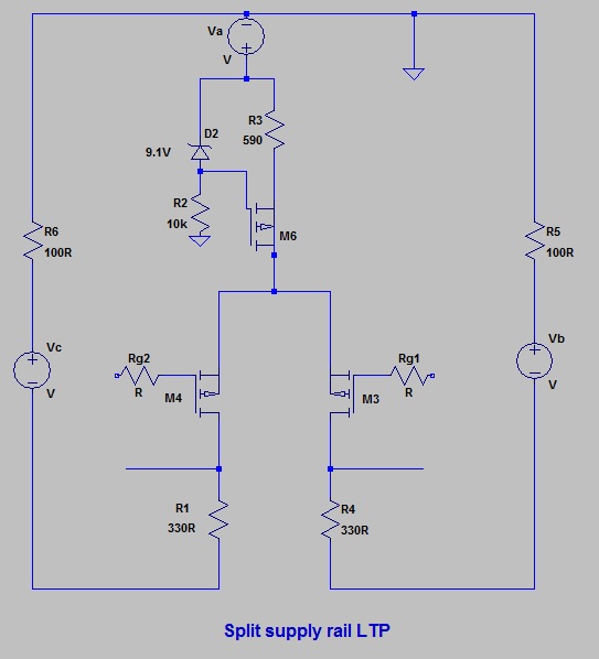

The next schematic demonstrates the idea - I built it and guess what ? It actually WORKED!!
So the cunning 😀 plan seemed to be falling in place
- the input LTP provides some amplification (half of what a single ended stage might since it was a LTP) and low-ish impedance to drive the output fets.
- the current through R1 and R4 multiplied by their resistance provides the necessary bias voltage
and we have done that with the separate or floating rails that the output stage needed. Plus ..
- by grounding the unused input, it would also do duty as a phase-splitter.

2+2 of J271 will work nice as input LTP
push as much as 7,5mA through each , having an eye on dissipation
10-12mA if cascoded to 12-15V
zm - agree thats a good idea... cascoded input jfets are very popular and may well be the ticket for ver 3.0. For now lets see what we can squeeze out of a simpler approach maybe ? Cake first - icing later if you want/need it

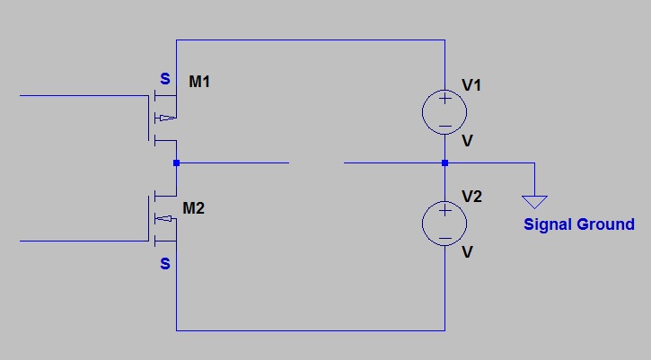

So far, we have seen that both the front-end and ouput stages are really similar to circuits that are already familiar and popular. Before we put the whole thing together though, we should take a closer look at one thing which is different in this circuit - the 'virtual' earth connection.
The amplifier needs a common signal reference in order to work - the outputs for example need to be compared against the inputs via feedback and to do this we need a common point to enable the comparisons to be made.
We call this the signal earth and in most typical amps, there is a common 0 volt rail that can be conveniently used for this purpose. We of course cannot, since there is no common points in the supply for the circ. So the two resistors are used to create one.
Take a look at the usual common source output stage that we are familiar with, attached below. The source pins of the output mosfets are at the same AC potential as the supply zero volt rail and this is our signal ground (we assume that the voltage rails are dead shorts at AC)
If you put a resistance between signal ground and the zero volt point, you start to 'float' the source pins a bit and if the resistances are big enough, the result is noise and hum.
Now take look at the schematic in post #18. Now trace back the source pins of the fets back to ground (again assuming the voltage supplies are AC shorts). Looks like there's a 100R resistance now in each of these paths. A big deal ? Well yes and no. To make sure that we don't get much noise injected to our amp- we want to keep this resistance low. But if we make it very low, the dissipation in them starts to become material. If we make it too high, dissipation porblems go away but we will have invited unwelcome noise into our otherwise quiet amplifier.
It turns out that the value is not too critical in the 100s of ohms and as we'll see later, if we use slightly highish values, the balance of the two resistors can be varied via a pot in order to tweak even-harmonics. Notably it accomplishes this task without upsetting the amps operating points or offset.

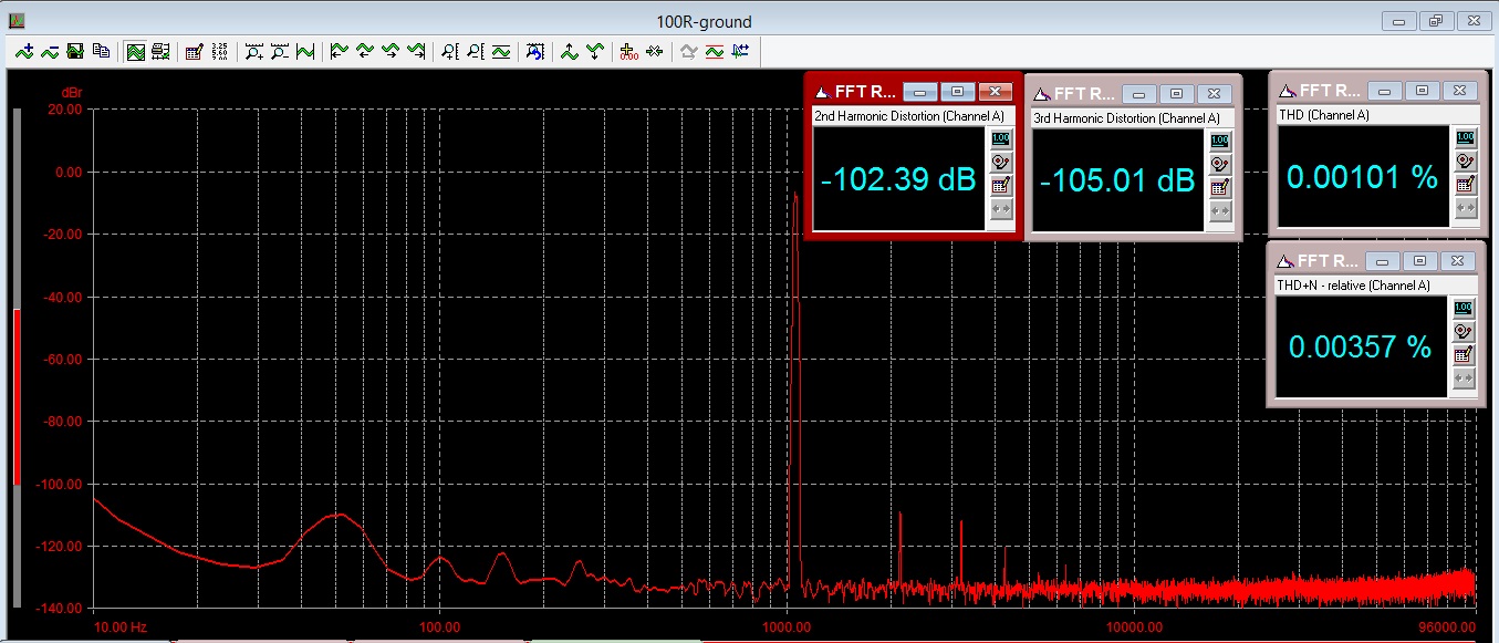

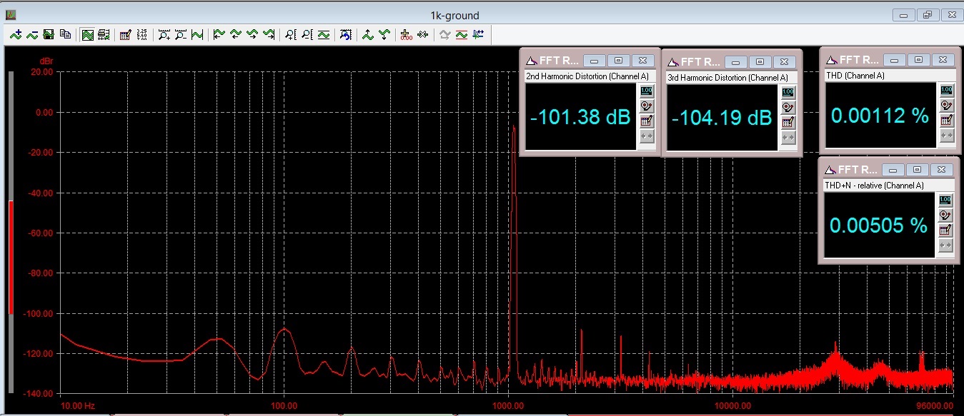

A quick note about the measurement system I use - its a Prism Audio Dscope III (yeah catchy name I know). See nawavguys blog NwAvGuy: Testing Methods for a roundup but basically its a (very slightly cheaper) alternative to the AP analyzers and comes with pretty nifty features for R&D type work. I like it a lot but still keep my AP Portable 1 DD and a Pana VP7723 for some measurements.
Anyway, the THD spectrum on the left is made using 100R resistors and the right shows the spectrum using 1k resistors.
Nothing too earth shattering here and as we speculated above - only the noise is affected. The distortion products are pretty much unaffected (H2 -102db, H3-105db) and THD is 0.001 in both cases. But the noise has gone up a bit with the higher resistors as shown by the increase in THD+N to 0.005%. In the second spectum, we can also see that noise and PSU harmonics are increased. Not by much but enough to notice on a scope. The power op was abt 2w into an 8R load for these measurements at an 80khz bw.

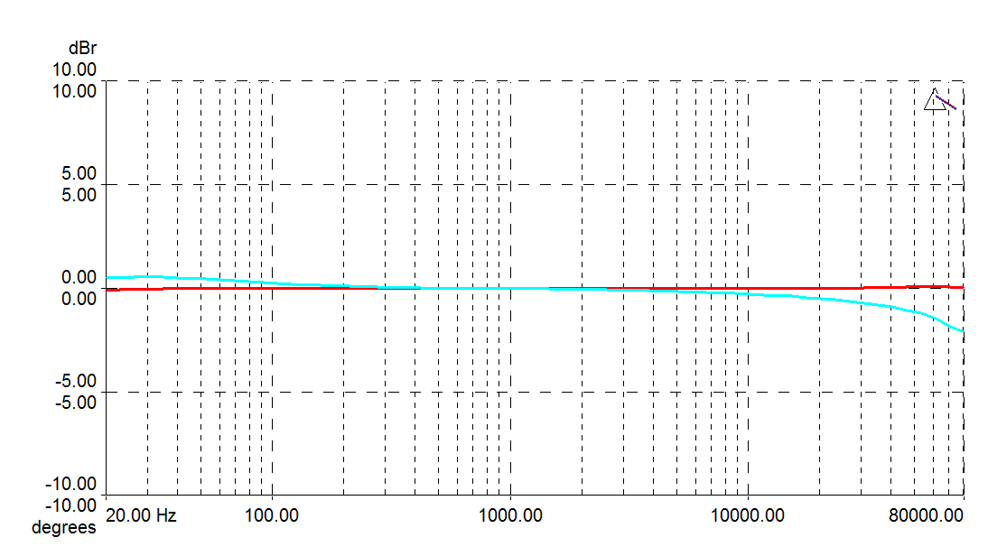

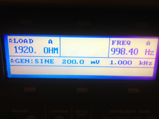

My Curves
The input impedance (bal i/p) is 1.9K
Freq Response pretty wide (flat to 80kHz)
Phase response also flat (-2.5 degrees at 80K)

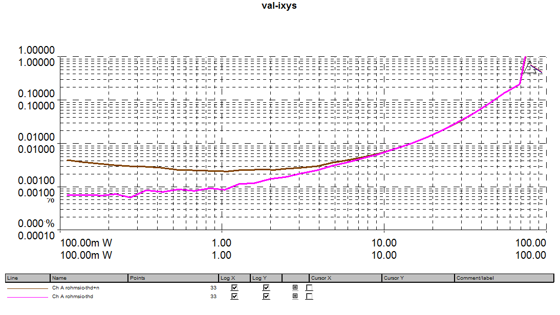

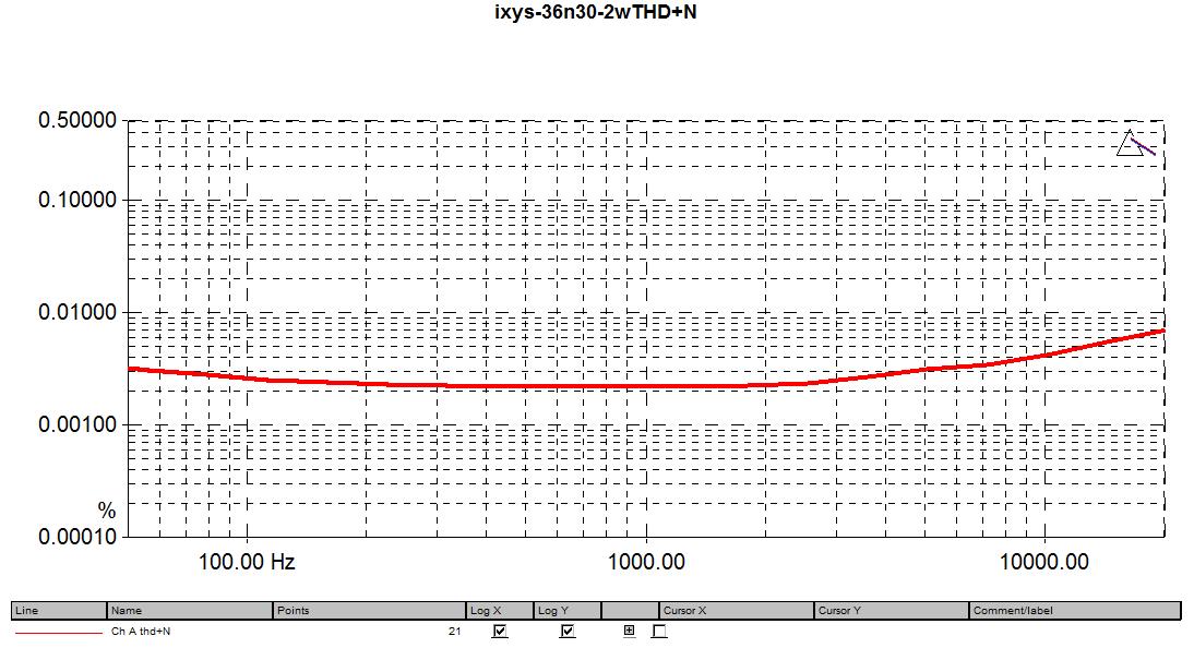

Power output graph shows both THD and THD+N. This is with 1.5A bias so the caps are giving us more class A than we would otherwise expect.
[just a note on this - some newer AP analyzers apparently strip out the noise at low levels]
1w THD is 0.009% THD+N 0.0025%. These are without any trimming btw.
THD+N vs freq is quite smooth.

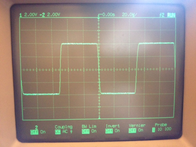

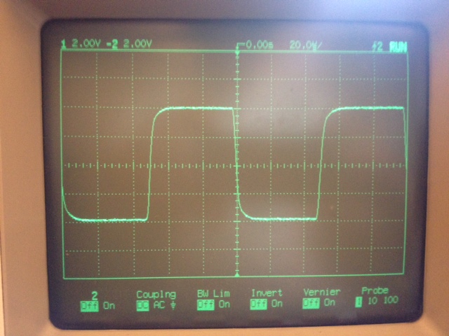

Square Waves
If you are an electrostat fan that you will LOVE these... no more excuses for ringing 🙂
10kHz into 8R load... and then same again but but with 3uF in parallel. I havent shown 1k - pretty boring looking.
It cannot hope to match the F5 at the 100khzs but there you are.
Haven't had to tweak compensation but then again there's not as much feedback (so no output inductor) as is used in many class AB amps. I have a few small pf caps handy in case they are needed when build it into a chassis but stability looks very good so they may be able to rest easy in the drawer 😀
sorry that should be 0.0009% apologies...
