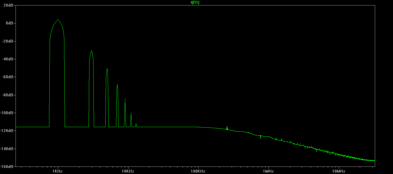

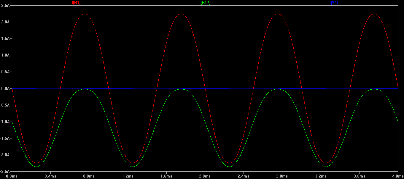

The first sim shows a degenerated op-stage biased at about 1A. The red trace is the current through the load and the green trace is the current through one of the fets. The red trace is showing peaks of 2.25A and at that point the green trace shows that one of the fets is almost shut down with 22mA flowing through it. Its hard calling how-low is zero but I'll just call 22mA as being low enough to zero without having to split picoamps.
This op stage peak current in class A is 2.25A and this is already a bit more than we were expecting with the 2*Iq formula. It just indicates that the 0.47R degeneration used is low enough to still show some sqr law benefits. So this stage gives us 20.25 watts in class A with 1 Amp of bias. In simland of course.

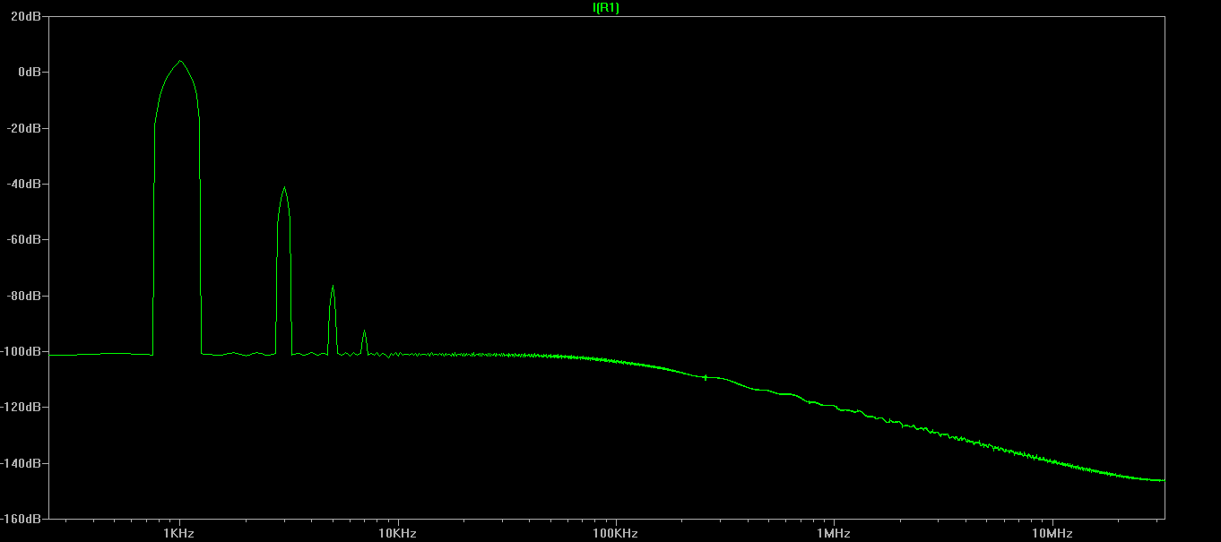

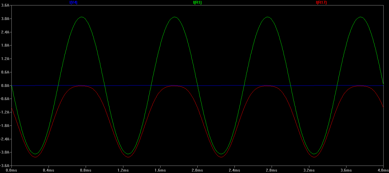

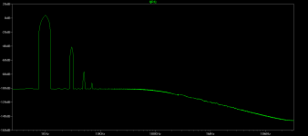

So what sort of improvement can we expect with no source degeneration? Here is the same op stage again at 1A bias. Now we find that the output stage can reach peaks of 3.1A before the other trace gets to the 22mA threshold we defined as shutdown above. So now we get 38.4 watts for the same 1A bias we used earlier. So that's a 89% improvement.....marvelous....
Which means that 100 watts is maybe do-able after all. If I drop the bias in my amp to 1A per fet for a total of 4A i'd get Class A operation of 64 watts with degeneration and somewhere between 115-120 watts with no degeneration. Perfect 😀

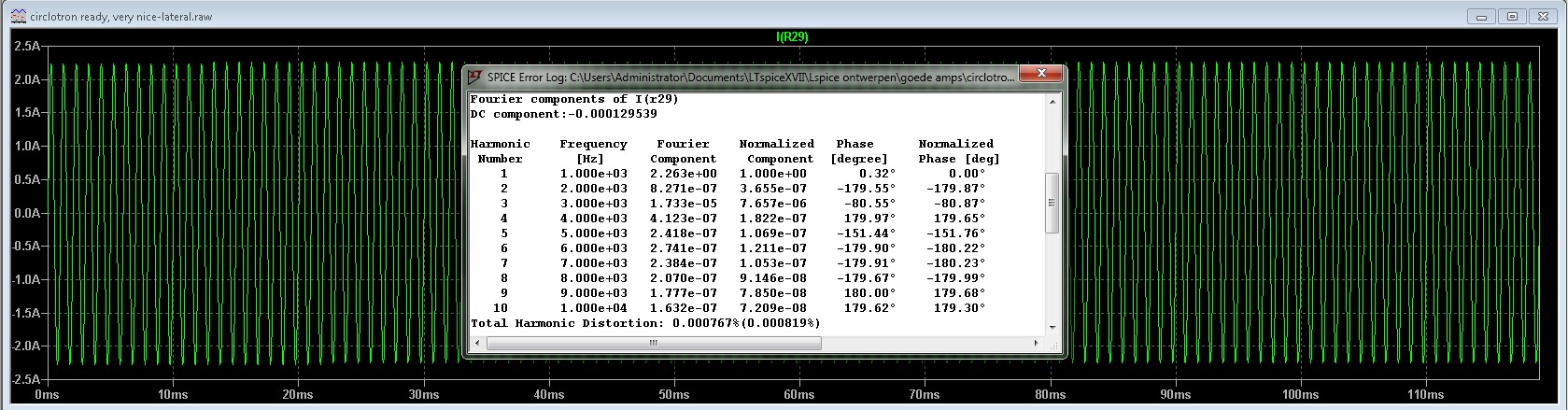

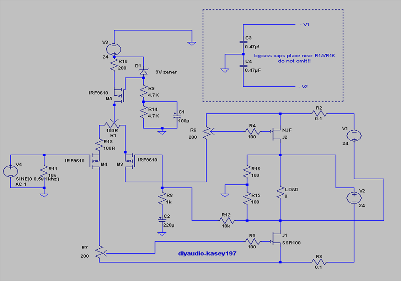

Good looking harmonic spectra. The main problem with caps across the source resistors in at low frequencies since Z = 1/(2*PI*f*C). If you are wanting Z<0R1 at 40Hz, this requires C=0.04 Farad, whih is a factor of about 3 greater than in your schematic of post #70. This suggests that the Valorious might be best accompanied with subwoofer driven by a class-D amp (or something appropriate for the subwoofer). If the crossover frequency was chosen to be 120Hz, that would provide Zmax=0R1 at 120Hz with C=2 x 0.0068F.
One would think so lhquam, but this looks like one of those thing we fret about a lot but that ends up not not mattering much in practice.
We can see *some* effects in the open loop gain plot but once the loop is closed the response is flat as a pancake down to 20Hz where i measured.
When you listen to the amp with/without the caps its pretty clear which one is the winner (well to me at least)!

the caps bypass the source resistor for AC. two main benefits (three for me coz i think it sounds better with the caps..)
i. about 80% more class A power for the same amount of bias with the cap bypass vs without caps. this is because we get more square law transfer function.
ii. eliminate locally generated harmonics caused by the local degeneration. (ok so these two are related..)

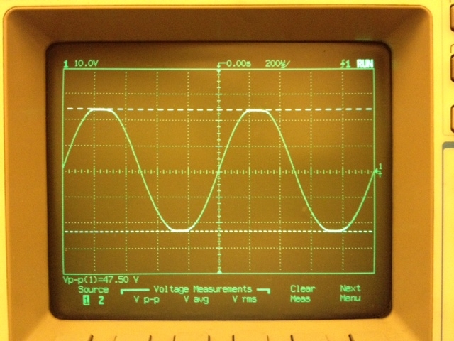

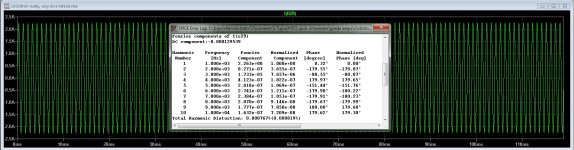

Nice tread, Kasey, your amplifier is indeed very simple, I was busy with help of Alex who is talented to get a autobias working, it is not that easy but the canceling effects of a circlotron do help a lot.
I have here the distorting of mine design, with class ab idle current, from 500 mA the verticals do nice.
regards
