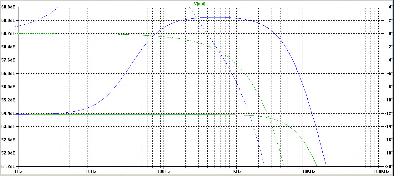

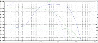

Below 200Hz the caps become less effective. Here is the openloop response for 2 fets per rail, with and without 2x6800uF caps.

Heh heh ... looks like a bit of a beast to tame 🙂 - this will be interesting I reckon.
Let me see what sort of fb/caps/no-caps combo I end up with 2 fets & similarly, folks wha are interested can follow along and share their experiences.
Thanks lhquam!
This is also a neat way of illustrating the choices that we, as designers and builders, have.
There is no 'magic' topology or anything in these choices but its nice if the decisions we make are deliberate, informed ones.
The graphs show the effect of more or less feedback. You can see this, for example, by looking at the rolloff point (say -1db roughly vs 1khz) of the bypassed vs unbypassed cases above.
The unbypassed case has lower gain but also you get a higher rolloff point. This sort of tradeoff looks familiar. So we realise that what we are seeing is no coincidence - it achieves this higher bandwidth through the action of localised feedback provided by degeneration.
Ultimately, the total amount of 'raw' gain you get is set by the devices, operating points and topology. Then you have to decide how much of this gain you will give up through local feedback (via degeneration) vs how much through loop feedback.
With complex topologies, stability issues often make the answer pre-ordained.
With a simple topology, we have some freedom to decide. Pretty cool to have some choices, I think.

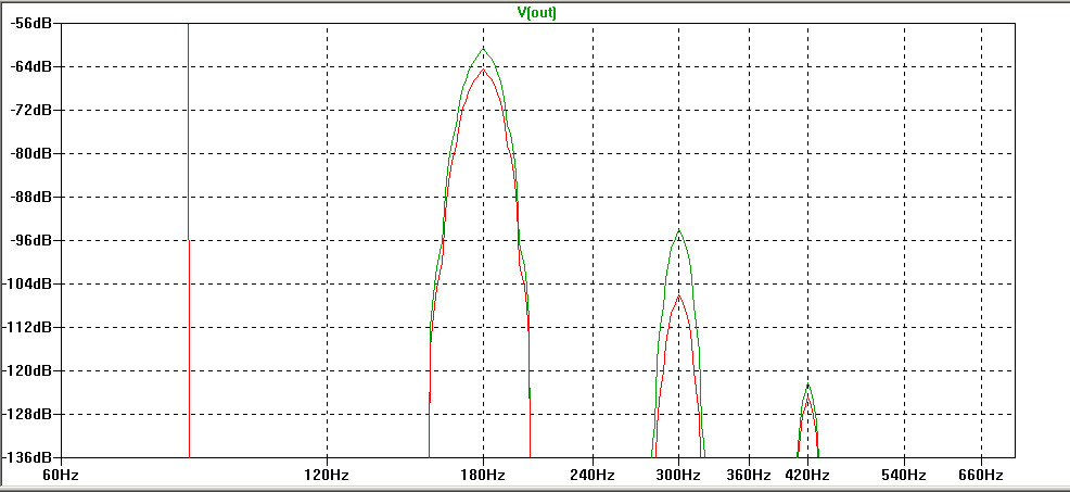

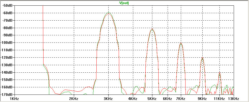

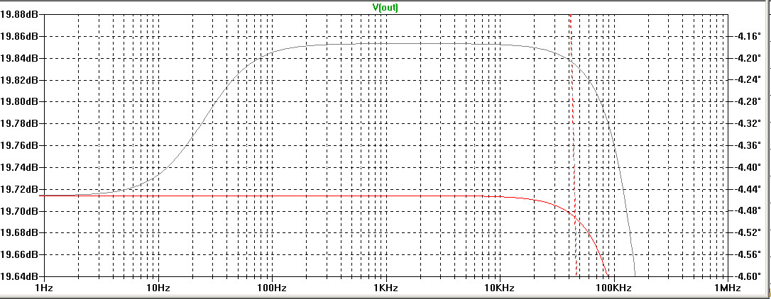

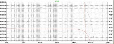

Here is the closed-loop response, with and without the caps. (R13=R14=12R, R20=500R). As you can see, the shape the curve with caps resembles to corresponding open-loop curve, but there is only a 0.14dB difference from the the curve without the caps.
Also shown is the harmonic distortion spectrum at 60Hz (middle) and 1kHz (right), 10 watts into 8 ohms, without (green) and with (red) caps. In the 60Hz spectrum, the caps decrease H3 by about 3dB and H5 by about 12dB. In the 1kHz spectrum, the caps decrease H2 by about 2dB and H3 by about 1dB.
I am a little surprised by the H2/H2 decrease with the caps at 60Hz where I would expect the caps to have less impact than at 1kHz. :scratch:

Hi lhquam - I'm not too sure re the relative results 1k vs 60hz.
But as a matter of interest,
the measured FFTs at 10w into 8 ohms show H3, H5 etc all 20db lower than the ones you posted above. Usually real world results are worse than sim not better. Maybe the reasons are due to different op devices in my design vs the sim above Or maybe due also to other changes in the sim - not too sure.
I have H2, H4 also (which the sim does not show) but we already discussed the reason earlier why this is the case.

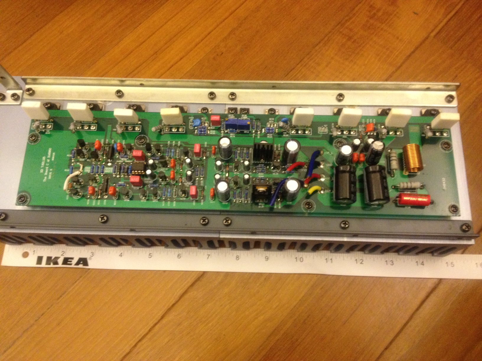

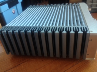

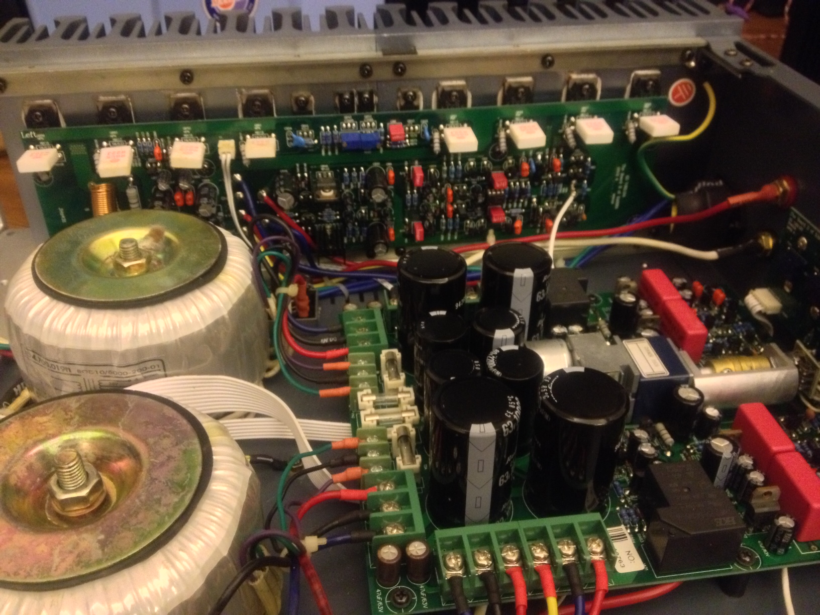

Aliens
Now its time to prepare the home for the new amplifier.
Here are some pictures .....
I promise she doesn't suspect a thing 🤐

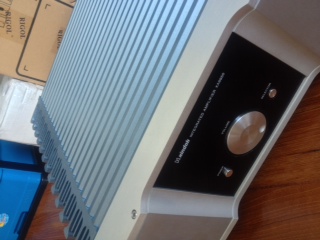

I bought her about 3 years ago when i first moved to Hong Kong. I bought them blind (ie un-auditioned) - reviews I saw were pretty good, and specs were :
FREQUENCY RESPONSE: 10Hz – 100Khz (+0, -3db)
TOTAL HARMONIC DISTORTION: <0.04%
S/N RATIO: >95db (A WEIGHTED)
POWER OUTPUT: 100W x 2 (8 Ohms)
Plus looking at the insides, it looked like quite a sophisticated piece of work. Class A, cfa type topology (claimed) and generally pushed all the buttons. Big heatsinks to boot. The cost (then) at $500 bucks was just too good a deal to pass up.
The listening experience was a little less than successful however.
After a few days of excited messing about, I just found myself disinterested in listening much. The details seemed all there but imaging was flat and one-dimensional. Some reviewers spoke of the smoothness - and I couldn't disagree but then again there may be too much of a good thing. I felt that the dynamics were pancaked and i had to keep turning it up to get things bopping along. When turned down to civilised listening volumes you got a feeling that transients were being truncated somehow so it was like the pizzazz without the zazz.😀
i cracked it out recently, listened again and found that it certainly didn't improve just ageing in the dark....
rush yeah the color certainly err a touch feminine maybe ?
But i have lots of respect for folks who do this for a living and put food on the table with their efforts. So no sniping from the aisles here. As you can see engineering and value is just unbelievable.
Even ignoring all the preamp and selector bits (servo controlled volume pot on a $500 amp - really ??) and casing - this is a really fancy dual differential design by the ooks of it. Each channel has like 20 small signal transistors, one audio grade opamp (socketed to facilitate tweaking), 6 to-220 drivers/vbe stage etc, and 8 output devices ! Phew .....
I wanted the case so too bad all this is going into magic "it-will-come-in-handy-someday" box - I say magic because nothing ever comes out again!

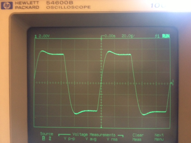

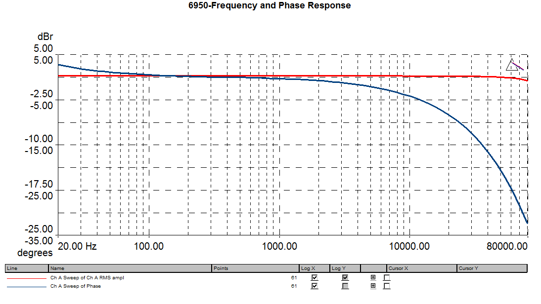

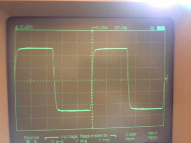

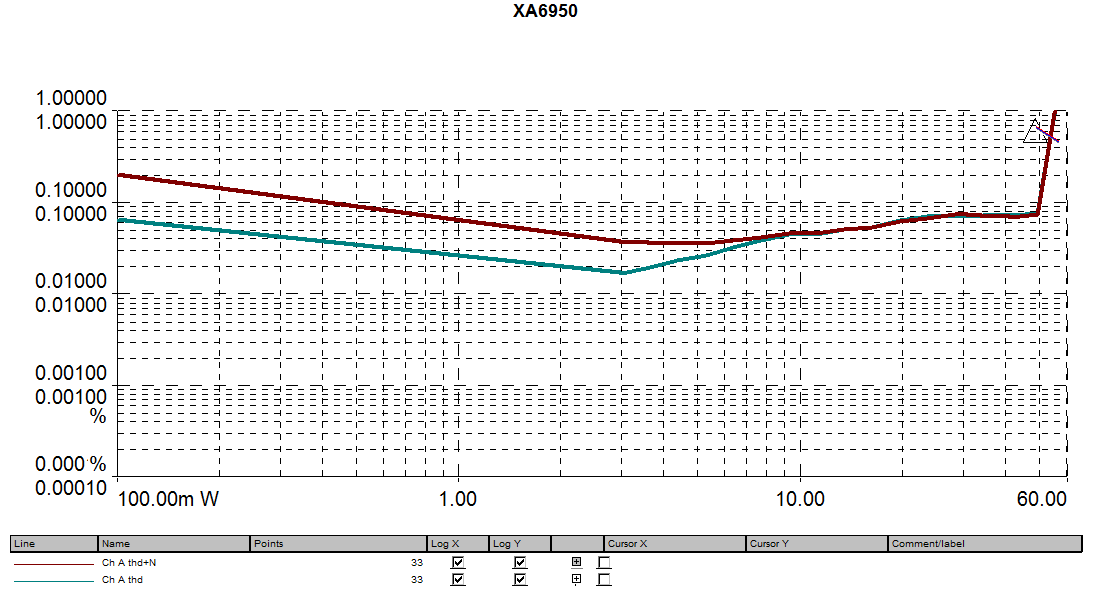

Before gutting the innards though, I also made some measurements with the Prism system. The results were a bit surprising tbh... or maybe not.
The one I have doesn't get anywhere close to the rated 100W. 10k square waves into 8R load and then with a 3uf cap also shown. Looks a bit odd given teh bandwidth.
I assume that the specs claimed are honest, so that must mean that i have a duff unit.
I guess every manufacturer has a few dud ones - if i had known enough to complain 3 years ago i may have had a better outcome.
Anyway no sense crying - maybe with some new bits she might do better......😱
