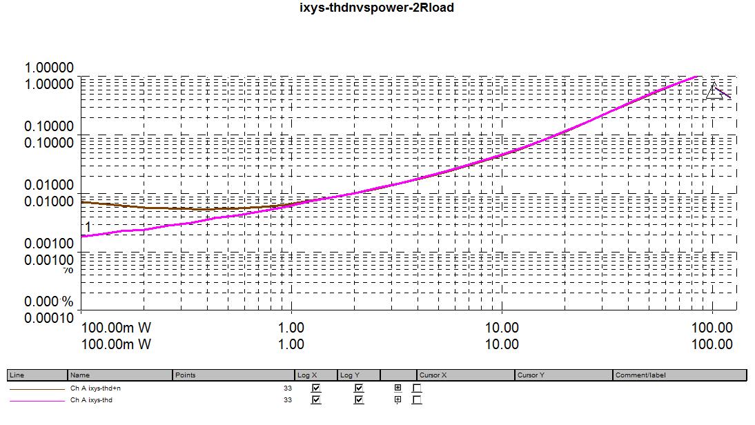

But, For us ESL people we need something that will handle impedance's down to 1 to 2 ohm range or so, What are your views on this?
The THD figures are very impressive for sure, But what happens to them is the impedance gets lower?

I think the loading due to the low impedance is certainly one issue but the more pernicious problem is that the ESL load looks capacitive to the amp. Many (not all not all!) ab amps don't seem to like this very much. I think it tends to screw around with their carefully compensated FB loops by introducing unwanted poles. VI limiters effects are also at play here according to this: Heavy Load: How Loudspeakers Torture Amplifiers | Stereophile.com (shows quite vividly how demanding ESLs can be.)
This amp will certainly have higher distortion figures at lower loads (almost all amps do) so maybe you want to parallel some output mosfets if that turns out to be a problem.
Otherwise I think this one will enjoy itself quite nicely with an ESL - for one thing its stableinto heavily capacitive loads. Well at least the prototype is 😀
Note that the square wave was made into a 3uF load paralleled with an 8R resistor. At 20khz - that cap itself has an impedance of less than 3 ohms....
thd+n into 2R
As requested here it is into a 2R load.
The lab PSU's are limited to ~3A each rail so measurements at higher W are probably wonky.
At lower powers looks about what I'd expect.
Will have to wait till final build for a better read on this. But yeah it works fine into low-r loads.

On a more serious note - think you'd be safer seeing off this sort of load with 2 outputs not one. Min. Or maybe a F4 style follower if that suits.
Edit: will try dual outputs and let you know e results once the single ops amp is completely baked.
