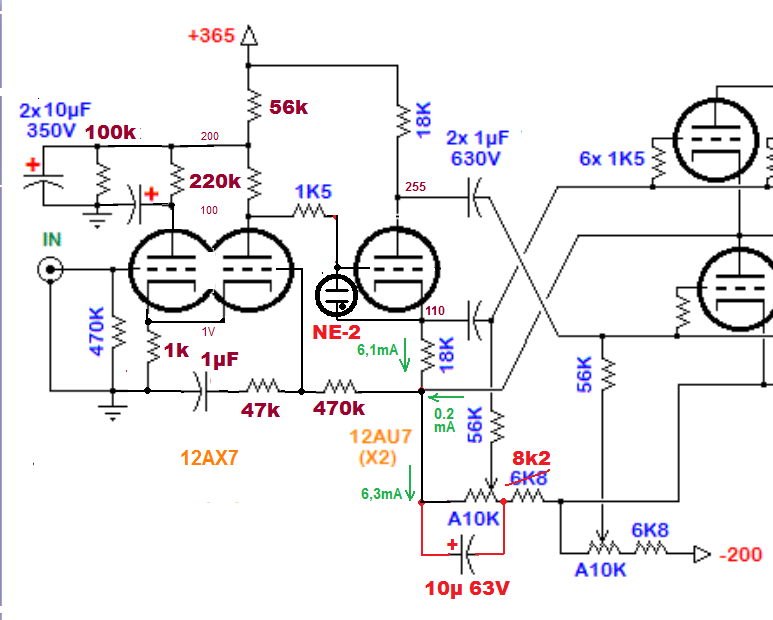

@Ketje : yes, I checked the voltage accross p-k of the 12AU7 at the powering : it reaches circa 350V. But the Ua0 of the ECC82 is 550V, so no danger for that tube IMHO.
I discovered from where comes that suspect deep bandwith drop :
1 - Rp increase from 100K to 220K
combined with :
2 - non decoupled Rk.
Here are the values (@-3dB, with ref. 440Hz sinus / 16R / 10.00V output) :
Rp=100K Rk=560R no Ck : BP =150KHz
same as above, plus Ck=470µF : BP = 220KHz
Rp = 220K Rk=1K5 no Ck : BP = 70KHz
Same as above, plus Ck=470µF : BP = 130KHz
I tested several 12AX7 tubes, and the results in sensivity, output power and bandwidth are very close. Finally and surprisingly, the best performance is obtained with the original circuit Rp=100K Rk=560R Ck=470µF. I'll try with an higher impedance source than my 600R generator output, for confirmation.
And yes, @Dimitris AR : no need of a protection relay here. I can power on and off my prototype with a speaker connected without noting any significative movement of the cone, if I do not use the SBY switch (which shorts the speaker output).
I have some other ideas for the preamp stage - and I'll look tomorrow more accurately to your last suggestion @Ketje, who knows ...

The voltage between grid and cathode is way to high at power up with cold tube.@Ketje : yes, I checked the voltage accross p-k of the 12AU7 at the powering : it reaches circa 350V. But the Ua0 of the ECC82 is 550V, so no danger for that tube IMHO.
Vgk is max 150V for the 12AU7.A small Ne bulb will prevent a high voltage, it ignites at ~70V.Ones the tube heats up the voltage drops to only 10V and the Ne is out of the circuit.
Since the starting high voltage is with positive grid and later on the grid gets negative, a diode can also be used but has more capacitance.
And a bulb looks nicer in a tube amp
Mona

If you insist on having the speakers connected continuously to the amplifier then your speakers may have a problem when you turn on the amp , it may be correct that the impedance of the speakers will minimize the voltage of the tubes during start up , but don't forget that in the schematic we have parallel 6080 tubes , which mean low output impedance an high current so I suggest not to do that .
In case you put a delay relay then all the output voltage ( during start up )will appear in the input of the12ax7 because you don't have a DC path to ground only AC , I hope now you understand what I mean !! . In general I would say that the whole design of the input stage is wrong , very low gain and high distortions .
