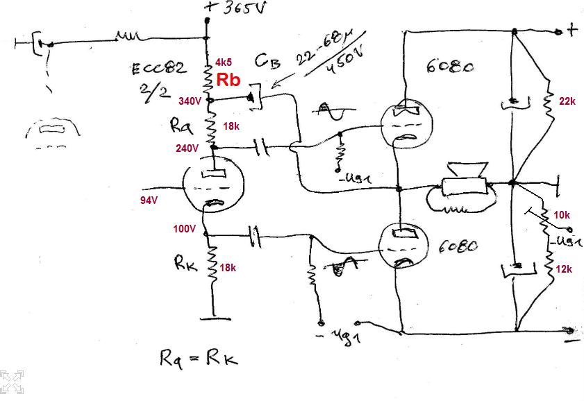

With the banat circuit you abandoned the cross coupling drive but by inverting the reference points it comes out the same.
If I fill in the resistor values like you had them before it gets like this.

With this p.inverter configuration input VAS stage output can be inverted type , so this will allow to use single high gain AF pentode for VAS stage same is in original Futterman amp , 6AU6 ,EF86,EF94,... altogether with high GNFB to reduce amp output Z to minimum ,
high gain triode input VAS stage(ECC83) can be also used here but than with moderate GNFB .
try with from 4K7 to 10 K ,
the lower Rb the higher Cb have to be ,
but let`s say Rb=8K2 with Cb=47uF .
Thanks @banat - I see.
Well, I must confess that I'm not very fond of that 47µF if I think about a polypropylene one, even if the voltage can be reduced to 250V : it's rather a big unit and the space is counted in my compact chassis... :eek::
It's worth to test to see the result - I think an Hi-Fi Freak long-time pal is testing that solution in the meantime too, with a non-crossed Cathodyne output though. I'll call him back to know further about that.
I will probably have to de-cross my Cathodyne output to apply that recipe, with the inconvenience of loosing a linearity correction equivalent to a 6dB NFB loop due to the crossing, as shown below :
That said, the de-crossing will allow the installation of a NFB loop that would be impossible with crossing, unless you want a positive reaction that increase input sensivity but is detrimental to the linearity and bandwidth.
But if you de-cross and install a NFB loop, then its level must be over to 6dB to provide any advantage on the cross solution, with moreover an added loss of input sensivity of 30% (even if it's not so dramatical, though).
These are the conclusions I draw from my measurements of this morning.
The time to make choices and arbitrations is coming... ;)
So Wait and See... :)
A+!

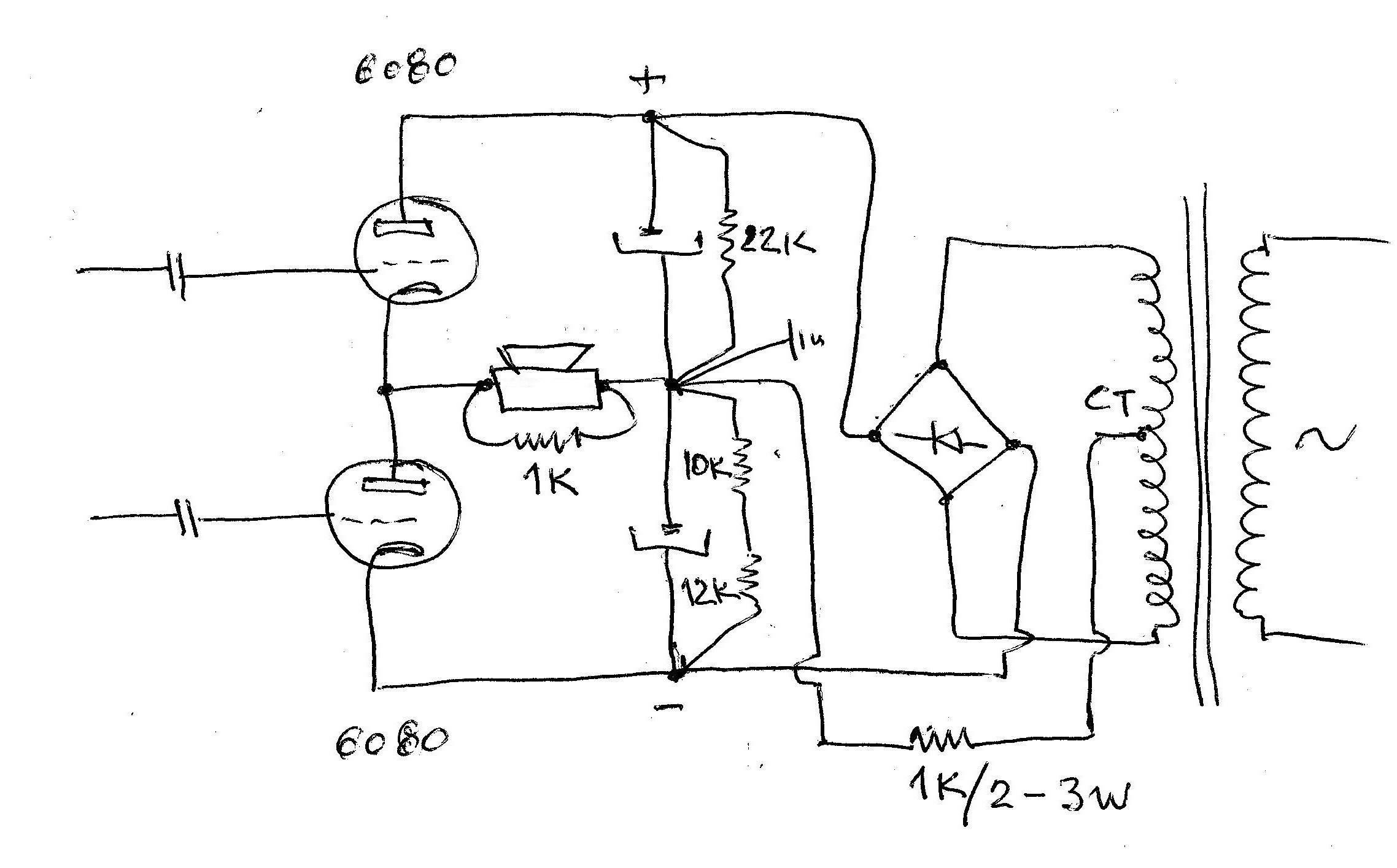

No need for big polypropylene on Cb , ordinary but quality 450VDC rating electrolytic condenser will be OK , what is important is to find optimum Cb value by listening experiment,
if Cb value is to big than Bass spectrum will sound bloated , if Cb is to small bass spectrum will be insufficient ,
one more thing , to get stiffer and better defined gnd floating reference 0 point is good to insert one 1K/2-3W from power transformer CT to speaker (-) floating 0 reference point .

Good idea, Guys, but my PSU has no transformer CT, so current imbalance is not really possible, or at least very limited to the 12K shunt resistors :D
I installed 3 sets of 6080 right out of the box without any control, plus some used ones, and made tube mixes : the imbalance is 115V +/-3V at max. :cool:
