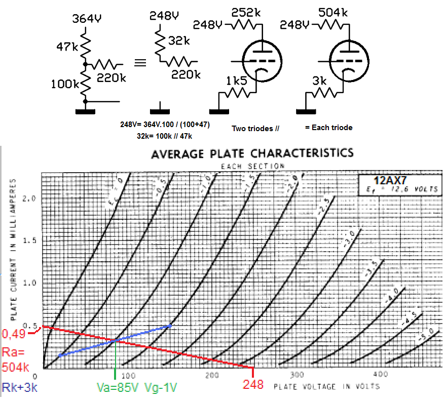

I think it is the infuence of changing Rk on the current in the ECC82 (caused by the DC-coupling) that makes the difference.With 2k7 the ECC82 is somewhat over 6mA and with 1k5 only 4,5mA.To balance that current the bias resistor has to be adapted.Verdict : the best result is offered with Rk=1K5 and Rp=220K, and not 2K2 or 2K7. The linearity is slightly improved (not easy to see) versus the original circuit, and moreover the input headroom is increased by the higher Rk value. No signal change (in or out) occurs.
The problem with DC coupling, everything changes everything.
Yes, makes only very little change.The ΔVout being much smaller then Δ-Vg.It's more cosmetic.2 - Moving the -H bias pot return from GND to SPKR output line, decoupling the pot with a 100µF capacitor :

Another thing, as I said before, your 12AX7 seems to be rather week.
Look what you shoud get, only 85V on the anode.
Mona
I checked a plate current on each triode a 1.1mA for a datasheet spec at 1.2mA @-2V : IMHO, such a tube can't be qualified as weak... Right ?
But OK : I will test with another ECC83 at exactly 1.2mA or more, who knows ? I'm not sure that it would give a great improvement, though...
