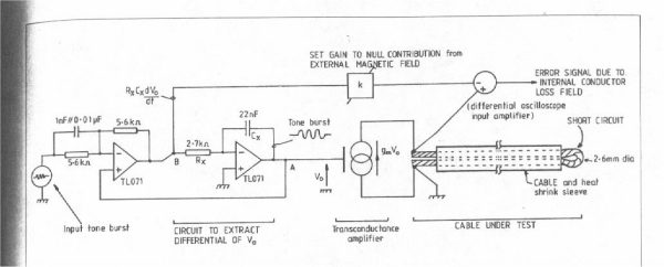

Take a look at the test setup..note how he says the feed forward nulling signal is for external inductance..without regard to the whopping self inductance of a steel wire.
Also..look at what he is looking across..the "error signal due to loss field" part..he is summing the externally derived inductance component with the signal across the wire..but..the wire represents a low impedance...the resistance of the wire, which is rather low, and the self inductance of the steel, which is, what.. .03 microhenries per inch with mu=1...40 inches (say a meter), mu of , guessing, 1000...that would be, 30 microhenries per inch, 1200 microhenries for one meter steel zip.. 1.2 millihenries..
Now, the wire..copper #12 is 1.71 milliohms per inch, steel, guess five times that?...times 80 inches..684 milliohms..
Now, 684 milliohms in series with 1.2 millihenries...how hard is it to see the phase shift he measured, and how it is because of the self inductance of the steel wire???? scope photo next post..

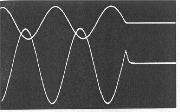

Here's the scope photo.
Notice the phase shift of the sine wave... then the reaction to the abrubt cut of the sine at zero.
This is a classic example of an inductive current shunt error when the shunt collapsing field produces an error voltage in the voltage reading..It is not a real entity, but the sum of current and error voltage..
For real current shunts, this error is eliminated by running the v tap wires down the geometric center of the shunt.
For Hawksford's setup, that was not possible...or tested for.

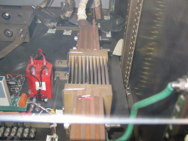

And here is an example of a current shunt..
This is a DC one, 250 micro-ohms, that is used for current viewing of a half sine, 6000 amp pulse.
When the half sine is fed into this, this produces a voltage which is proportional to the current..Unfortunately, it also adds an error signal which is proportional to the rate of collapse of this shunt's magnetic field..For low impedances, like this shunt, (and shorted wire lengths), that collapsing field generated voltage is a large proportion of the voltage drop across the element. At higher frequencies, the voltage is higher; it is proportional to the rate of change, therefore frequency.
This shunt produced the exact same waveform Hawksford shows..
If you look closely, you will see a teflon tube covered wire that drops into the shunt in the geometric current center (well, ok, there's an odd number of plates) 🙄 That wire is put in the middle of the resistor to approximate a coaxial shunt as much as possible..By doing this, the error across the shunt was reduced to below ten millivolts, from a signal of about 1.4 volts peak.
Sorry for the hazy look of the picture..It's on the other side of a 1/4 inch thick lexan blast shield. (case I blows it up)

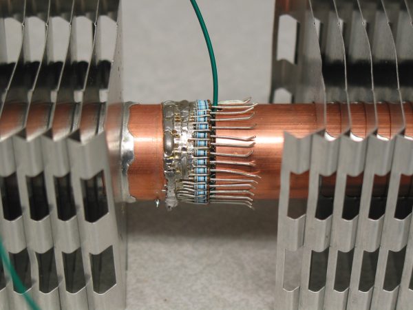

And here is my newest load resistor in the middle of the build.
It is made of 36 resistors in parallel, and coaxial, using 3/4 slant fin. Notice that in between each resistor is a wire. Those are used to return the current back in between the resistors. That makes a 36 pole magnet structure. The proximity of the return wires helps reduce the stored energy and inductance. This 36 pole magnet has internal fields that drop as 2^-35 power radially, and 2^-37th power externally..Just before those wires hit the 3/4 tubing, they bend inward and are soldered to a coaxial piece of 1/2 inch tube. So the current signal is fed coaxially from the right, and the v tap signal is picked up by that green wire and another connected to the 3/4 tube right there. In that way, db/dt pickup from the v tap wires is reduced to mud.
In the furture, I think I will go with a larger diameter tube, and use resistors for the return path instead of wires, as I can't guarantee current sharing between the wires that well, and it is the balalced currents that makes this load have inductance below 10 nano-henries right now..

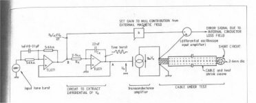

sully said:Here's the scope photo.
Cheers, John
John,
I confess not having read the entire thread, but I have a question on your waveform in this post. When you talk about the error, I assume you mean the little tail where the waveform doesn't return to zero in zero time, correct? The fact that the cutoff-point is not at zero is caused by the phase shift, right?
If that is so, isn't the error (tail) simply caused by the inductance of the current carrying conductor?
Jan Didden

sully said:Linearity with sine waves doesn't guarantee that it will behave linearly with complex waveforms.
Er, yes it does, that's what I mean by linearity.
If nothing in the equations depends on the absolute magnitude of the E or H values, and the system is time-invariant, meaning that it doesn't behave differently depending on what time of day the signals arrive, then any input signal can be analysed by taking its Fourier transform, solving the equations separately for each frequency, combining the results and taking the inverse Fourier transform. That's a simple matter of mathematics - there's a simple thought experiment which I'll describe if you're not convinced.
If you've been paying really close attention, there has been some mild cheating going on. At some point we say B = mu. H for the magnetic field, and assume that mu is constant - independent of the absolute magnitude of H. This is in fact untrue (particularly for, say, iron) and does indeed make the equations nonlinear.
However, I contend that this nonlinearity is present in the system anyway, and it potentially causes distortion even in the total absence of skin effect. The worst that can be said of skin effect is that it might increase the field strengths at a particular point to an extent that previously negligible nonlinearities in the system are now significant.
Cheers
IH
SY said:: when you say that the tail of the tone burst is not a "real entity," what do you mean? When I see a trace on a 'scope, it sure seems real to me, unless it's a measurement-induced error. The tail looks like what I'd expect from driving a small inductance.
You are correct..it is a real entity, in that it is seen on the scope. But two error mechanisms provide the same thing..first, a high inductance, which from JC's info below, was by using steel with a mu of 100, giving an inductance add on of .12 millihenries per meter of steel wire pair. The second is the current shunt field collapse, which is entirely fictitious w/r to the actual current in the wire.. This component of error can be seen by making a wire loop to short the scope probe, and run the loop one part against the load, the other coming away from the load at the commect point. This loop will show the field collapse error component only, as it couples magnetically to the shunt field.

janneman said:
John,
Jan Didden
FYI, it's Hawksford's photo. And yes, he say's that little tail is the "loss component", but I contend it's inductance, especially since the wire was so magnetic. I also contend that the phase shift in the photo is a result of the .12 millihenries of the wire in series with the .684 ohms (a guessed number)of the wire..in fact, a R-L circuit.
