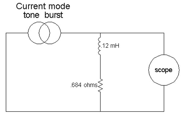

sully said:Here's the scope photo.
Notice the phase shift of the sine wave... then the reaction to the abrubt cut of the sine at zero.
Supposing we had an RC low-pass filter, running at somewhere near the turnover frequency. The voltage at the output is slightly lagged w.r.t. the input when fed a continuous sinewave, as you'd expect.
When the tone burst stops, you have a capacitor with a small voltage across it being clamped to 0V via the input resistor. The output voltage will decay exponentially to zero, just as we see here.
I find thinking about R's and C's intuitively easier than L's and R's, but it's easy to transform between the two. In other words, the scope trace seems to do just what you'd expect it to.
Cheers
IH

Here's a qiuck pic of the wire with it's self inductance, as per JC's mu of 100, and using a one meter (approx) length of steel wire, with an assumed resistance of .684 ohms per 2 meter length..
Being current fed, there will be a phase shift..and, when current is dropped to zero, there will be an inductive "reaction".
This model assumes the external geometric inductance has been correctly nulled out, so it was not included.
From the schematic of Hawksford's, it is unclear how the scope would couple to the collapsing mag field, so I didn't even include that error component.
Cheers, John

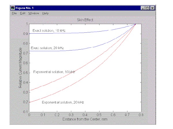

Oh, btw..I found a pic...this is a comparison of exponential vs bessel solution of skin depth at 10K and 20K for a .9mm radius wire, that is approximately a #12 AWG wire. I'll try to find the link, but that eludes me at the moment.
I note the bessel solution has about 1/3 of the exponential solution's effect. Seems the curvature of the wire surface is quite prominent when the exponentially derived skin depth is 1/3 of the radius of the wire.

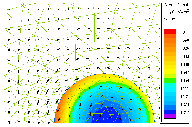

quickfield seems to be fairly complete for 2-d eddy current simulation, "time-harmonic" and "transient magnetics" simulations can vary conductivity and permeability, transient can model nonlinear permeability but both ignore permitivity-displacement current so it isn't a full E-M simulation
the student version is the first free E/M simulation package i've gotten to do anything remotely plausible without crashes and seizures, i was also able to create my own models and run them with only a few hours of playing with the user interface
cool pictures and most numbers you might want are readily available, time series plotting doesn't appear to include integral results, particularly total current over the cross section of the conductor that would be handy for device terminal characterization in transient mode
their "active field" interface does look like a solution to getting device terminal currents from the transient analysis, examples are given to define problems, control simulations, export and plot with visual basic/word macros - the bored or motivated could probably program a cable simulation to give the current from a sine burst in a transient analysis in a few days, and then explore the effect of magnetic vs non magnetic conductors in minutes
(- I get some credit at work for “evaluating” this software as we really are considering buying it for a funded project, but I don’t think I can sell them on my spending a few days on it – most of this has been off the clock)
I’ve learned more about how to control meshing (shown) and exploit symmetry, same 2mm cu wire 4mm cntr, 20 KHz current at phase = 0 from harmonic analysis and B field vector plot:

jcx: I liked the plots..thanks for the effort.
Questions...
Stated zero degrees...what does that mean..the current and mag field vectors appear to be max, which s/b 90 degrees into the sine..
Does this software have the capability of analyzing a linear ramp current of say 10^3 to 10^6 amps per second?
Is it capable of doing a section 90 degrees to the shown plot? IOW, show current density axially? In both the axial, and radial direction?
Can you set a boundary condition on the previously mentioned section, where the material suddenly changes either conductivity or permeability...what I have in mind is viewing the vector components of the eddy currents within the wire..As I suspect that superimposing a uniform current density on a reaction current plot (remember, mag field is linear with distance from center of wire) will produce the same current density as the bessels.
My intent is to simulate a linear ramp, showing the current profile as ramp rate dependent..and, I have a gut feeling that using the typical e/m wave penetration analysis for skin depth is not correct..don't know how to express that yet, but I trust my gut..
It of course, has to fit existing measured results..
I fear no simulation package is capable of doing what I want, and I will be forced to write a whole mess o' code to realize this wish..doable, but it sucks..visual basic ain't exactly the most "tight" with variables, truncation errors have the most "wonderful" characteristics..been bitten by that floating point bug during mag field simulation before.
Oh, BTW...if you increase the frequency to say, 100Mhz or 1000 Mhz...do the reverse rotation magnetic vectors disappear, as well as the negative currents in the middle? When the conductor is fully skinned, current maxwell theory states that there is no internal magnetic field, or current..So, that would be a good test of the simulation software capabilities..
Cheers, John

Coupla quick notes on that cool plot..
First, notice the arrow mag field vectors? inside the wire, they rotate in the opposite direction to the externals...
That is because inside the middle of the wire, the current is going in the opposite direction..against the current..
As you integrate outward, the magnetic field is flowing cwise. But, at some point, the integral goes to zero , then reverses..The flux direction arrows also reverse as a result..going ccw.
Note that the center of the color fields is moving to the right..that is the effect the opposing current in the partner wire is having on the visible wire..the other wire is causing a magnetic field that is dropping as 1/r in the view, and since it is a field that changes at the same rate as the visible wire one, it will alter the current profile of the visible wire.
What I wish to do is model a linear ramping current with this type of wire model..the reason is this: current skin theory is based on e/m fields impinging on the conductor surface, and driving inwards at some prop speed. So, the classical view is that the sine varying field goes in, showing some exponentially varying drive into the metal..
But, if a linear ramp current of sufficient speed can be modelled using maxwell correctly, I think it will show the exact same internal reaction...that of reversed current direction within the conductor..That would be in direct contradiction to the currently established view of normal to surface wave propagation. But it would certainly validate the metal reaction to the time varying magnetic field, and would force a re-thinking of skin effect in general...(not askin for much, am I??)🙄
Cheers, John
