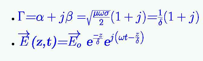

Just to sum up for dummies like me, I've tried to get back to my old school days. If memory serves, and as Andy_c said, deriving Helmotz equations, or more basically, the curl(H) Maxwell's equation, assuming that the E field solution is in the form :
E(z,t)=Eo.exp(-gamma*z)exp(j*omega*t)
then assuming for good conductors that displacement currents are far less important than conductive ones, the propagation constant is found to be as written on the attached picture (for a semi_infinite medium, not a wire) 😉 .
And if I remember well,it is just a convention to call delta the skin depth. In fact, this depth is the one the field has to travel inside the conductor to be attenuated by a factor e, or exp(1). This does not mean that there is no field after this depth.... So should we go further, or deeper... ?

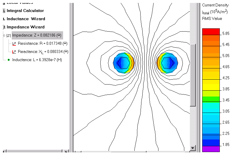

of course armed with little knowledge and free software you could just simulate:
2mm dia Cu conductors, 4mm cntrs, 1 A @20KHz
re 50 Hz values of 0.0119 Ohm R and 0.667 uH ( /m)
(no i won't do requests, download it yourself)
http://www.quickfield.com
