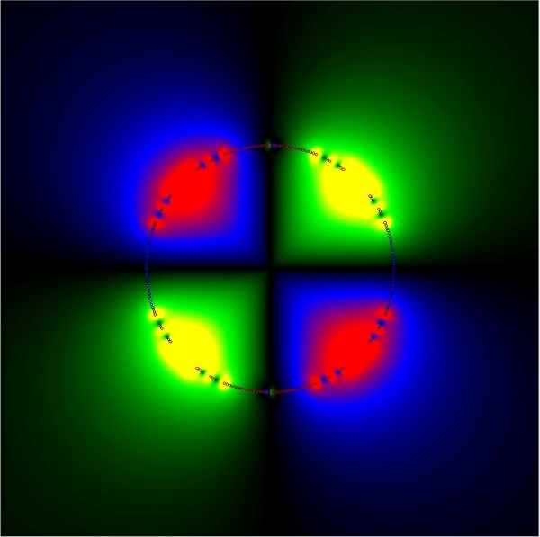

Here's a pic of the field map of a quad magnet..Turned out that the field map calculations weren't the hardest part of this..it was the code to map field strength against false colors..Hey, if ya gonna make a pretty picture, ya gotta make it visually symmetrical.
It was made using a 2 d cross section of a superconducting magnet, and the colors represent the azimuthal component of the magnetic field. Yellow, for example, is field intensity in the clockwise direction, while red is counterclockwise..
Unfortunately, it is only static code..to make it capable of dynamic simulation, with 3 d inclusion is probably gonna be a tad more difficult.
(sorry, I just had to put a cool pic up..couldn't resist)
Cheers, John

SY said:You just put me into an epileptic seizure.![]()
Then I have accomplished my goal...my work is done here..

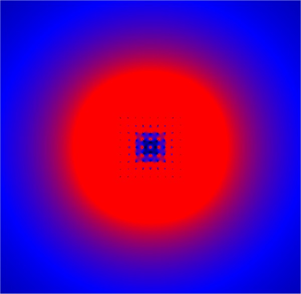

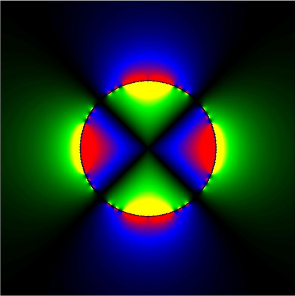

Here's the same field, but this time it's the radial component of the field..this time, yellow indicates field pointing outward, red is pointing inward..
Cheers, John

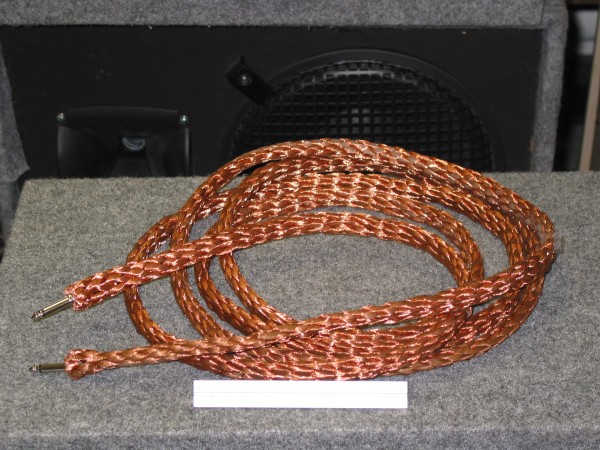

Oops, almost forgot a pic.....
Now, THIS is a properly shielded cable..that's a six inch ruler leaning against it, and a 12 inch woof behind.

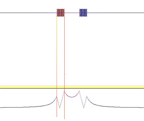

jcx said:
Nice writeup.. two points..
PEEC assumes a uniform current density within the bars..and, it assumes rectangular busbar cross sections..
Also, in figure 6, the free space magnetic field is rather interesting..
Between the conductors, the field doesn't drop off in a 1/r fashion...Hmmm... it even drops off slower than linear near the conductor..wonder if the square section is the reason for that..
I note that there is no inverted magnetic field in the conductors, even they show skinning..again, hmmmm..
Thought bout this issue for a week...I really am not happy that some modelling programs are showing reverse current in the middle of conductors, regardless of frequency...trying to decide how real that is..same with the reverse rotation magnetic field..
Cheers, John

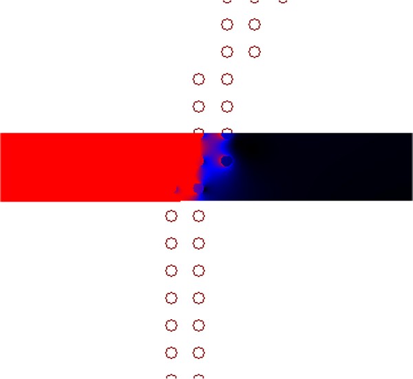

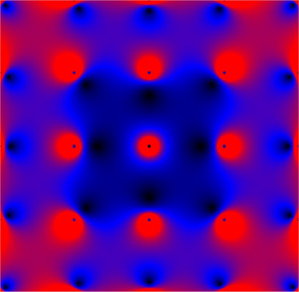

Starting the coding process for mag field visualization. Initial code is only for static fields..(hey, gotta walk first).
Rather than integrating uniform current densities, I've setup the code using discrete current wires..points on an array. The first pic here is of 81 wires in a 9 by 9 array of wires, all the same current. This pic is far field absolute value, showing the falloff of field flux density w/r to distance from the square array. Note that in the middle of the pack, the field has started to drop..
This is a closeup of the middle of the 81 wire array. The black dots are the wires, as I prevent the calcs very close to the wire due to 1/r field strength. Because of the discrete model, the flux pattern is artificially granular..to get rid of this, more wires are needed. What is important here is the way the flux is showing around the wires, which is consistant with theory so far..

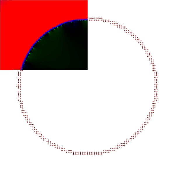

Here is an array of 6400 wires, but I have excluded all wires over 4 inches out, and under 3.8 inches, leaving a cylinder. Of note is the lack of field within the cylinder..(the green splotches are just artifacts of the model..) This is the type of current density that is supported by a heavily skinning conductor..NO flux on the inside of the wire, hence, no internal inductive storage.
This last pic is a closeup of part of the shell of wires. Again, all the swirly field stuff is just an artifact of the individual wires, not a real thing..

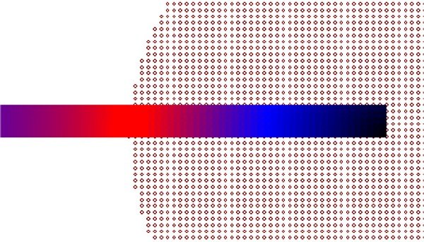

I don't have any more stuff in the code yet..No field auto-scaling, and the feature I want is to see the flux intensity along a line I define, as well as the integrated inductance from the center of the wire to 10 diameters away. to show the linear flux relation inside, and 1/r outside...Another day...another transmission (sorry, major bummed out with my voyager...doesn't shift..
I'll probably add in mag vector lines, to show flux directions.

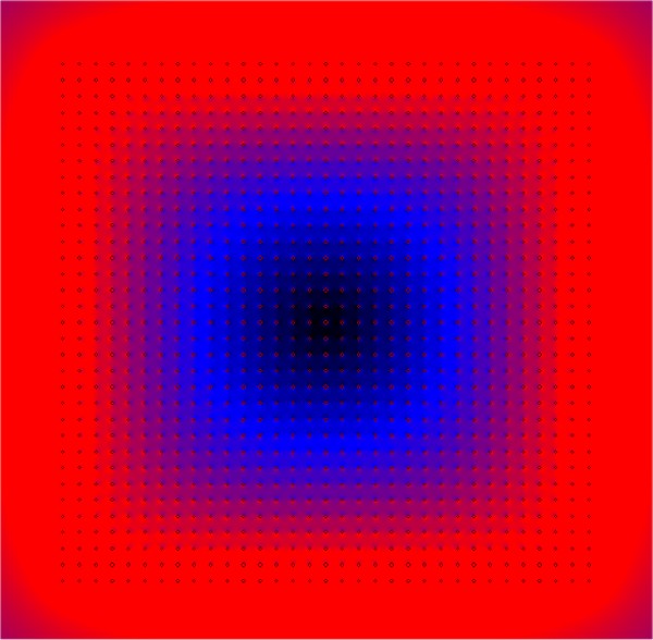

This scan is of the 6400 wire array, excluding all wires out of the 4 inch diameter. Although there are slight ripples, it's clear that the resolution is rather good, and that the flux at the center of any wire carrying dc is zero, with it increasing up to the surface of the wire.. next code mod will have the line scan, allowing the actual flux magnitude plot, and hopefully, the integrated inductance from the wire center out..

Here's a scan of the flux magnitude on a line to the center of the wire. I scaled the view to give a clearer farfield behavior.
Of interest here is the way the flux behaves..Note that outside the wire, the flux falls off as 1/r...but, within the wire, the flux is linear, starting at zero in the center of the wire, and increasing up to the surface of the wire..
If I include a mu in the wire, the linear ramp will scale..mu=100, ramp is 100 times steeper, with a discontinuity at the wire surface. But that addition will come later.
I've been keeping the processor time down with the hi wirecount runs by limiting the area computed..scans are 800 by 800 pixels, with 6400 wires contributing to each pixel field, in both x and y directions. So, speed is quite low. As the code gets more options, I'll bite the bullet and go for huge runs..
Cheers, John
Now...for some two conductor plots...I was hurried, so they are square, but the plots are close to the round plots..
First, two wires, opposite polarity..
This is an ABS plot..
Note the 1/r external decay...and the enhancement in between..
I drew in some vertical lines to bracket the in wire area. Notice the flux drop is linear still. But, notice that the zero point is no longer symmetrical..it is being forced away from the other conductor.. also note the in between field..
John
John
