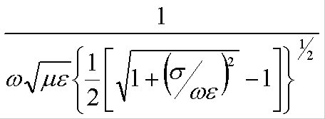

Effects of epsilon
Well, I don't mean to turn this into a contest, but 1/137 asked about epsilon. I dug up the equation for skin depth that includes the effect of epsilon and tried it out with the equation editor from Word XP. The equation editor is not too bad! The equation previously posted assumes a good conductor, so epsilon drops out. The equation below doesn't make that assumption. I got this from from "Advanced Engineering Electromagnetics" by Balanis, page 149.
As is the case for the other equations previously posted, this is for a TEM mode plane wave, which is different from what you'll get in a transmission line application with lossy conductors. I don't have a clue as to how the transmission line problem is solved with a lossy conductor and a uniform cross-section, let alone when twisting gets into the picture. For sure the propagation is no longer TEM mode, and that really complicates things.

1/137 said:(...)
2. without seeing the derivation i can't say much..but i wonder if there isn't a classical dielectic (as well as a conductor) in the model used to derive that equation.
3. the dielectric onstant for a metal is a complex quantity with the complex part being sigma/omega....based on what i have in front of me.
4. the derivation that yields a simple formula for delta that i posted...(and Jan posted something very similar)....looks at a metal half plane and derives the field strength as a function of depth...and it falls out to be cleanly a function of mu, sigma & omega...which sorta makes sense...at least to me..
The derivation proceeds pretty much like what you've described. A TEM-mode plane wave is normally incident on a semi-infinite block of material. So you still have TEM mode propagation inside the material. There's only the classical models of sigma, mu and epsilon used for the material. No complex dielectric constants like what's used to describe dielectric heating of water in microwave ovens and such. The Helmholtz equation in the frequency domain
del squared E = gamma*gamma*E
is used. The propagation constant is given by
gamma*gamma = j*omega*mu*sigma-omega*omega*mu*epsilon
The real part of gamma determines the nepers/meter of attenuation in the material. The skin depth in meters is just the reciprocal of the real part of gamma.
The formula I posted should reduce to what you posted if you make the assumption that (sigma/(omega*epsilon)) >> 1 (I hope!😉 )

Fine, so I was on the right track.
