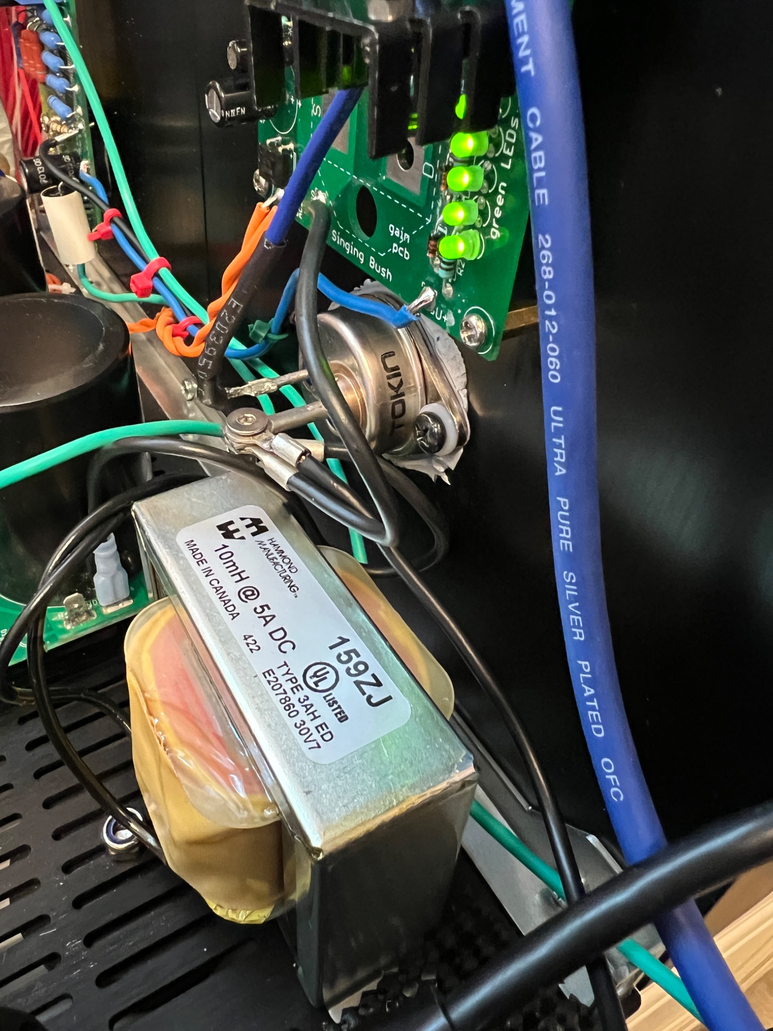

Almost there, need to finish ground on SIT. PSU voltage is descending after I shut power off, so disregard the value. Look at these photos carefully!

Choky,
As luck would have it, it looks like the 5k (no end-click in either direction) pot at P2 on the gain pcb is bad. Across R10 I have an unchanging 2.5KR, whereas on the on the other channel I can raise and lower across R10 easily. No way to set max neg. on Gate.
The drain of the SIT is the the SIT case?
but of course, I'm not checking their rotation
just for the record - some multiturn trimpots are giving audible click on both ends, some at just one, some not at all
in all these years I never found consistency in that ......... every time I had some quantity of same (whatever brand), just when I was thinking I gotchya, these all are behaving the same, 31st or 51st prove me silly
so, trust in DMM, ignore ears, in case like this

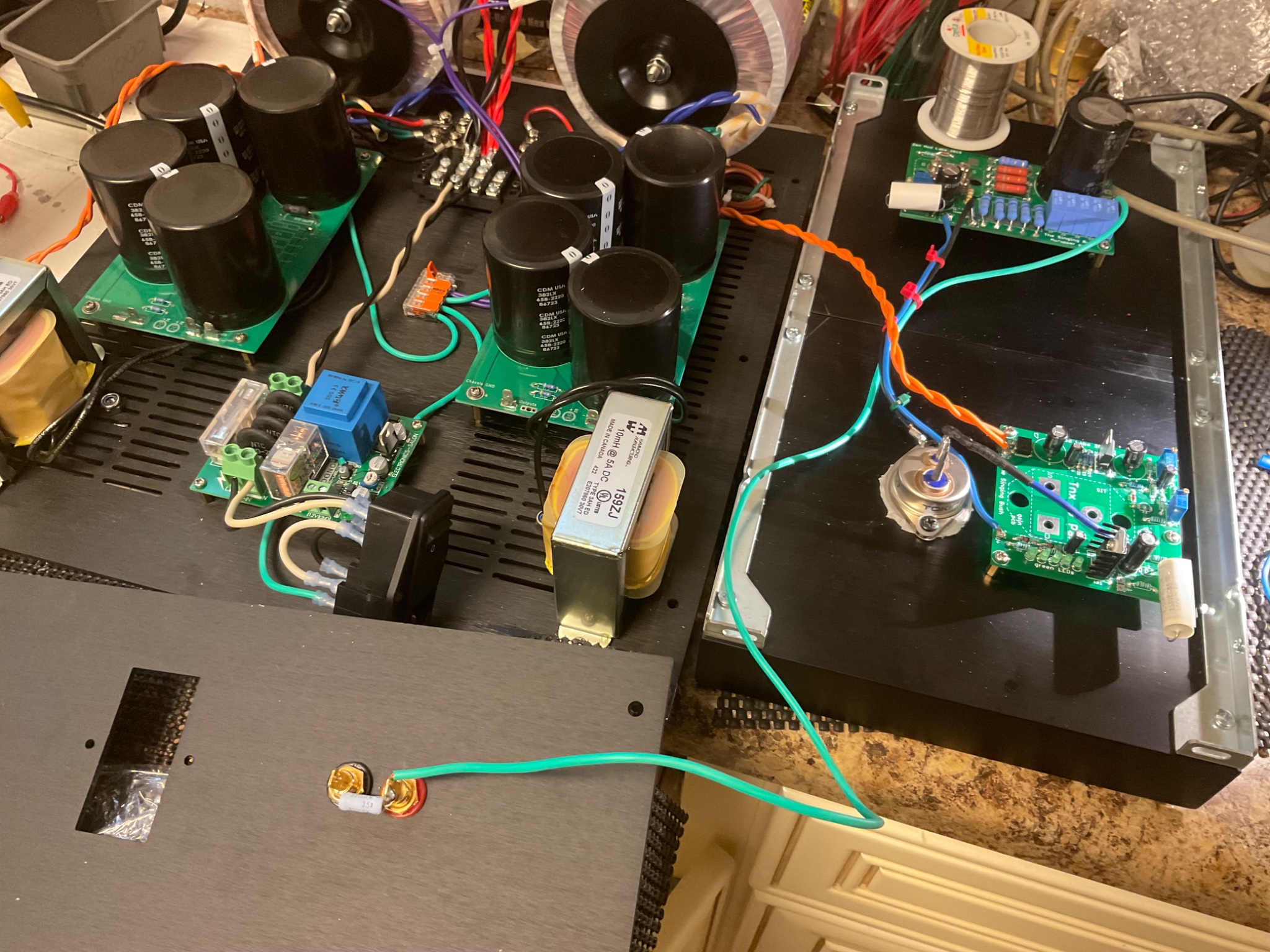

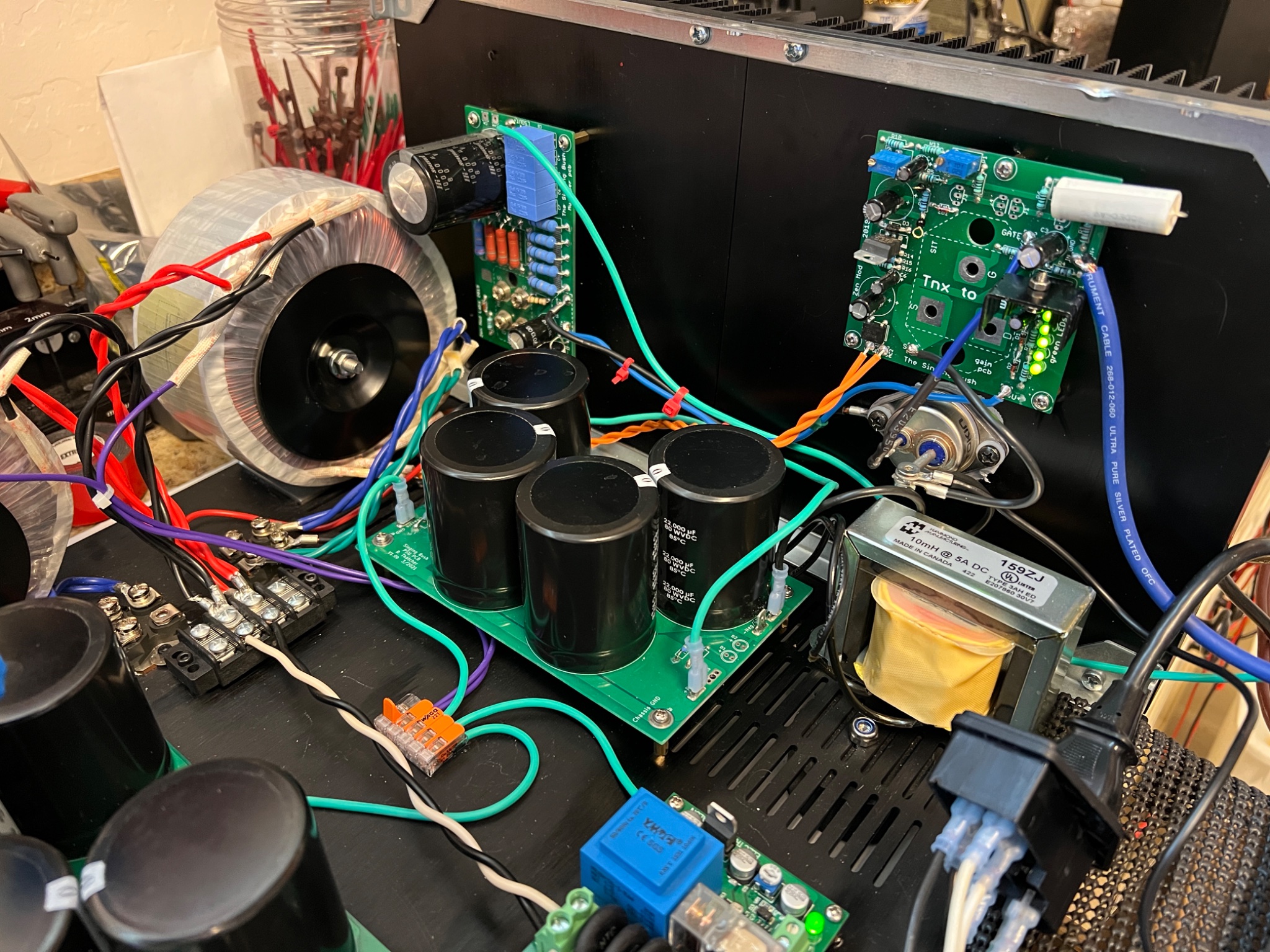

I did Boeing work on my layout, really tight and almost didn’t work. I wouldn’t recommend a single chassis as I did. I’ve built a lot of amps and this was a challenge for sure to make it all fit.

Choky,
I'll see if I can post a video on YT of it making sweet music. First channel is cooking on bench, and I mean cooking. Voltage across drain and source has dropped to 450mv.....so I need to see-saw Iq again, but of course, that is still fine.
