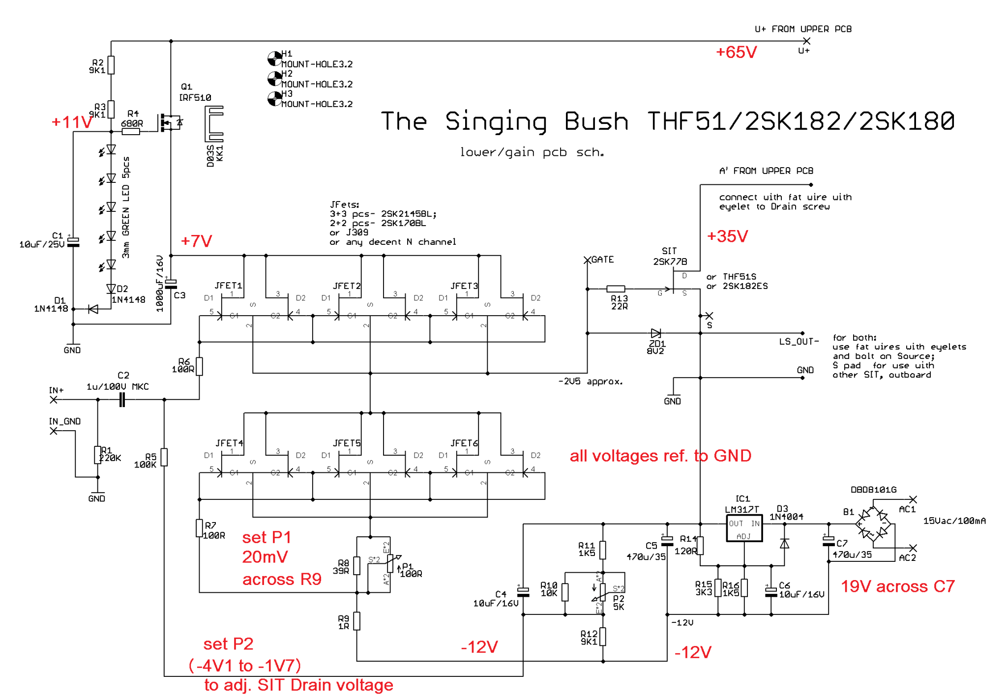

LM 317 pinout is - numbers to you, pins down : most left Adjust, mid out, most right input
all ref to GND:
on input you must see close to your Aux AC*1.41; if you have 15Vac there, DC must be close to -20Vdc
of course, worth repeating, that Aux (15Vac) must be independent/floating of main audio PSU secondary
so, confirm that you have proper Aux AC voltage, then if anything is fishy with LM317 voltages, replace it
see this
think, try and say where you can see difference to yours

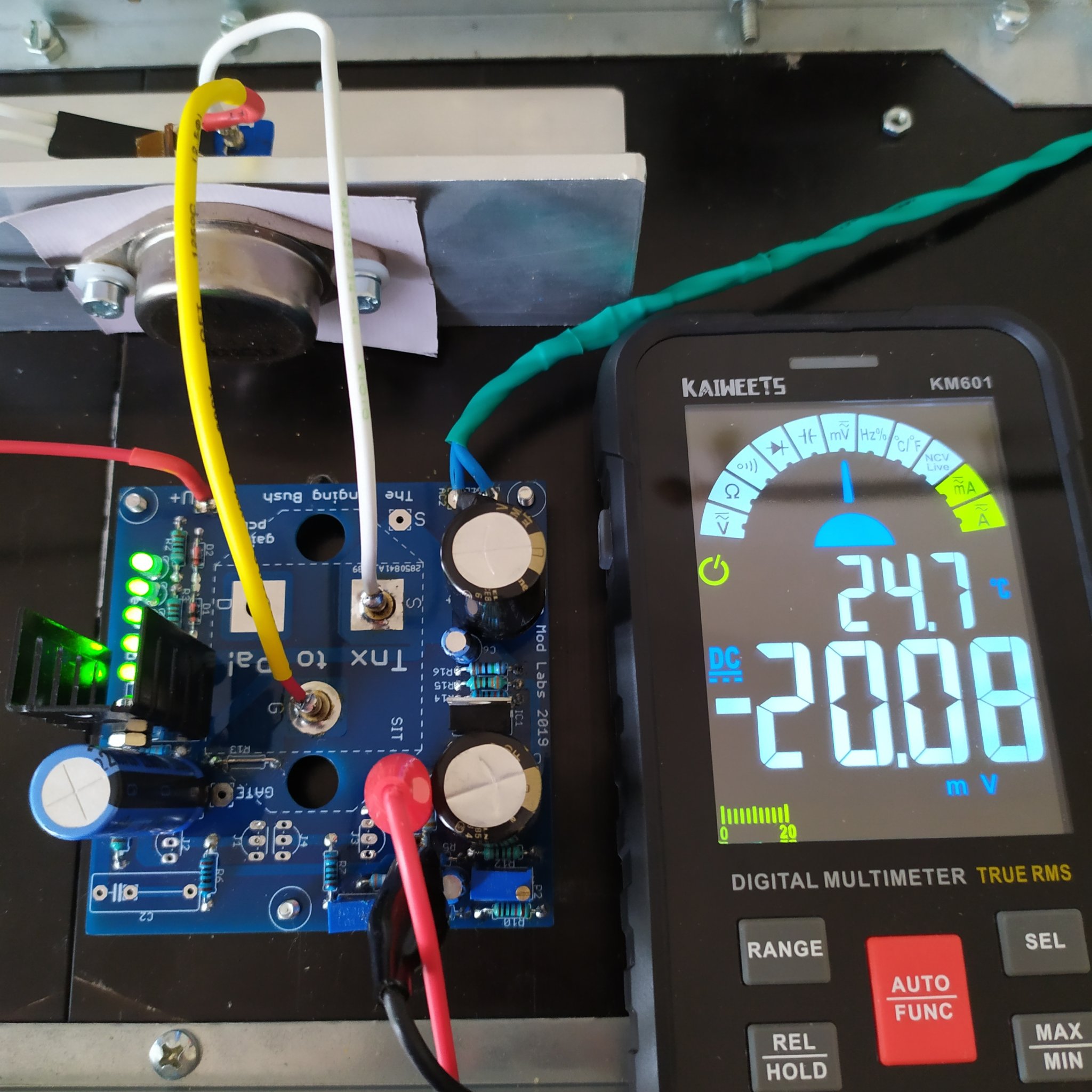

the preliminary checks carried out before assembling the components do not always give us back the truth. I discovered the component responsible for the problem after examining it several times and found it suitable, I set it aside. It was the R8 which, checked again today with another tester, did not return any value: it was the faulty one and also interrupted the circuit in its position. I happily replaced it on the fly and of course was able to bias the buffer to 20mA. Finally the first step is done. Obviously if I had sensed that resistance was about to die I would not have tried frantically to shoot into the pile...and despite the shots no one fell...I was swollen with rage that was the engine to control everything again. I hope I don't have any more problems. Everything went smoothly in the previous construction of the Bush.
I thank ZenMod who generously helped me: I'm leaving again also thanks to your support

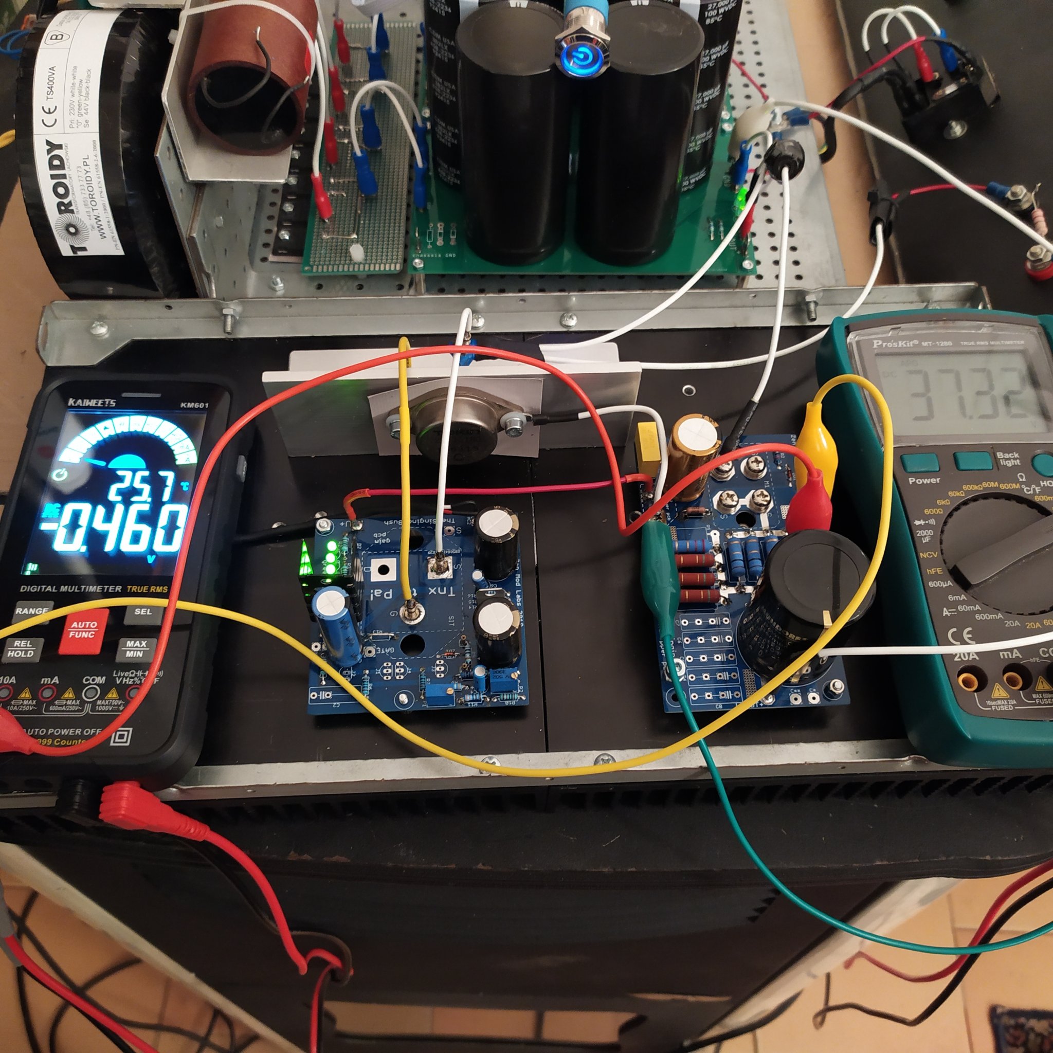

biased the power section. Obtaining it was not easy: I had to change the values of two Resistors.
The first on the MU board R3 increased from 100 to 150 R. The other on the SIT board, R11 increased from 1k5 to 3k3.
So I was able to get the design values: 460mV for Iq and the potential of 37V on the drain of the SIT (2SK180). Good progress. Tomorrow I fight with the other channel

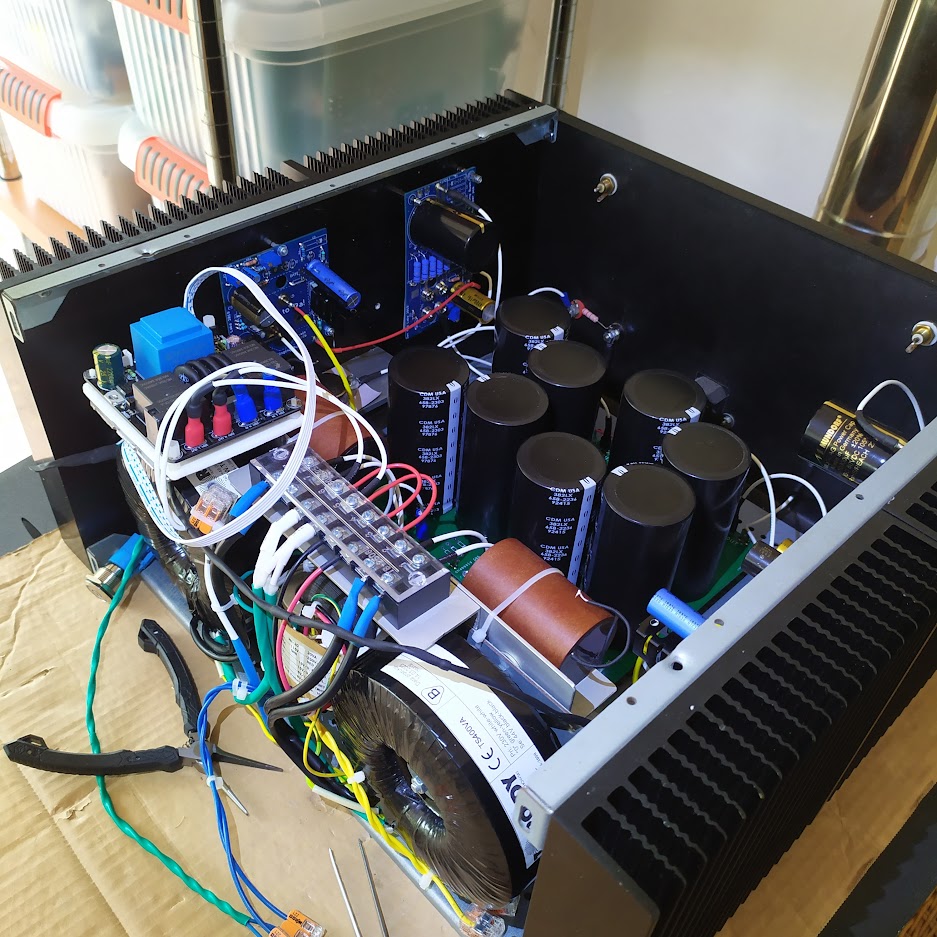

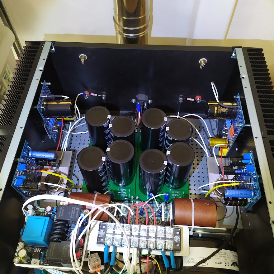

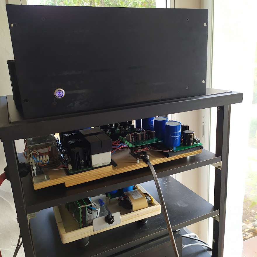

Great Zen Mod, the new Bush is playing. Wonderful as always: the magic of this amp repeats itself. Forget the hitches of the initial tests, now the Music and what Music.
A lot of gratitude for the help you have always given to everyone, not only to me, but above all for having given us this incredible amp.

I have a weird situation... I don't see any voltage gain, and in fact I get fewer volts out than at the input. I had it working at first, but then I have changed the output resistors to be 0.3R : 0.2R mu :sit. The bias is 2.8A (0.558mA across R5 on the mu PCB), 38.5V at output node. I assumed the 2SK182ES is too closed, and I measure -4.88V before R13, not -2.5V. All other voltages check out. Any thoughts what I could do to lower the SIT gate voltage? Thanks
SIT gate voltage isn't a goal per se; it is governing voltage, by which you're setting apparent internal resistance of SIT itself ..... just take it as variable resistor where resistance is set by Ugs voltage
now, if you have set Iq you wish, and you can get approx. Urail/2 (and few volts above that) at SIT Drain, you're good regarding static values
confirm what you have there, so we can proceed ........ now, gain issue?
