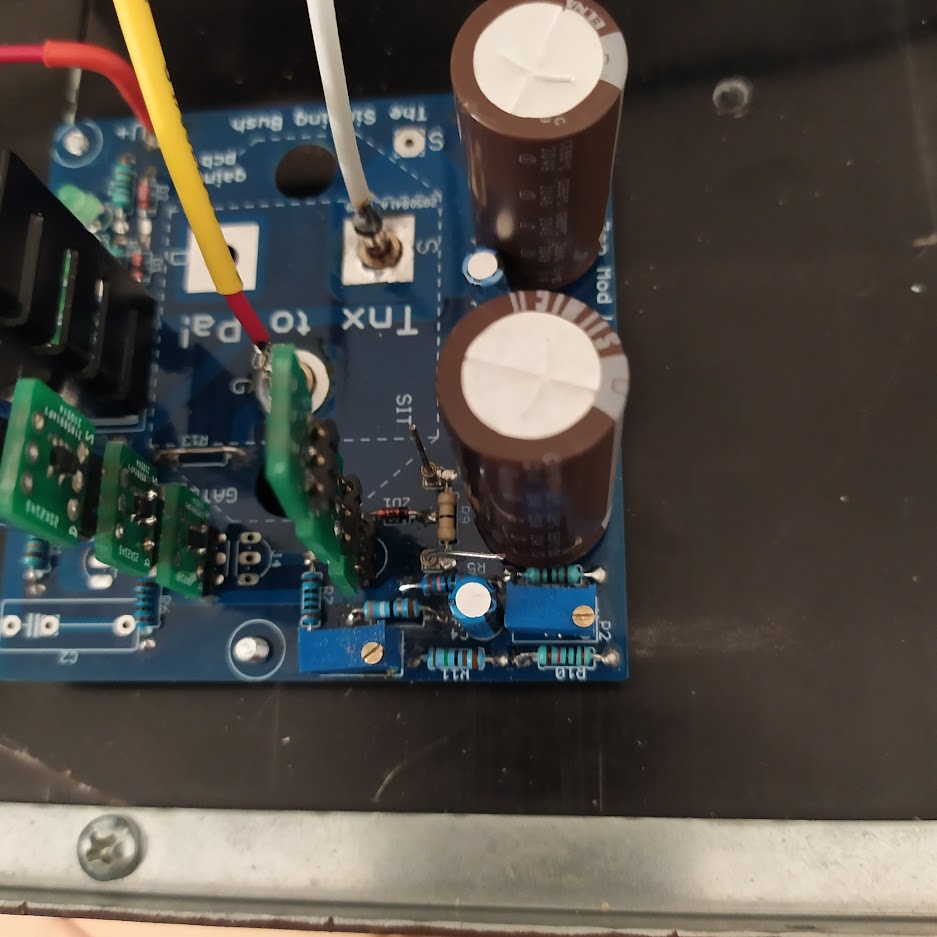

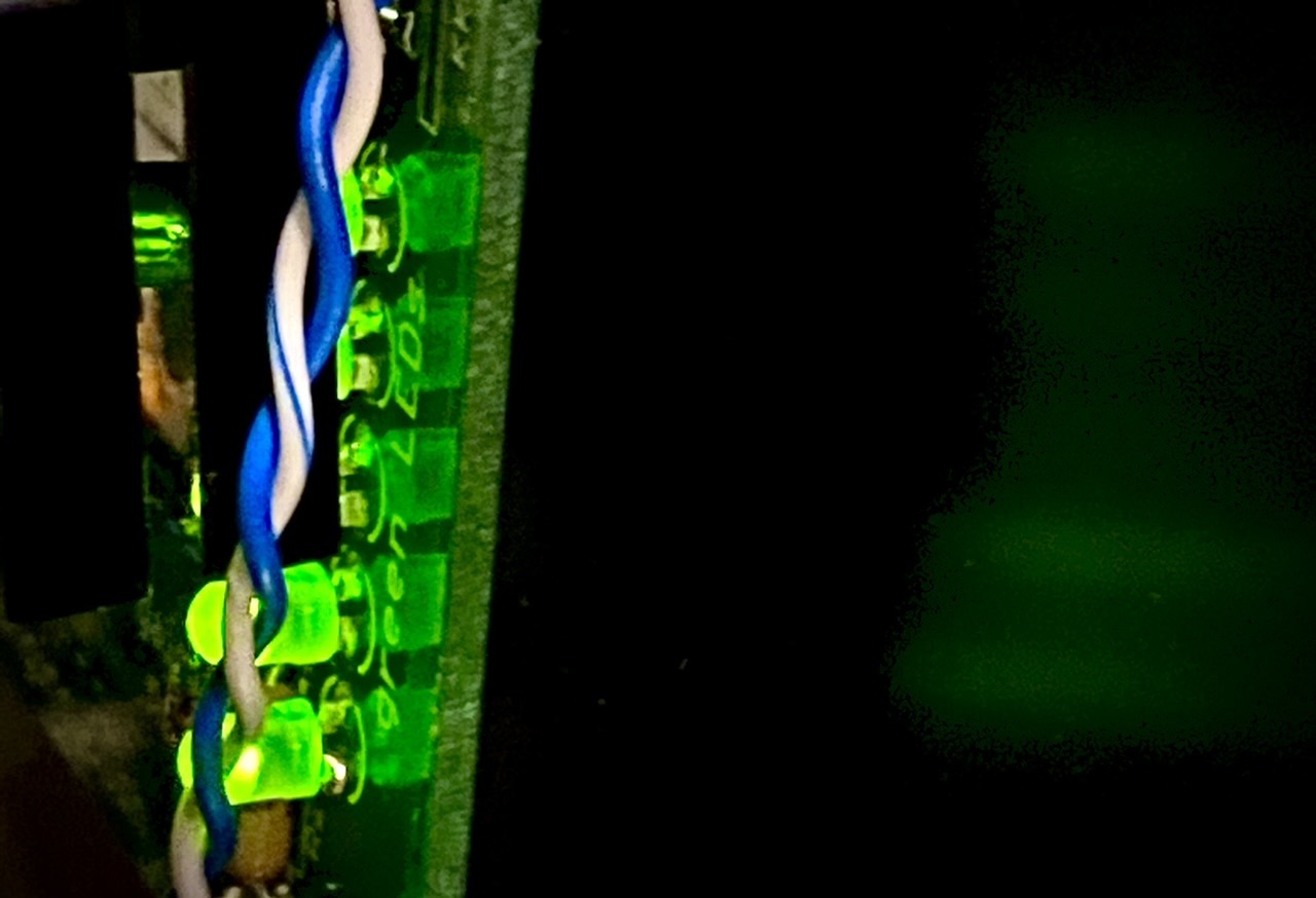

greeting ZenMod and all friends.

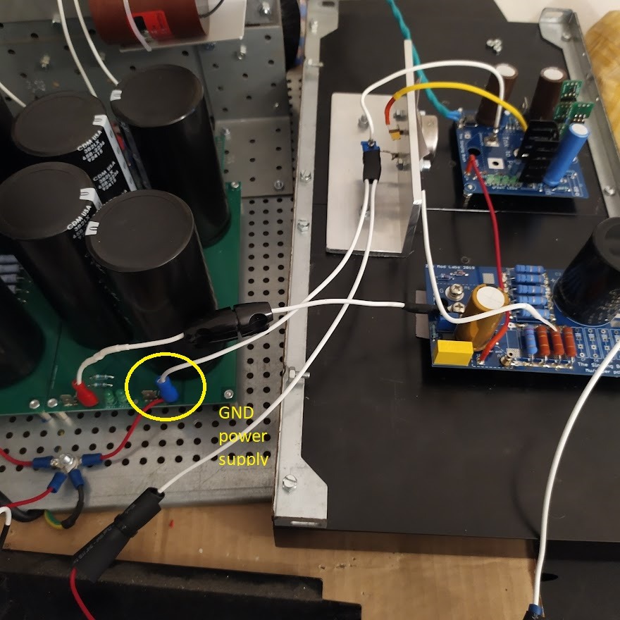

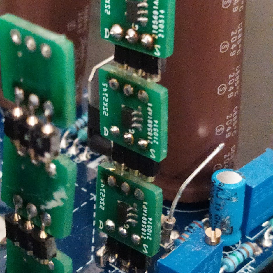

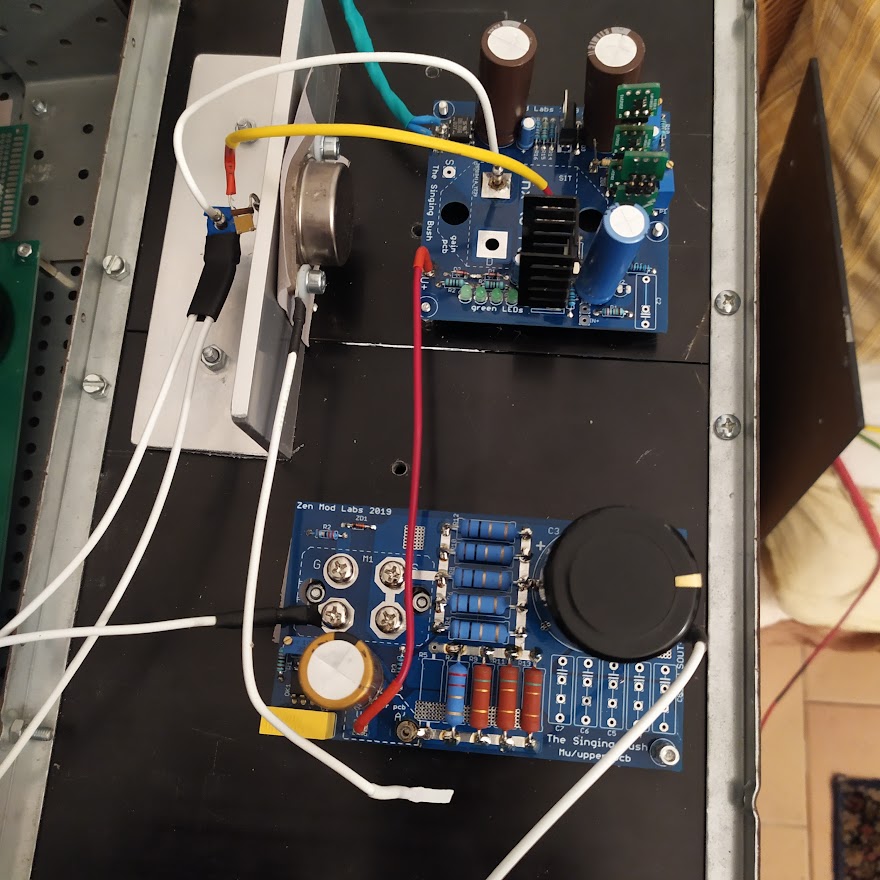

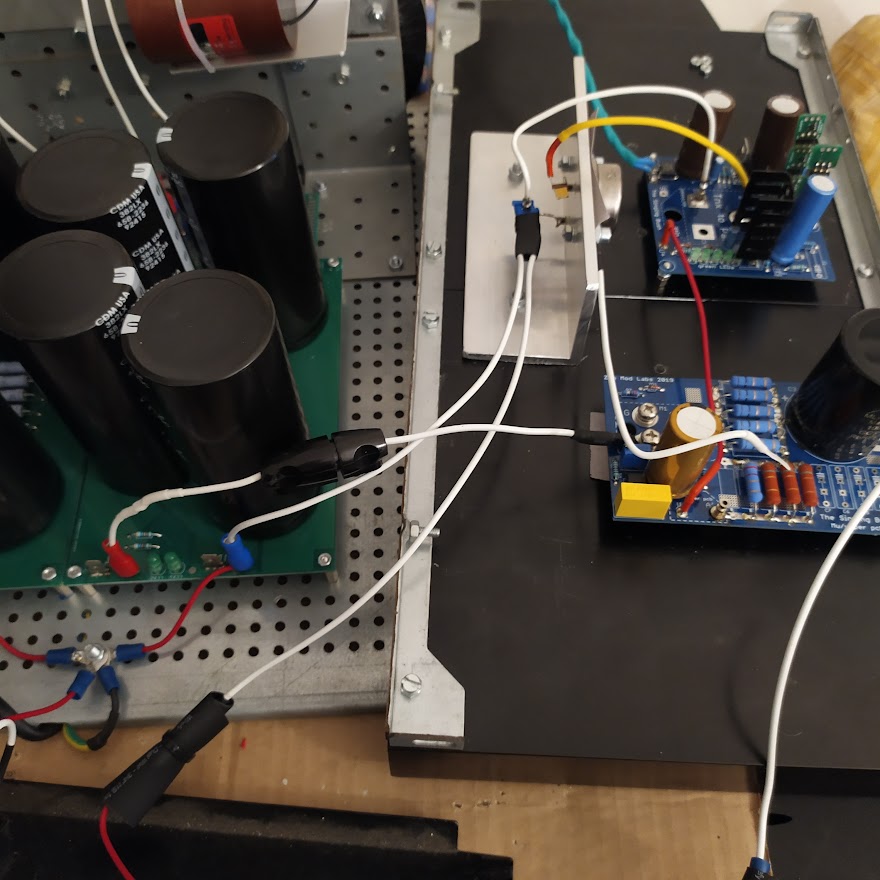

i am testing the bush i replicated. I hit my head on a problem that I can't figure out: I can't set the current produced by the jfet. The digital tester does not measure anything, it stays at zero. The LEDs light up. I detect 28 ohm on R9 (which is in parallel with trimmer P1). The voltage of 64V DC is present.
I try to move P1, and nothing happens. As if the fets were banned or dead (but I don't think so, because I replaced them with 2145 in my possession which are certainly good).
I need help getting out of it. ZenMod will you be able to save me?
- what voltage you have at G of JFets? On G (gate) of fets -4.16V in the upper ones and -11volt in the lower ones of the scheme( +7,4 on drain Up , -3,7 drain for inferior fets )
+8V at IRF Source, I detect on the source of the IRF +11
and that last one must vary with P2 , no it doesn't vary
On G of the SIT I detect -3.65V and it tends to vary moving P2
- I hope you did connect GND to pcb too
- I don't think I could make measurements without reference to GND
