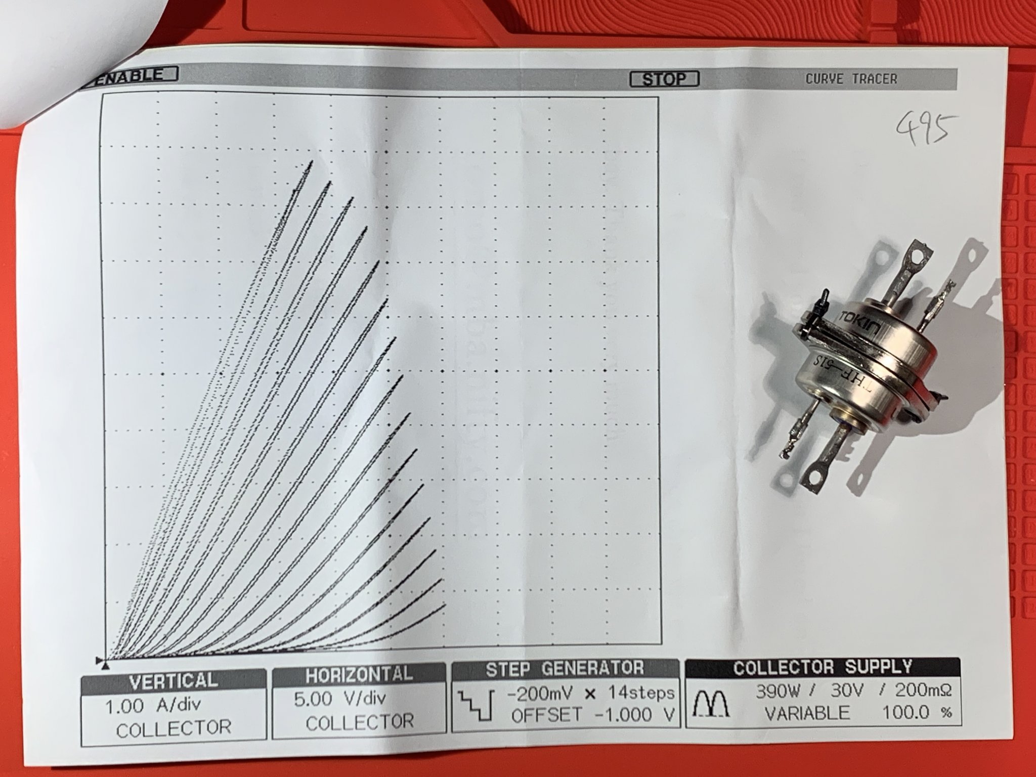

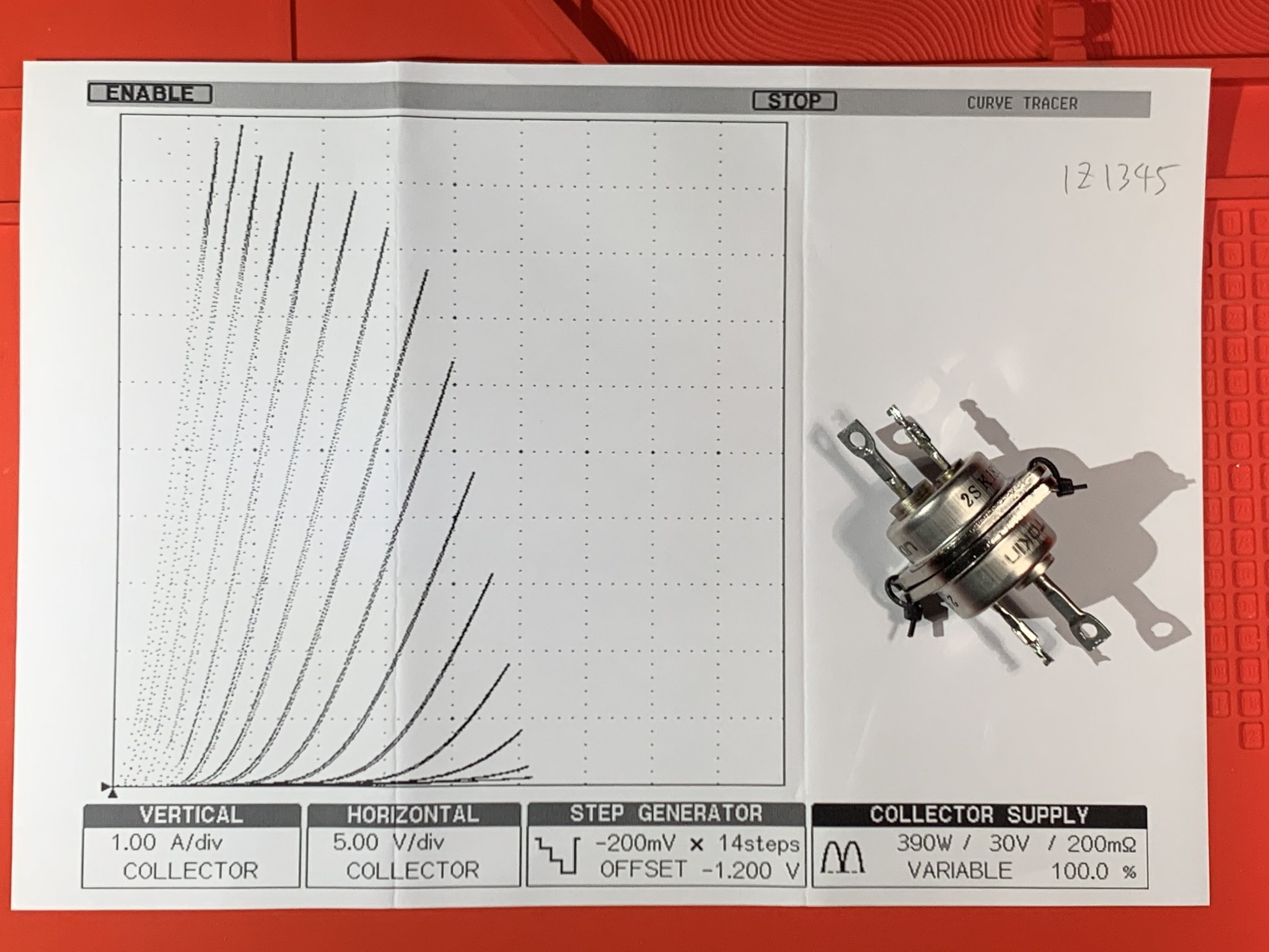

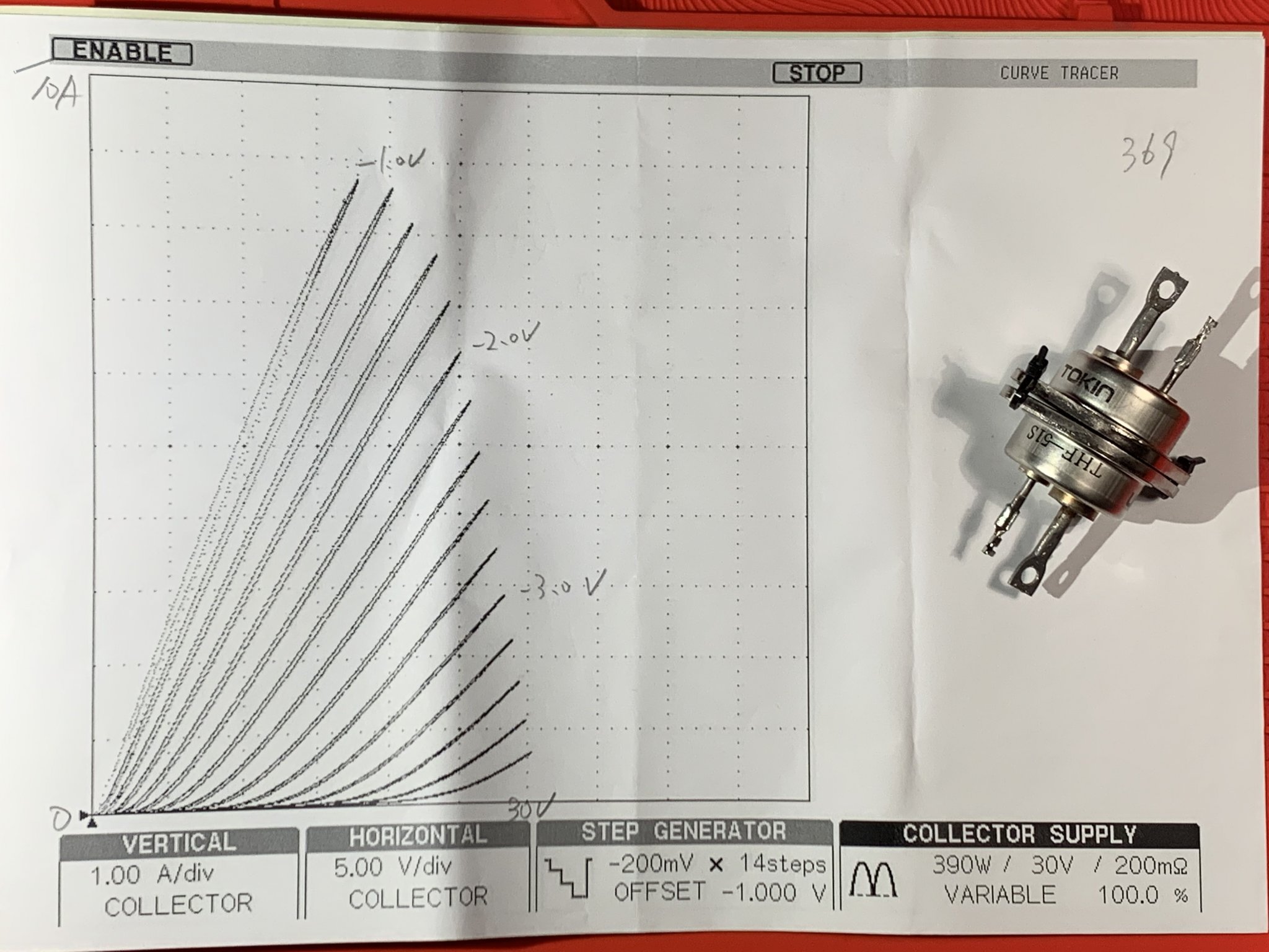

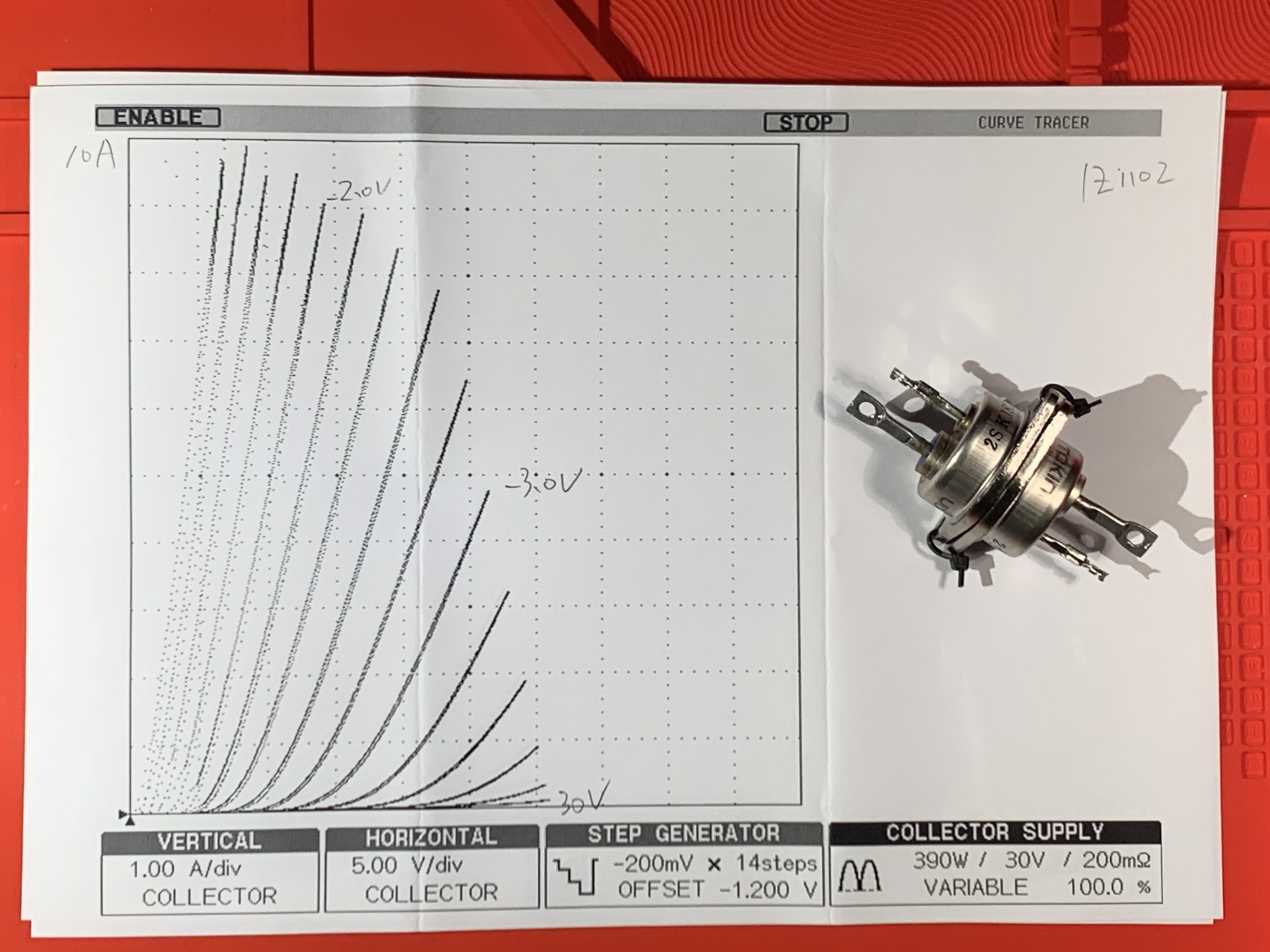

Well? It surely aint over until THESE beautiful ladies sings!! 🥰
Reactions: ItsAllInMyHead
Yea well, by simply and purely scientifically doing a classicly solid EYEBALLLING of them fine curves, alone, it seems to be a pretty significant(!) difference between my absolutely lovingly smoking hot 2SK182ES twin babes and them THF-51S very good twin VERY bad girls.
Well, it seems for real, exist a interesting difference. Dont ya think?
I am of course joking with ya and having fun. But it is! a interesting difference between the pairs. So. It is gonna be fun to ”tube roll” them in the coming builds over the coming years 🙂
😎🎸<—-me playing the electric bass ❤️
Me just blabbing and not really giving you all some pure music gold?
Hrm. Excuse me 😎
So, here it comes: Utterly full and Juicy, very, very dynamic, fully fat, yet beautifully firm and with the sense of full clarity and lightning fast attacks.
Simply: The saxophone and the electric bass creates a incredibly cool Music groove!
Well? So? Time to give them mighty Tokins (or whats currently up and running) a real run for their money!!!🎸
Always save your ears for the really good music. So, now: Smile. Crankit up! 🤘🙃
https://tidal.com/track/143321235
