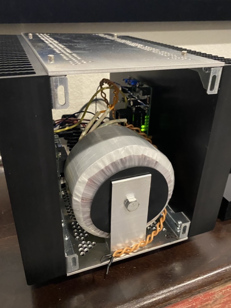

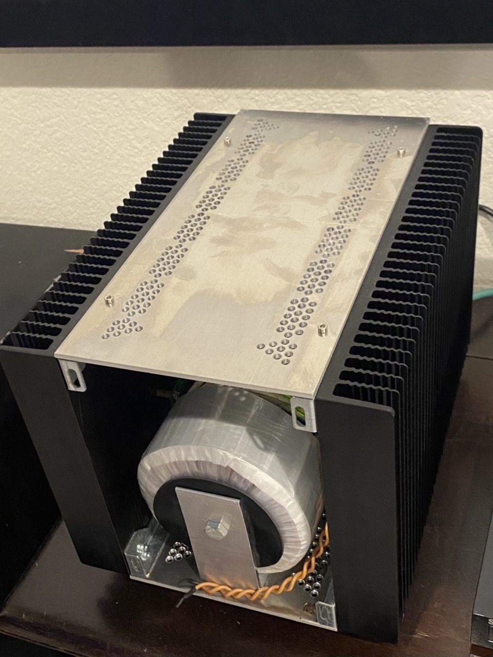

jwjarch - I have always been told that the noise of a toroid power transformer is emitted from the center and flows from there.
It could be that this is a cause of your noise. I know plenty of time I have been tempted to try what you did for packaging reasons but have not for fear of noise problems.
Hi Rick. I seemed to have toroid noise issues in several of my amp builds but with more care of shortening transformer wires and signal input wires it usually takes care of things. My main issue on this amp was that my input connectors seem to have been creating a ground loop. I've since changed their position through trial and error and everything is completely silent now. I still have to fabricate the rear panel and give them a solid home in some aluminum. Hoping to get to that soon. Thanks for the tip on the transformer mounting. I've also heard from Ben Mah and others, that rotating/clocking these toroids can help in reducing noise. I might give that a try at some point to see what if any effect there is.
My toroid transformer experience has been with Anteks, and they definitely leak electromagnetic fields at the wire lead exit locations, so rotating them to find the orientation of least EMI is worthwhile.

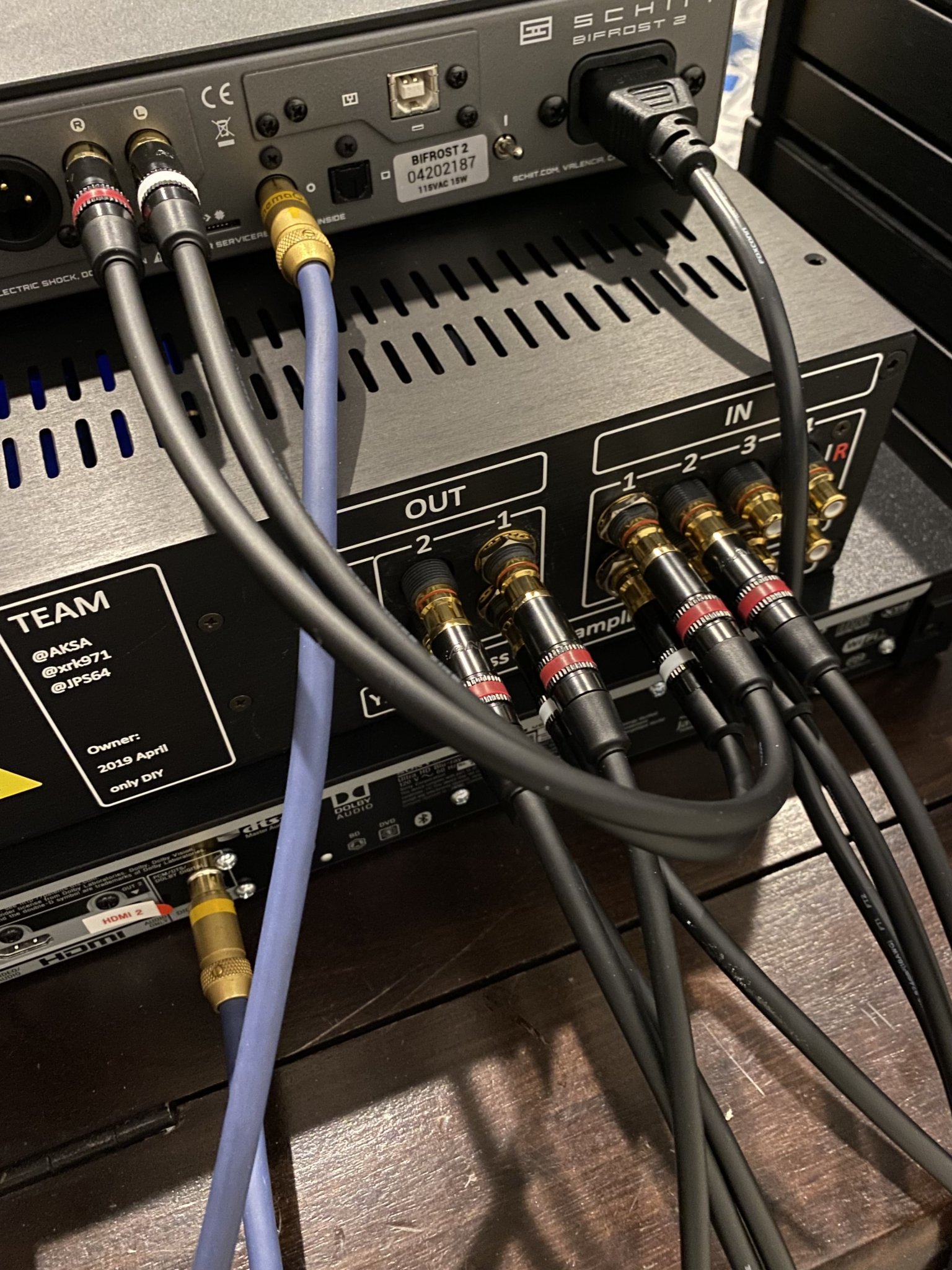

Another area to check for noise pickup are your interconnects. I literally just finished soldering together new interconnects for my system from Mogami 2524 cable with Neutrik Rean NYS373-2 RCA connectors. I heard an immediate difference and further reduction in noise coming through the speakers. Prior to that I had a really horrible mix of “free” interconnects. You know, the ones that came with your VCR back in the day. I also had a pair of Audioquest cables which ended up getting broken ground wires and seemed to amplify noise. So that’s another great improvement to the system. Listening to Jazz at the Pawnshop Vol. 1 right now. The marimba is crystal clear. Amazing. These amps are truly special.
