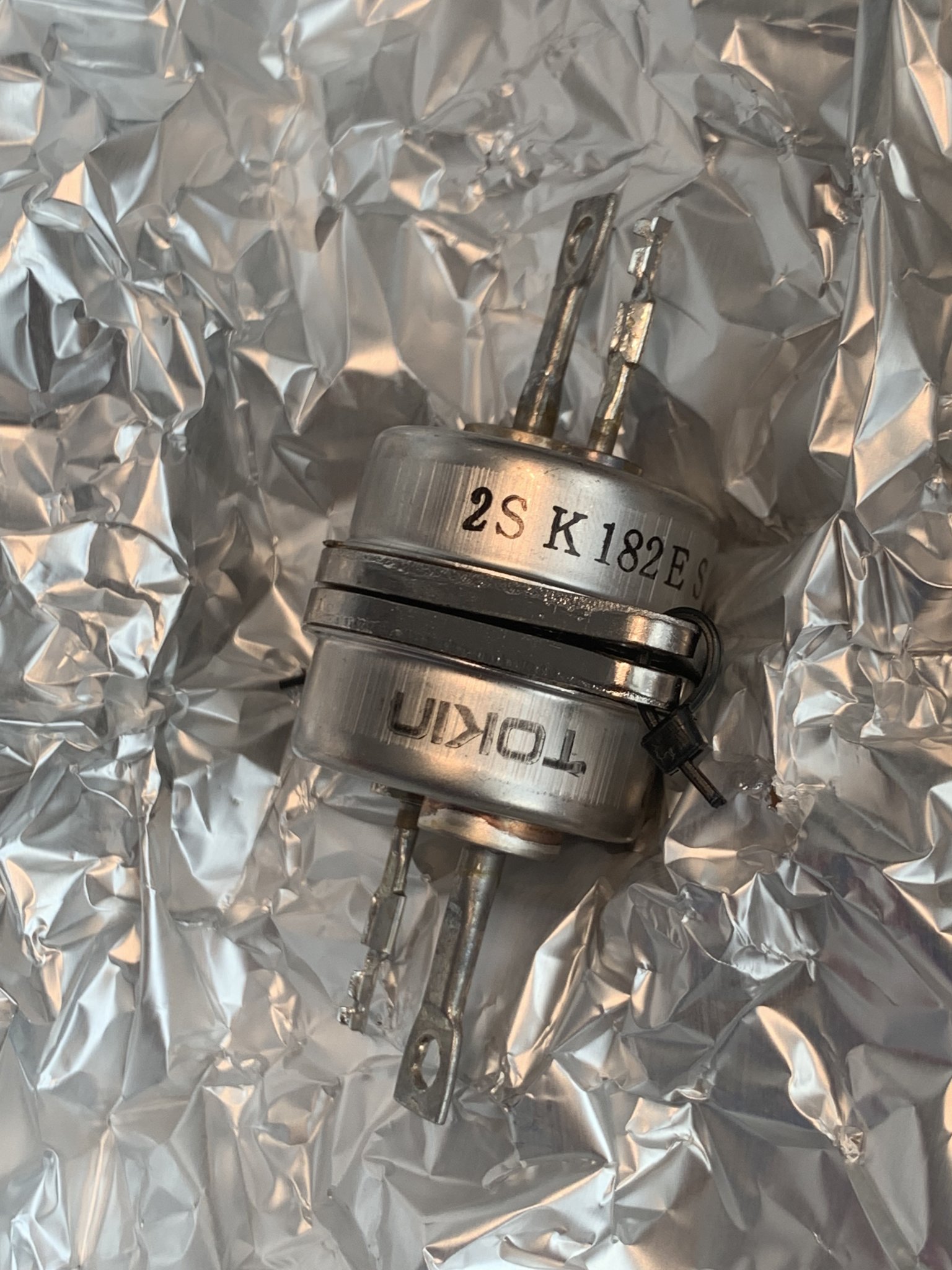

As usual being late to the party, I got some Tokin SITs (THF-51S) before all SITS disappeared from reliable sources. Impatiently waiting for Pa to reveal circuit for these Toking Biguns, I started trying to figure out what to do with them. Scouring diyA I considered all sorts of options (mostly from ZM and Ben Mah).
Follower seemed boring and a waste of this device, Active loading will be hot as hell (especially summer time in Texas). Hmm... leaning towards choke load.

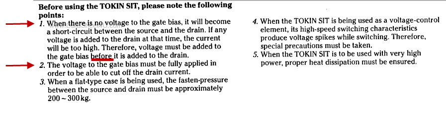

I could use the lower half of Singing Bush and done... Then I read this:
Ok so I need power sequencing. ON Bias Supply -> Drain Supply..... OFF Drain Supply -> Bias Supply

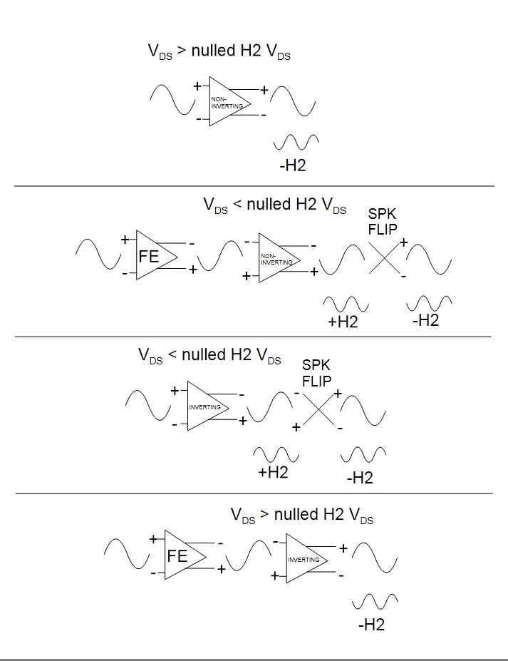

Rick, this may help visualize this H2 phase. I made this as a pictorial from Nelson's discussions of H2 phase in amplifiers and Vds adjustments.
In this case, it's example #3, Inverting Amplifier (or common source) with Vds adjusted below Vds where the H2 would null (if twiddling the Vds while watching spectrum of the amp output).
Positive phase H2 rises along with the positive going signal. So in absolute phase, when the speaker cone is moving towards you, the H2 is adding to the towards-you direction.
-H2 is the opposite. -H2 falls on the positive going signal. Speaker cone moving towards you, -H2 subtracts from the towards-you direction.
+H2 more intimate, warmer and what I call, in your face.
-H2 more spacious, deeper sound stage, sitting in audience sounding.
It's all personal preference. My examples end with -H2 because that's what I prefer.
