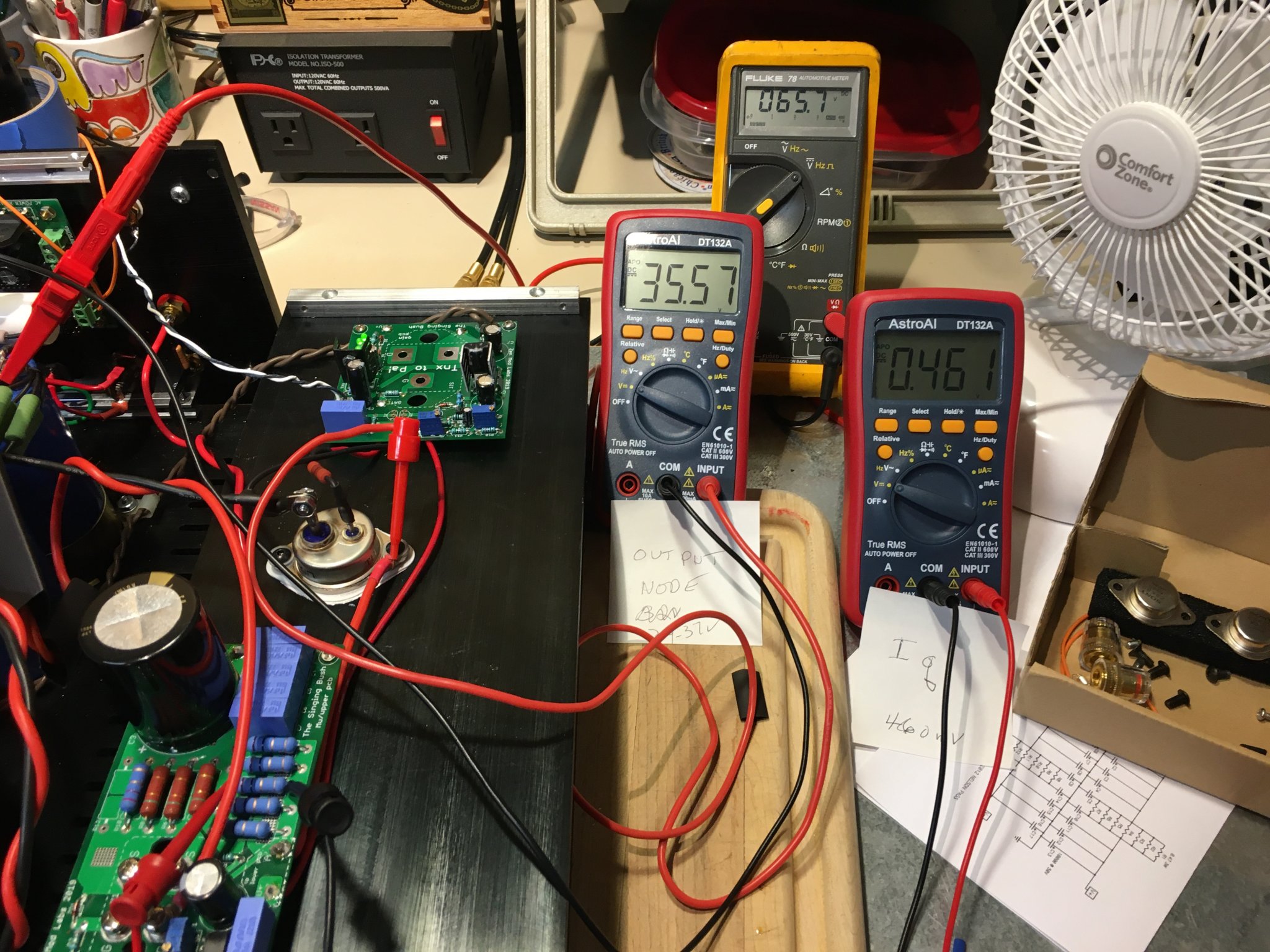

Just so I understand, the first adjustment (measured across R9 on the SIT PCB) is adjusted using P1 on the SIT PCB to 20mV.
Then I adjust P2 (red probe to SIT GATE pad) for maximum negative voltage.
Turn off everything and wait until rail measures 0V.
Connect big wire with eyelet to gate of SIT.

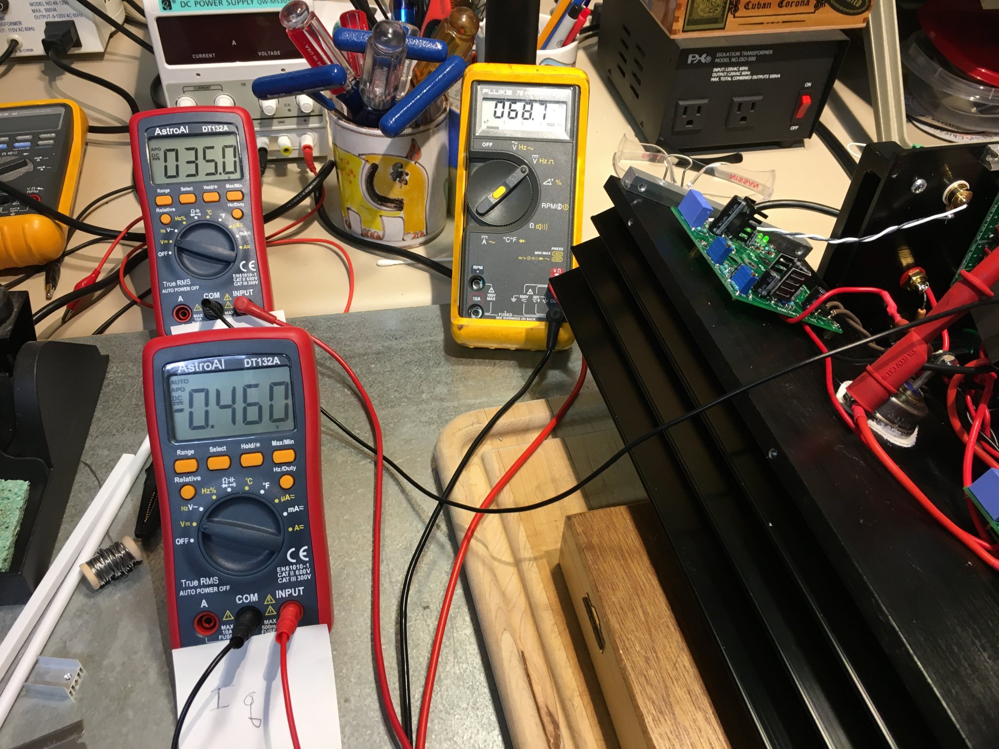

Voltmeter to SIT DRAIN (Output Node voltage), second voltmeter (Iq)across R5 or R7 or up to R13
Adjust P1 on MU PCB to 460mV
Adjust P2 on SIT PCB to 34 - 37 v.
Adjust other channel, same way!
Let it bake and adjust for 460mV and 34 - 37 v. with lids on.

it sounds proper as you wrote it....... almost!!!!!!!!!!
unconnected wire in first steps is wire going from Mu pcb to DRAIN of SIT
Yes, first part is for SIT PCB buffer Iq, second part is for SIT Iq and Output Node Voltage.

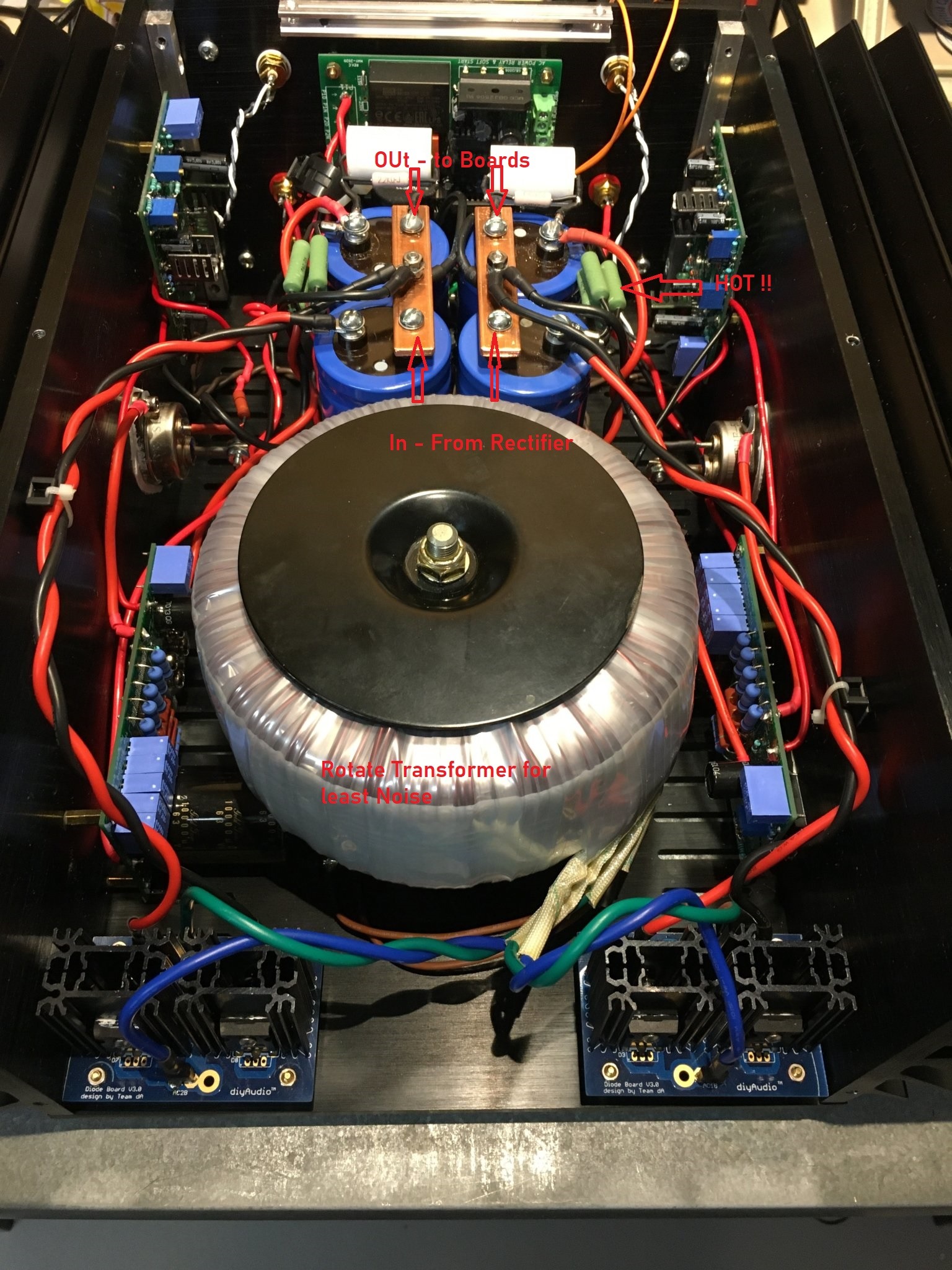

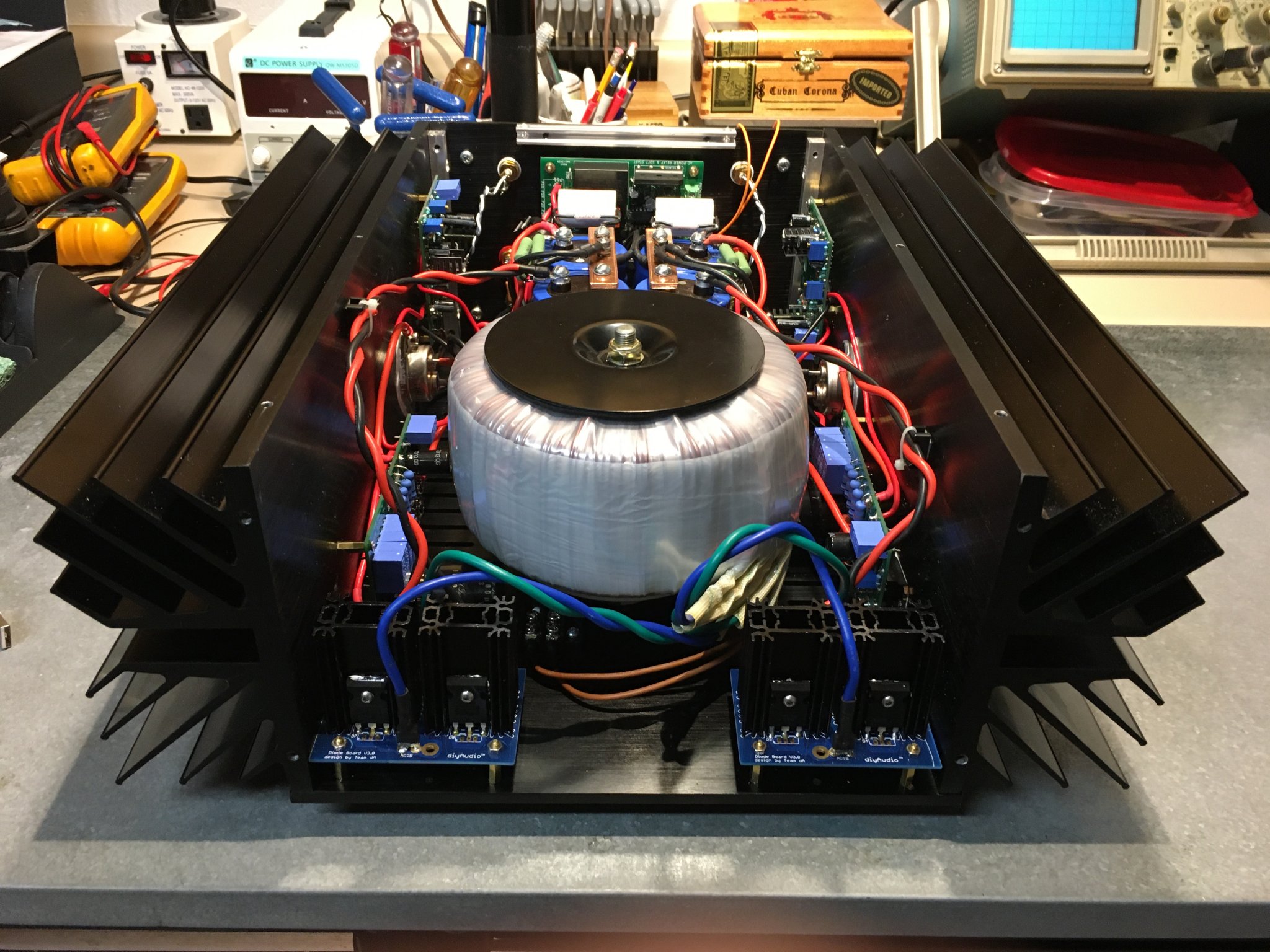

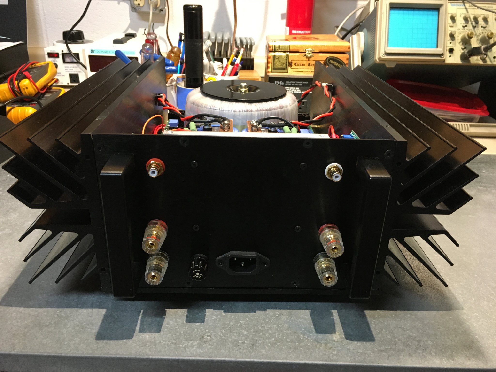

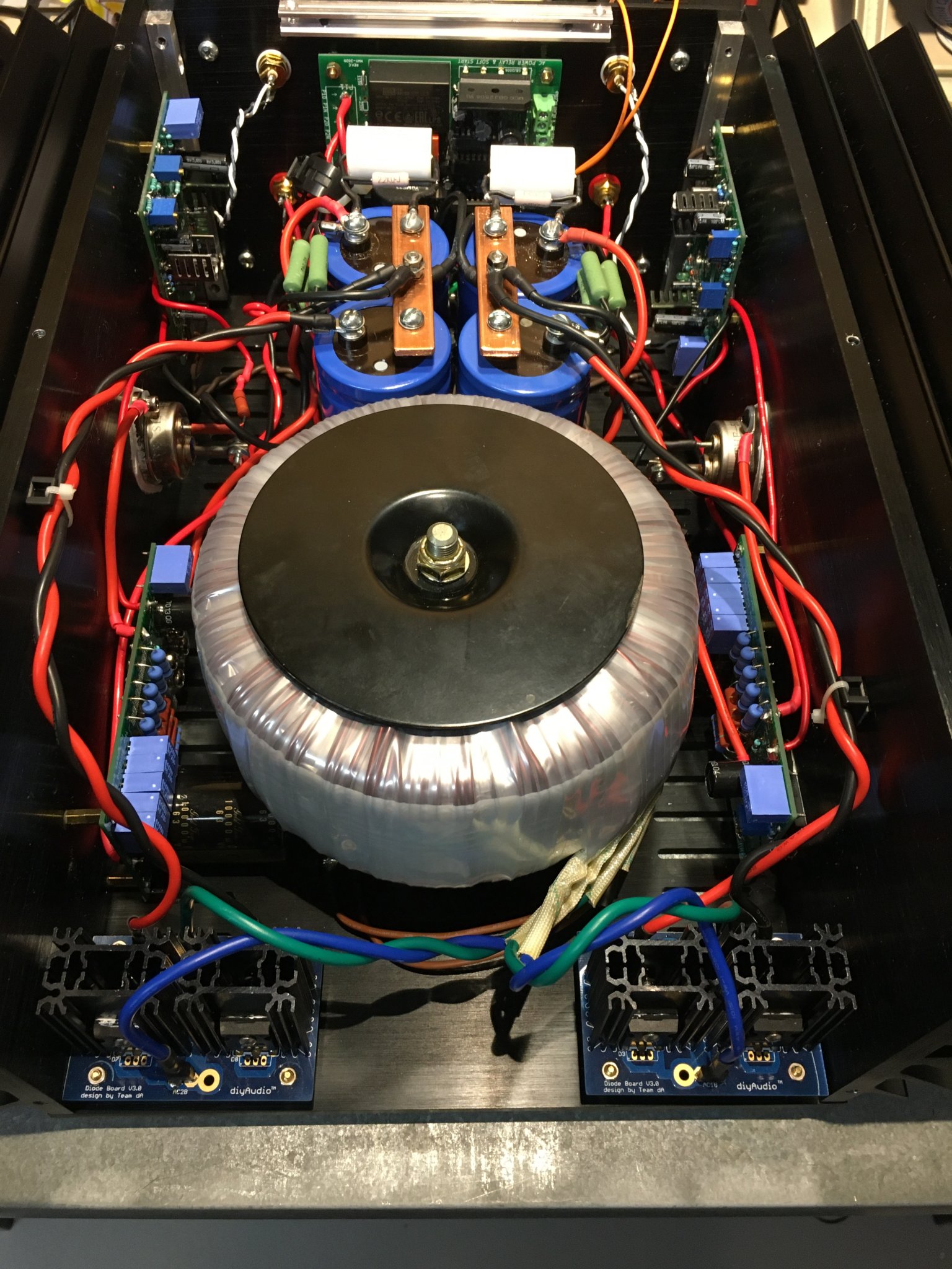

Here are some photos, I bought this enclosure last year because the heat sinks were 400mm X 150mm with an 8mm base. The inside of the enclosure is very narrow as you can see, the torroid was raised to allow the MU PCB to fit on the lower part of the heat sink. I'm using the Mark Johnson soft-start and dual power supplies using a single torroid. There are twin ground lift rectifier bridges with CL-60's in parallel between the filter caps (27K X 2 @ 80V) and the soft start board on the rear cover. The top and bottom covers are 5mm thick, the rear is 3mm and the front is 20mm.
Very tight fit!
Suggestions that might help in noise control:
- separate the Ground input and output at the power supplies
- rotate the transformer to find the position of least noise. My experience with Antek transformers is that they leak at the wire output locations. Line them up with the front and back of the chassis for least noise.
The resistors in the CRC circuit will get hot. Keep wires away from them.

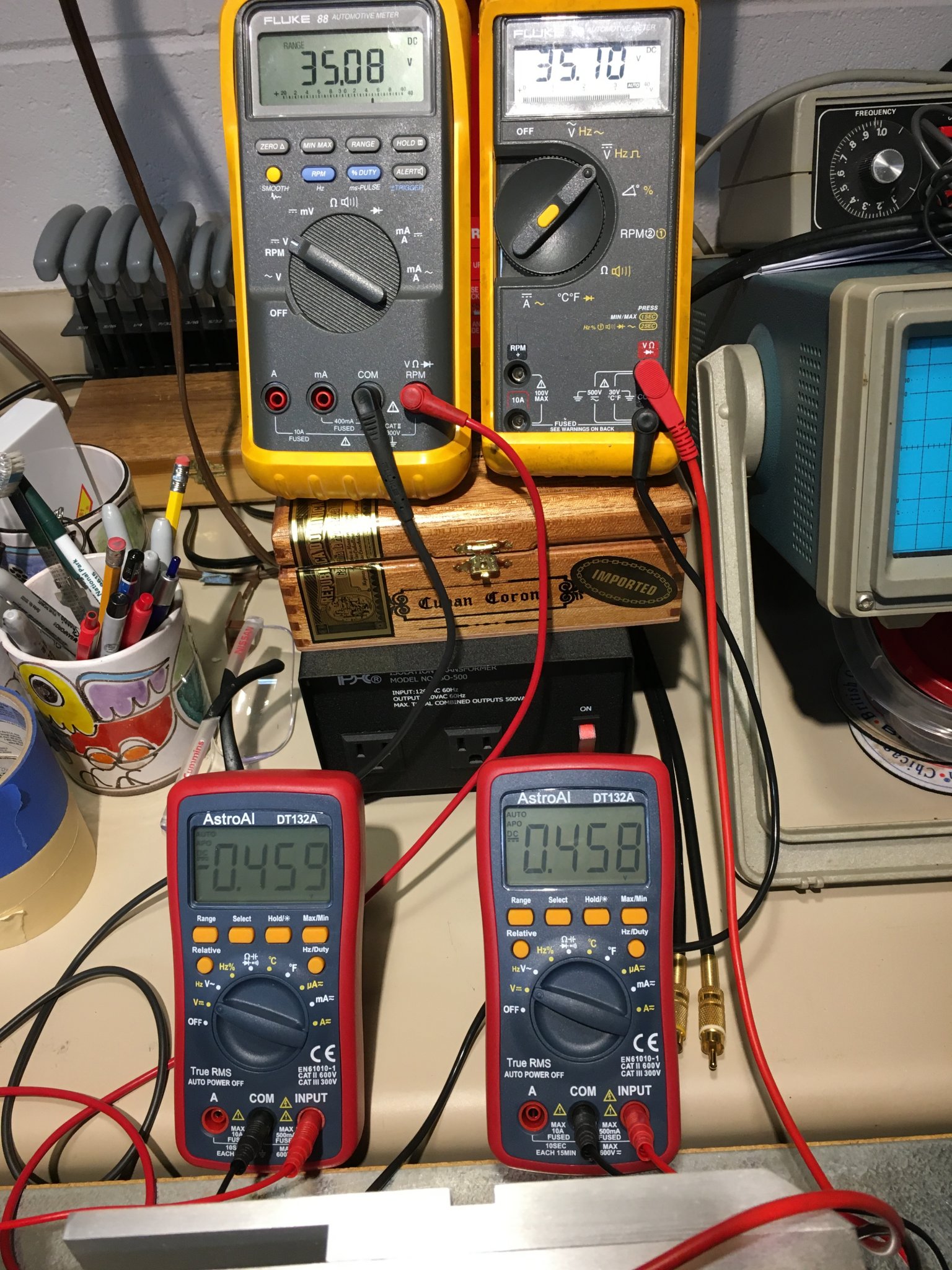

I let it bake for three hours last night, this morning I connected the DVOMs and let it bake for two hours, reset Iq and Output Node voltage. It then baked for an additional two hours, very stable.

It plays BEAUTIFUL music! I'm off as far as the proper resistor for the meter to be at mid scale, very minor. I have a slight amount of hum, I'll try Ben Mah's suggestions this weekend and try to eliminate it. I have some 1 1/2" feet on order to raise it up for improved cooling.and?
For now I'm taking a victory lap! WOO HOO!
Here is the front panel, I know it's a kind of a copy of a famous amp designer, I wanted to build a "Tribute" amp. I've built a Jaguar XKSS replica and a Fast Five Daytona coupe, I've built engines for Cobra replicas/Tributes, but I've never owned one.
So here is my version of a Pass Tribute amp by Zen Mod.
