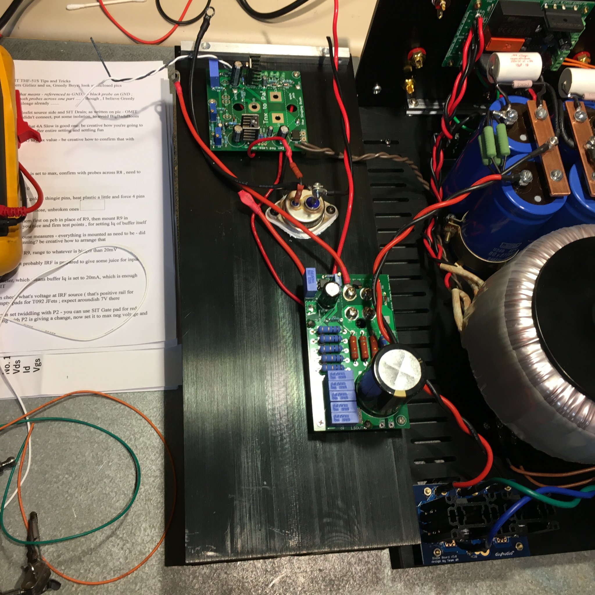

In position - 36.5 Vds 3.77 Vgs 460 mV

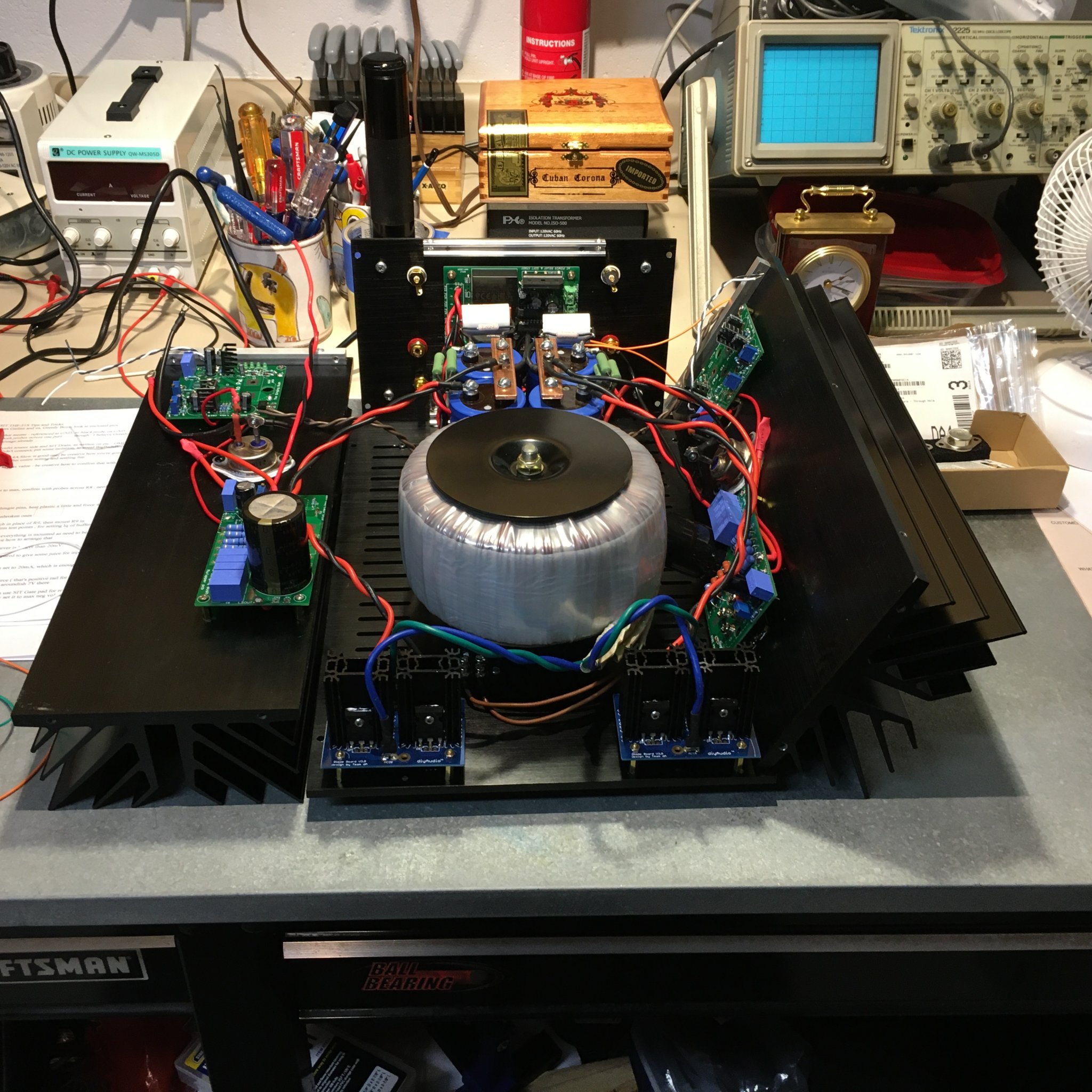

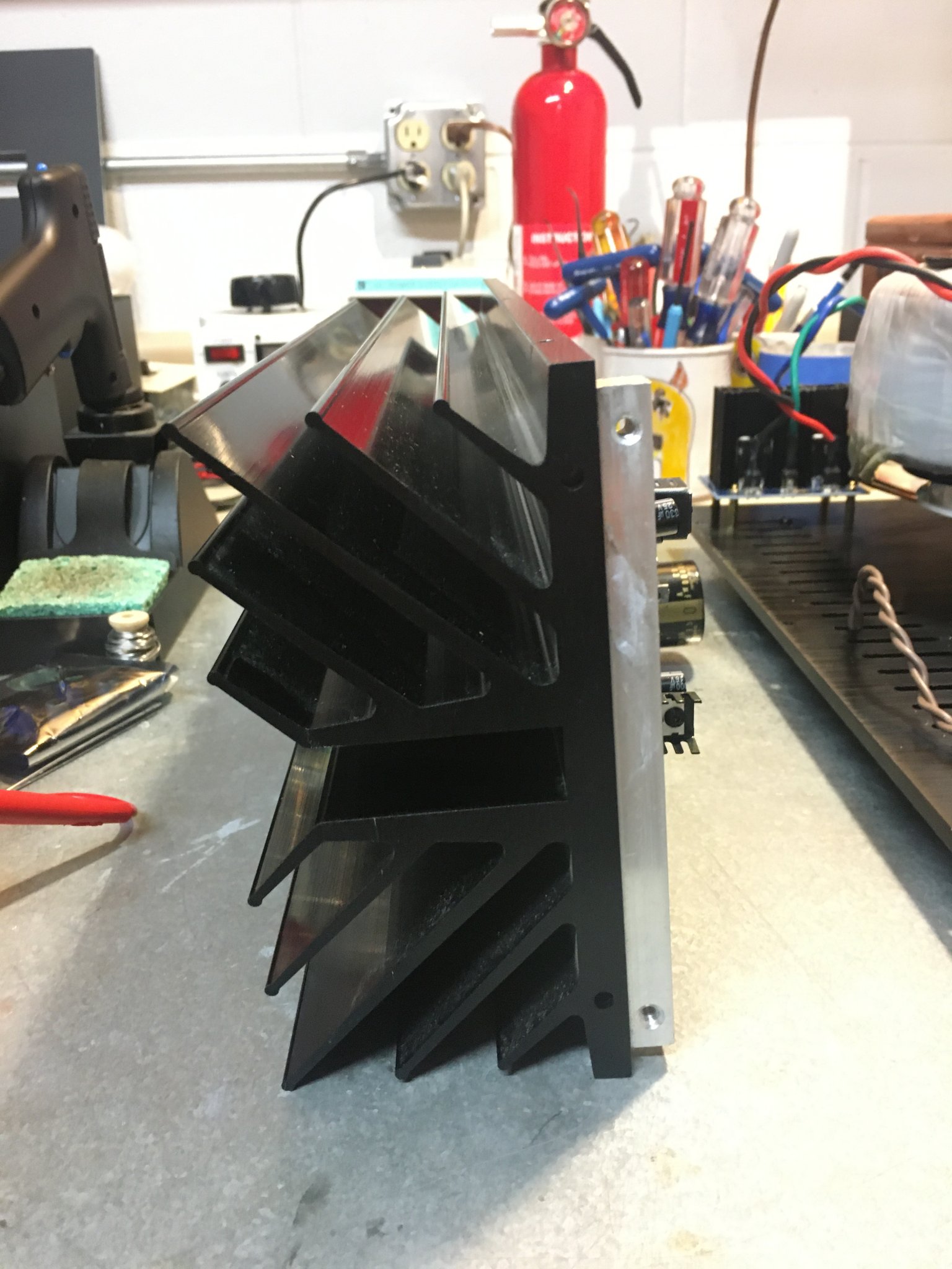

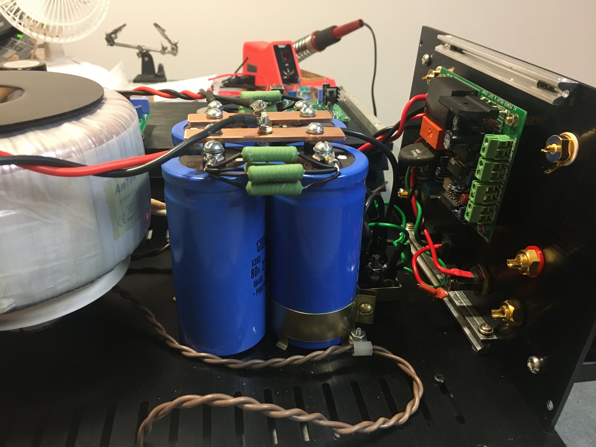

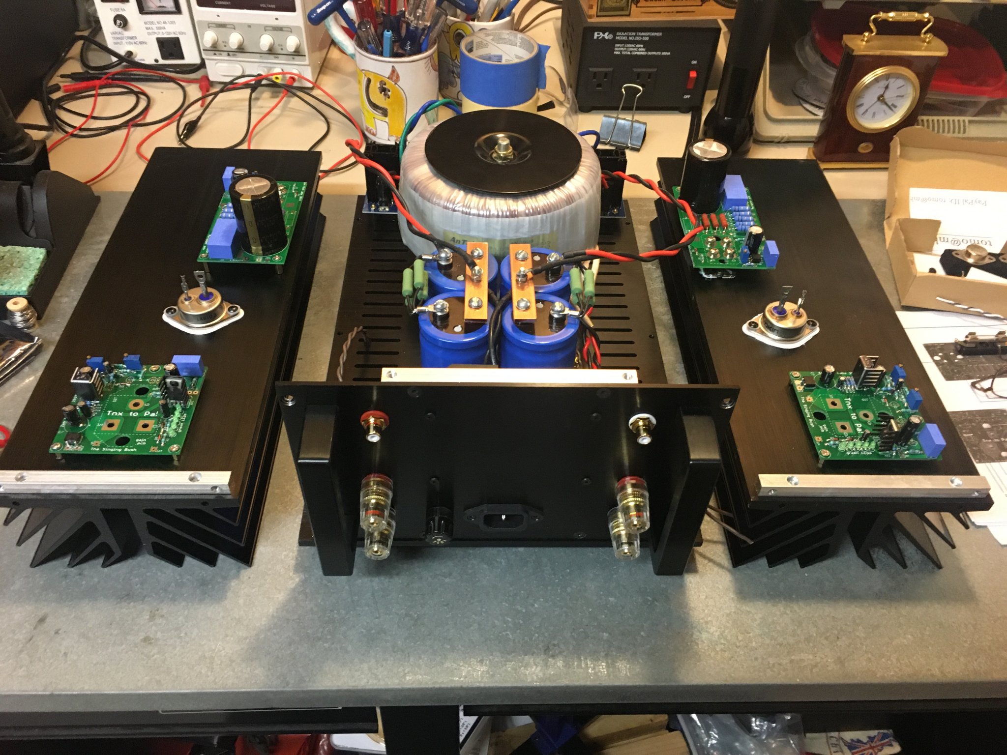

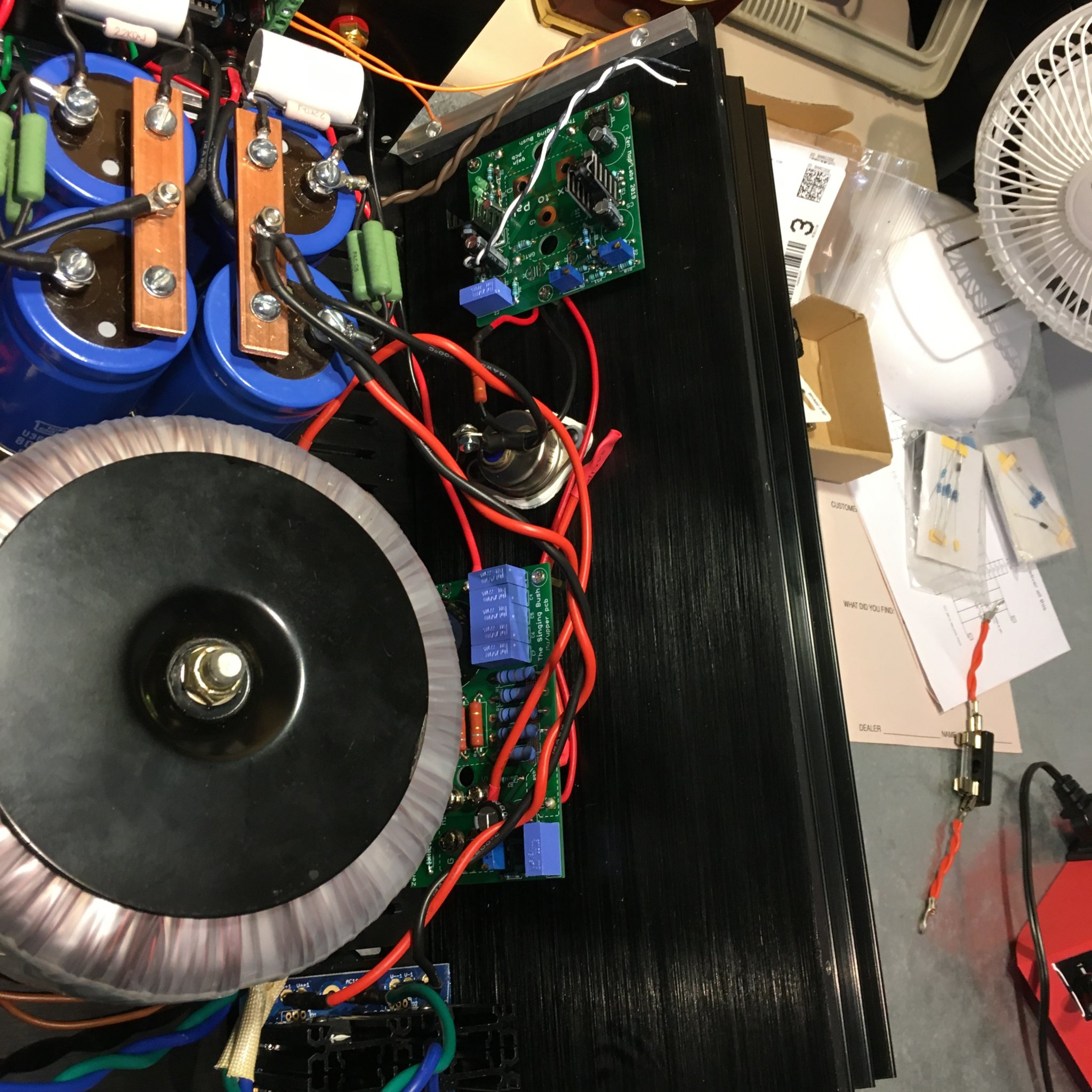

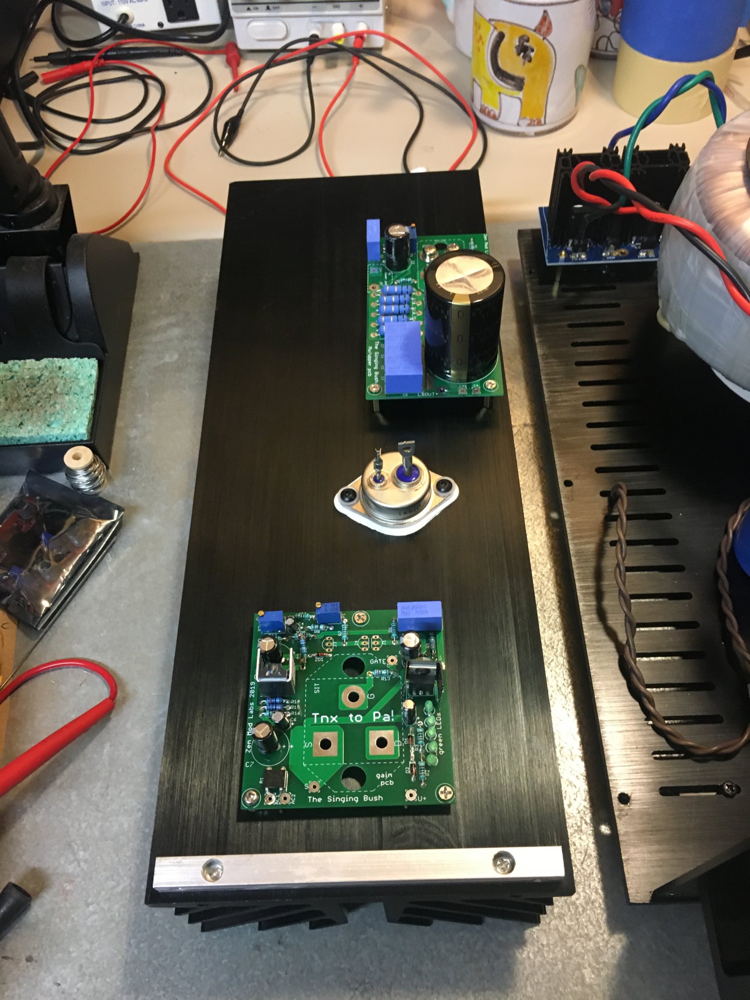

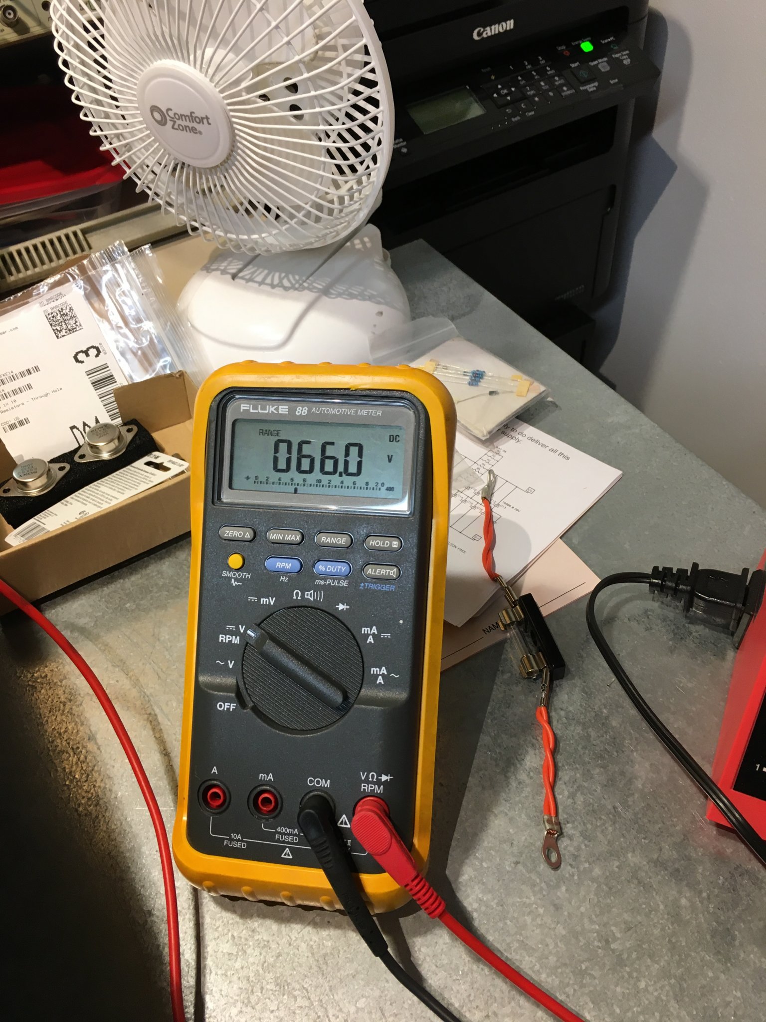

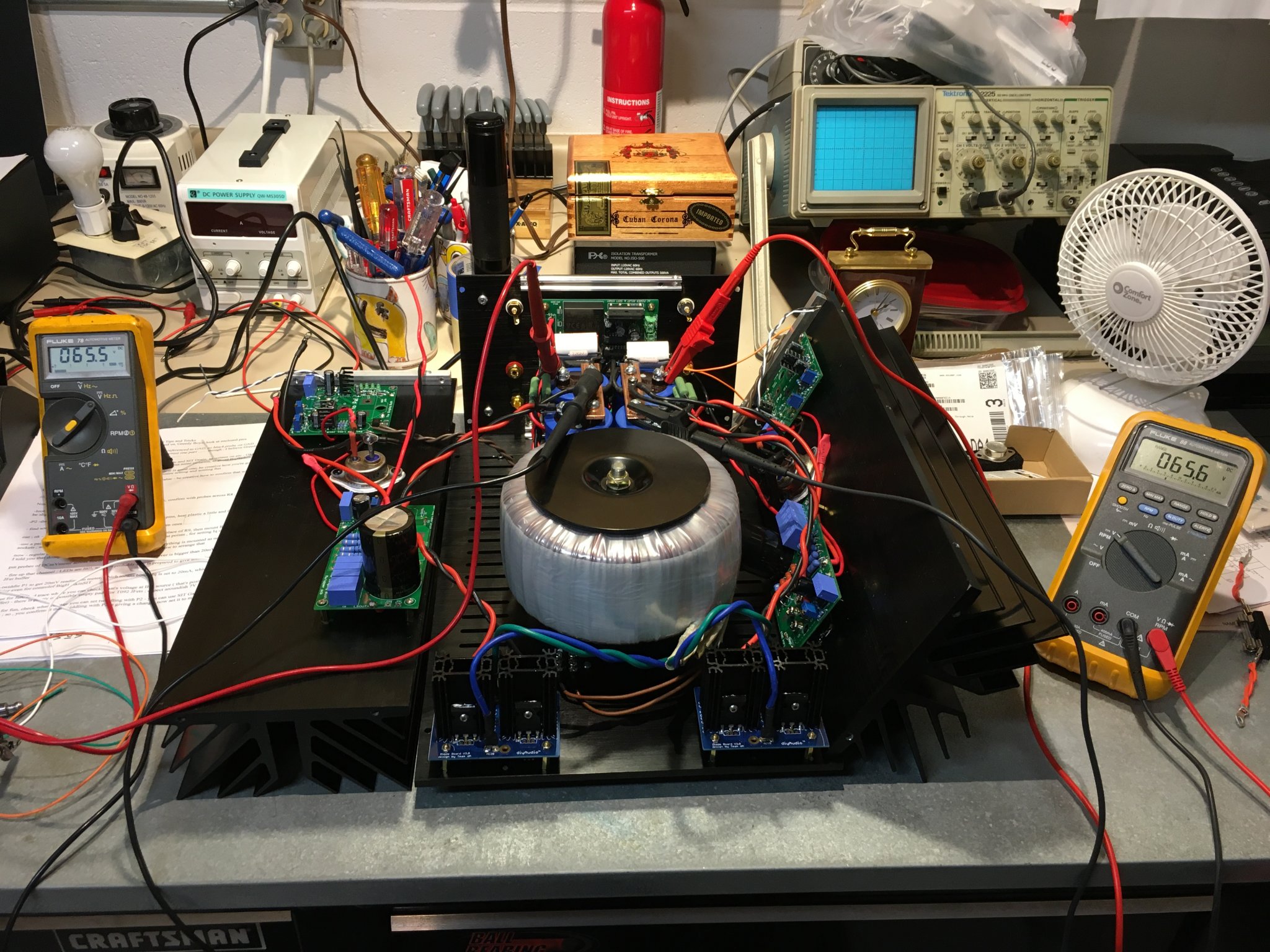

Moving along with my SB-SIT amplifier, finished the power supply today, no load is 66VDC. Dim bulb tester was used during the first tests, no issues, I'm using Mark Johnson's soft start board, works great so far.

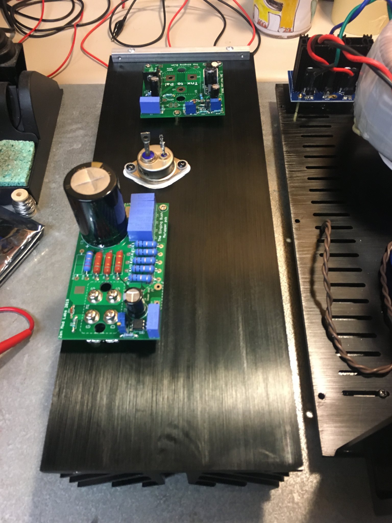

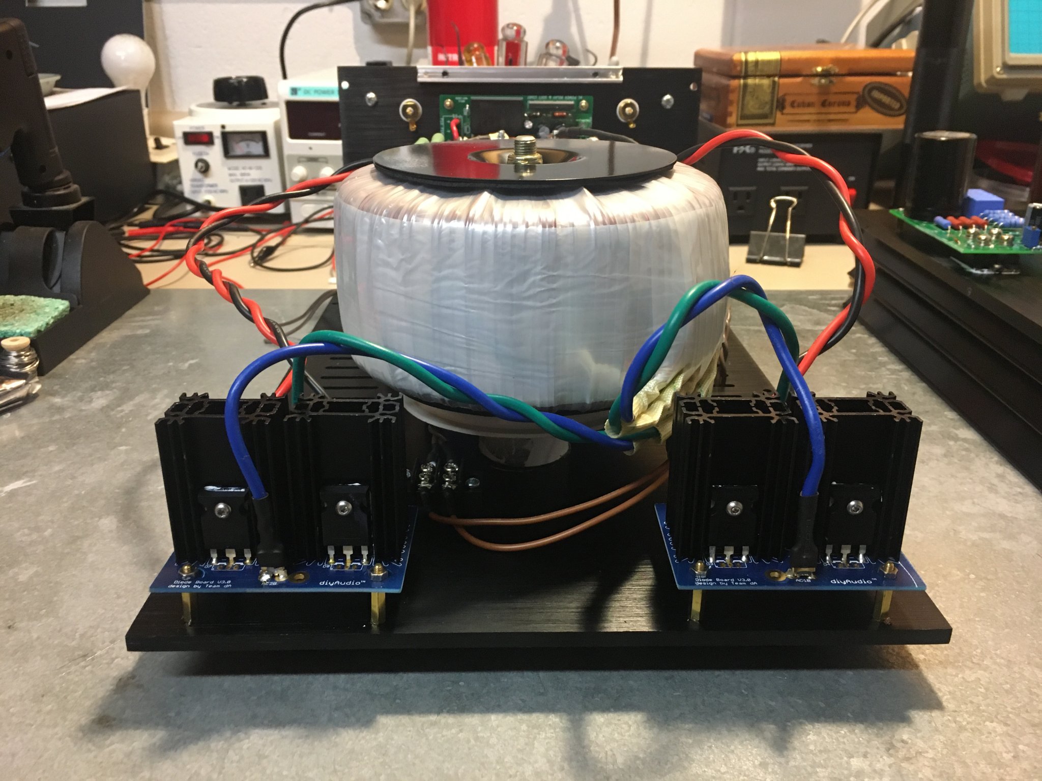

The heat sinks are drilled and tapped with the PCB's and SIT installed, finished the wiring of the boards and I'm ready to start the biasing procedure.
First some pics:
First some pics:

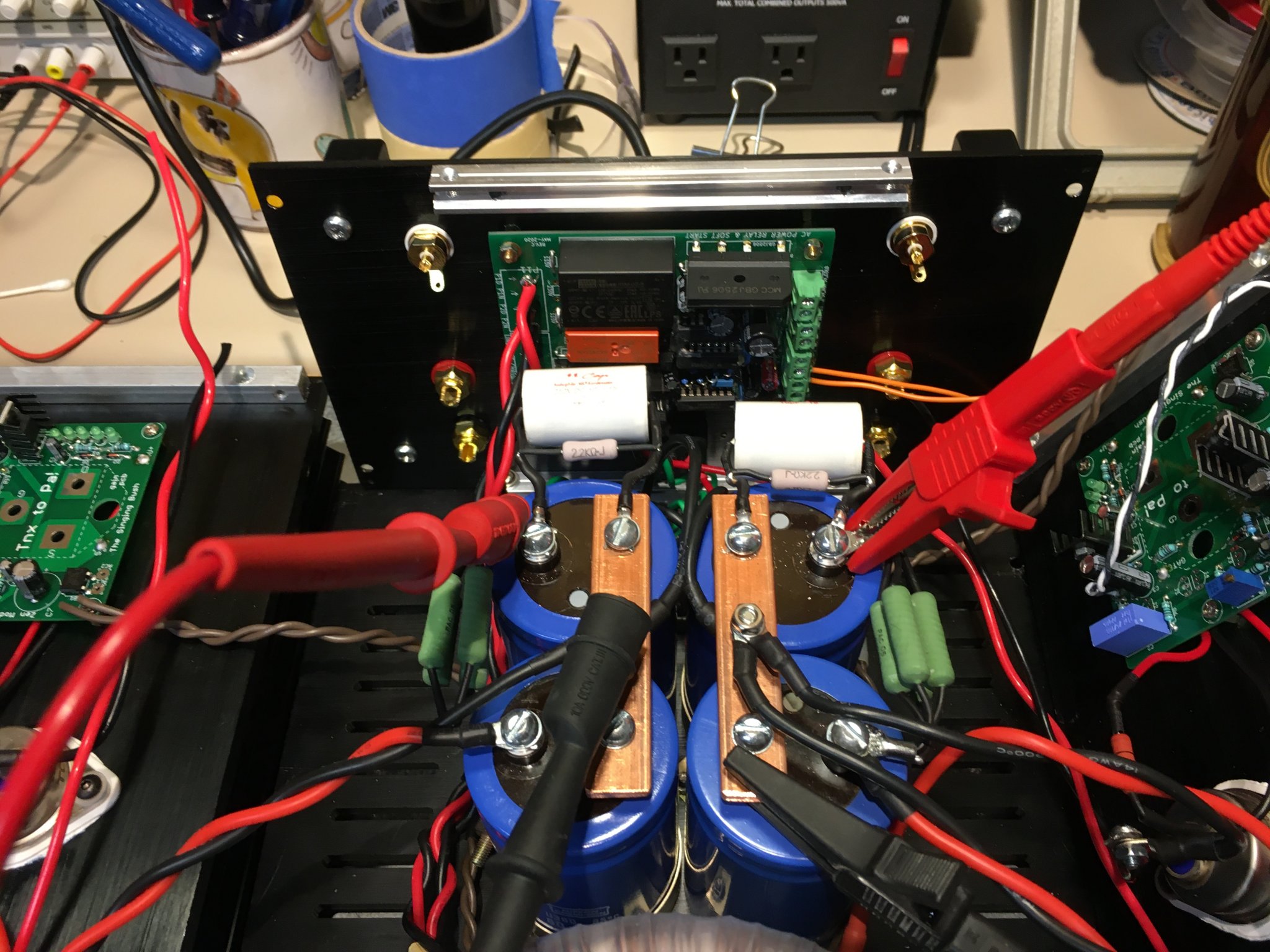

Last of the pics, first of the dumb questions:
1 - Do I need to have the speaker outputs connected with the 470 ohm resistor during the bias procedure?
2 - Should the inputs be shorted?
I have to connect the 15vac wires to the upper PCB and then the inline fuse (3A slo-blo) on the 60v rail and then I should be ready unless someone sees another mistake I made.
1. Yes
2. Yes

Next dumb question, on the upper/mu PCB, there is a spot on the PCB for C*,C** referred to in the schematic. It is marked as additional solid cap, motor run?
I don't have room for a large motor run cap, what value and type could I use instead?
Or is it not needed?
there is enough place for small caps on pcb already
motor run is cherry on top........ and you can use these pads for separate smaller cap, if you want to put separate speaker posts at back and biwire to your tweets
