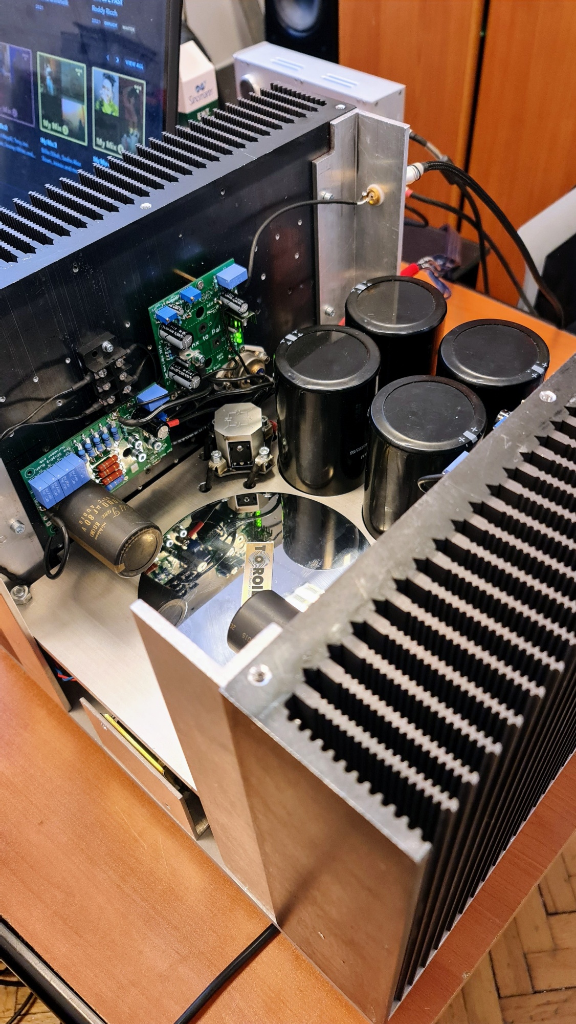

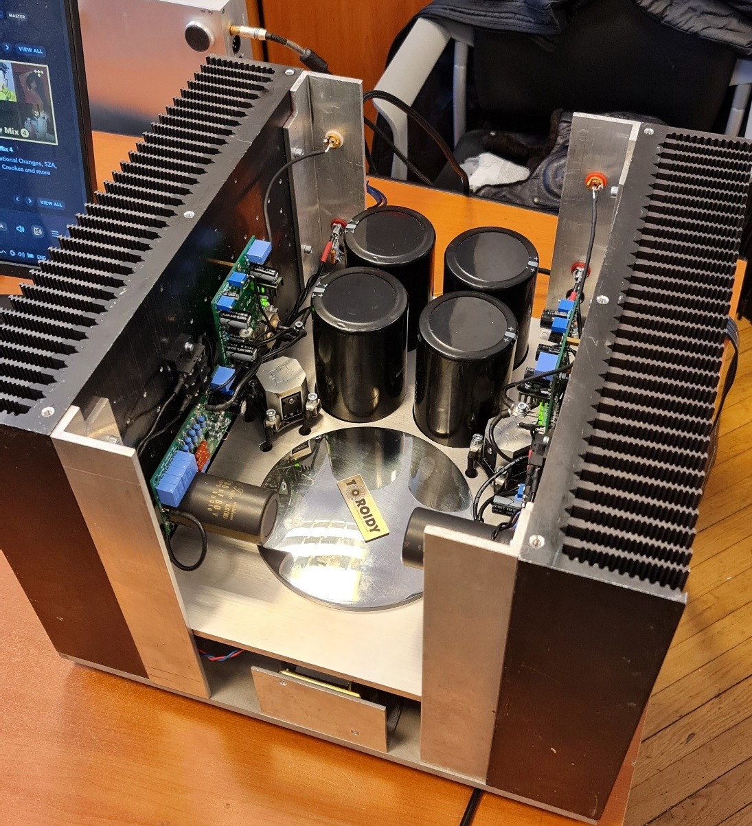

Finally, I finished Singing Bush 😊
At first I wanted to use a single 50 V / 1000VA transformer for both channels but I couldn't beat hum.
I switched to a Toroidy 2x 50V / 600VA and now I have dual - mono.
The amplifier is completely silent and with a sound as I expected, I really like it 😉
The radiators are 300 x400 x84 mm, after an hour they are at 50 degrees C.
Thanks to Zen Mod for this wonderful amplifier and for all his support!
