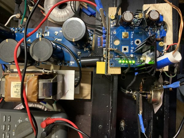

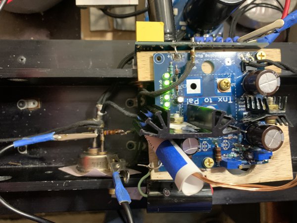

Here are a couple of photographs of amplifier #4
... more evidence of my photographic ability.

EDIT CORRECTION: This is not the amplifier I am having this trouble with - it is #1.
