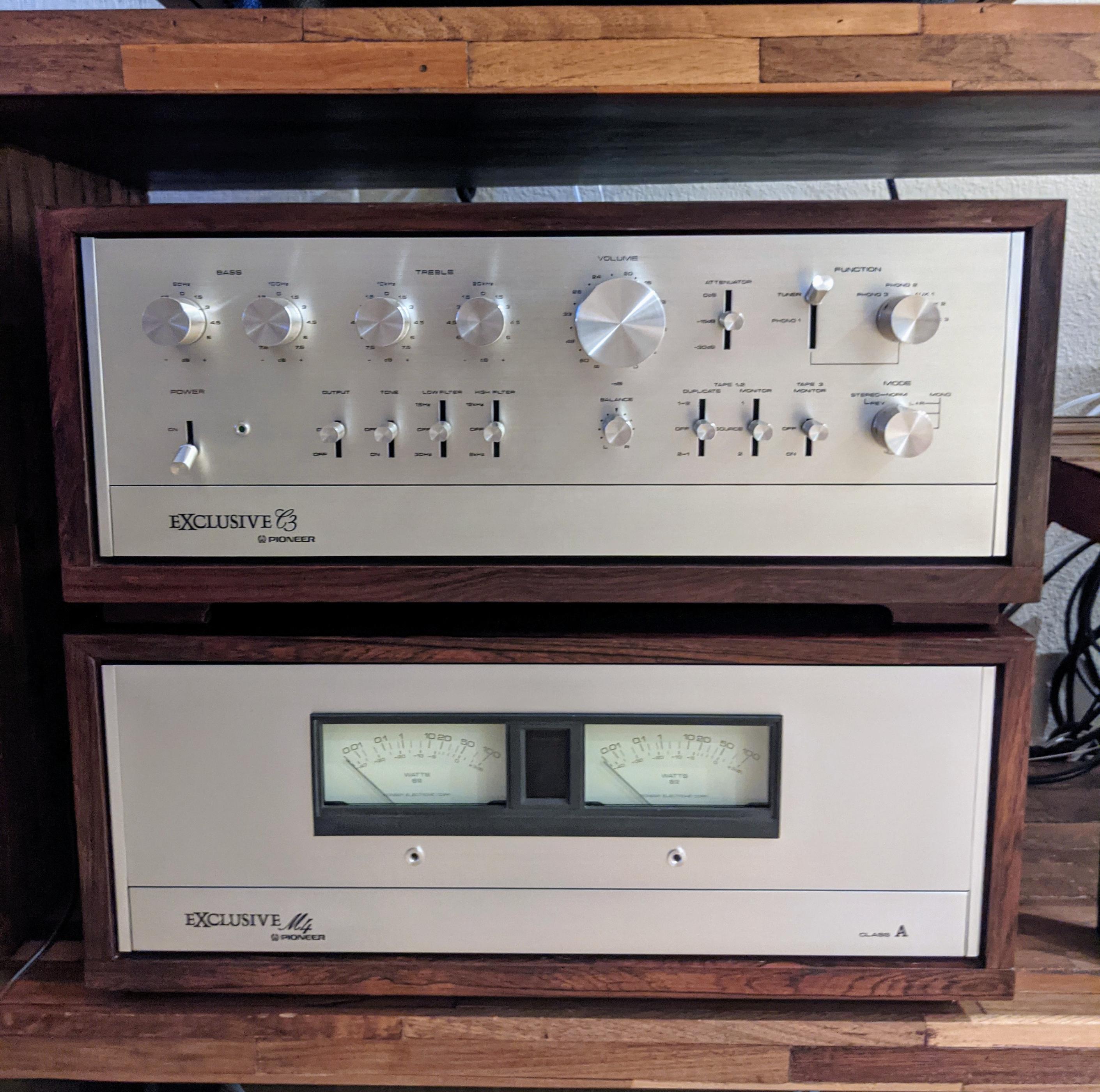

Isn't there at least one benefit of a metal chassis -- RF isolation? Acting as a faraday cage should remove some unwanted interference.
Maybe the inverse is also true -- amps sound more "boxed in" when boxed in. 🙂
P.S. - speaking of chassis design, these Pioneer Exclusives were my project last year (servicing). My wife and I both love this aesthetic and craftsmanship. She told me if I ever feel like selling it, she'll buy it off me lol.
This was built decades before I was even born -- I just find most of the modern designs boring and uninspiring... Maybe it's just a case of "what's old is new again"
