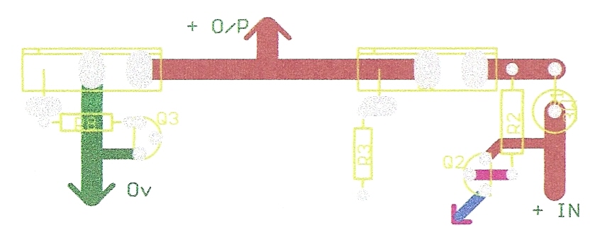

The simplistic Salas low voltage shunt regulator
OOps, upside down. Sorry about the faint yellow for component outlines - it takes theis layer directly rom the original library specs - will change this later, too.

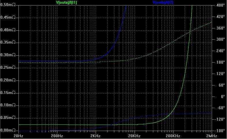

No, that would be true if it was just a pass series open loop element. It feeds current to a shunt regulation loop that reacts by BC550gm*collectorLoad. Its the reaction that governs. The mOhm regions of output impedance for such shunts are real. Not as low as in sims due to layout, wires, parasitics, etc. but really low.

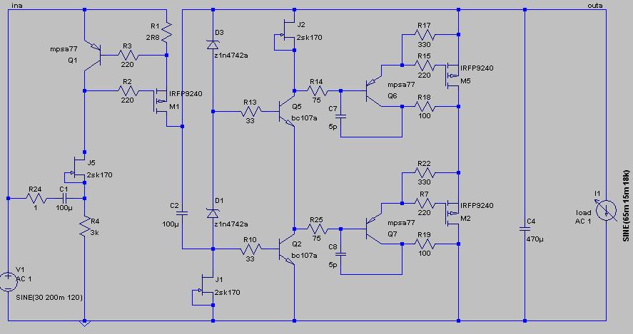

Improved deluxe v2
And just when I thought I should give up on design improvements and start getting real, this comes up. The deluxe bleeding edge v2 edition, for those who can afford an extra few components. Scalable too, I think.
Output impedance compared to already the excellent v1. We're talking about 25 microohms in the audio band, and less than 100 microohms at 200kHz.

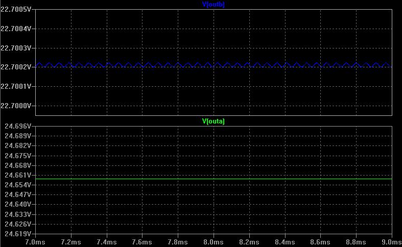

Check out the output voltage with 30V DC, 200mV AC input, and a sine active load of 65mA DC, 15mA AC, 18kHz (to test for load varying in the higher frequency audio band).

Just when you thought it was safe to get back into the water!
Hi Ikoflexer,
I am eagerly awaiting your book on shunt regulators......😀
I guess you would call a cascoded shunt, first one I have seen....cool.
I have one thought, have you considered replacing the shunt element with a complementary pair and would there be an advantage in doing so?
Keep up the good work.
Jam

Yes, good idea, I have thought of it but couldn't get it to work acceptably. At the moment I think I can live with this shunt regulator if it works as a real circuit. If so, I am curious if other people will see a noticeable sound improvement; my ears I don't trust, I'm afraid.

We've got people working on pcb layout for the original regulator, and I'm currently working on a layout for the experimental versions as well. I would not want to give you any guarantees that this or that is better than I don't know what. It's small parts count and easy enough to build to see for yourself if it fits the bill.

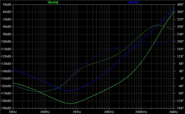

As far as the PSRR of various opamps, watch out for not so good performance in the higher frequency range, even within the audio band. Attached is a plot of line regulation for the salas v1 (blue) and the experimental version (green). In the fantasy land of simulators these are not very shabby results.
