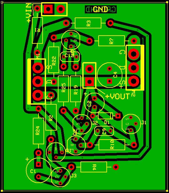

James has sent me a couple of files to upload. You can see components side and the particular schematic he based it on. The handwritten numbers are his changes on component numbers so to have a more logical order. Ignore everything left to C1, since that stuff is simulator's. He provides for a bootstrap cap damping resistor (RC), Jfet or resistor divider (J1/R4), a socket for Zener reference or whatever with the Vref arrangement you may fancy, plus an Rs option for local feedback to the shunt Mosfet, doubling as a means to check its current. His explaining comments will follow soon I guess.
I think that BC560C,550C are CBE and must be reversed, but this can be easily done until the final copper side file. Please review for other stuff or suggestions to James.

Good start guys!!! A few comments, some of which you can safely ignore.
* my first concern would be the pins on the irfp9240. In my datasheet it shows as G D S, 1 2 3
* the mosfet gate resistors, as close as possible to the gate, even if it looks ugly
* the signal path, in -> out, should be as straight as possible; this helps with higher frequency response
* C2 can be safely smaller
* should C3 be closer to the output?
This is it for now.

Yes, James must correct along with the BCs.
Salas said:How do you heatsink m1 without obstruction especially in heavier settings?
Yes, good catch! It would, and I'm still trying to push things around to come up with a better solution. This is very preliminary, just started on it, playing with ideas.

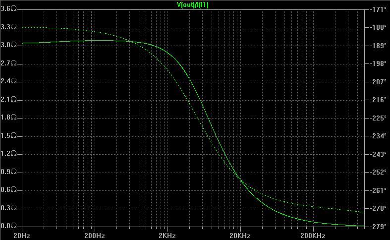

Sorry Ikoflexer
You obviously didn't measure the output impedance of the last circuit I posted.
Or if you did then maybe I have stuffed up my own measurement.
Could you tell me what you get just to be sure I am doing it right?
