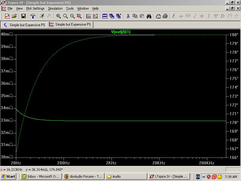

Yes, that's what I got too. 33 milliohms almost all across. If you're happy with that then I'm happy too that you're happy. It could very well be that I'm chasing wild geese here. BTW, we got lots of geese here. I love how they gaa-gaa around the city. Many people don't like them because the s**t all over the place. As far as I'm concerned, I say long live the geese!

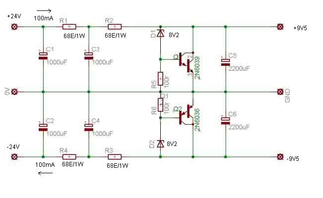

If the max dynamic current draw of a preamp is 100mA then couldn't you bias it for 500mA. Then the draw from the powersupply would never change from 500mA.

First things first. As far as I'm concerned, if you have questions, I see no reason why you should not ask them. salas said earlier something that a lot of people forget: these forums are here for some time, and people come after years something was posted, and learn something from your question or the answer to your question.
Now, about your question regarding the class A amp that draws 500mA at idle. You are assuming that this is a constant 500mA. The word "constant" is the key here. In real life it will not be as constant as you think. If it varies somewhere around the 500mA mark, and the psu output impedance is on the high side, the input voltage to your amp will vary too. By how much, that depends. Do you care about it? I don't know, that's something everyone has to decide for himself. Have you noticed something about salas? He seems to accept a circuit if it makes an audible difference. A lot of people will scorn this as subjective. I disagree with those people, because I think it's salas' right to decide for himself what sounds good. And it's your right to disagree. So, if you intend the regulator/psu to be part of some device that you ultimately will listen to, the ultimate test is to actually build it, listen to it, and then decide if it's worth it. Sorry to be long winded about this.

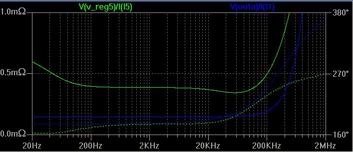

I was checking out another regulator which is being worked on currently. It is an interesting shunt regulator too, and I was trying to help with its development a bit earlier. Today I managed to run it next to v2 and this is the output impedance plot.
We should not read too much into such plots, but v2 does look promising.

A tiny bit worse with the irf9540. Here's something that surprised me with v2. The 9240s seem to work quite a bit better in this circuit than other mosfets. Even more of a surprise: using a darlington to drive the mosfets (both) gives a significant boost in performance. In particular I tried mpsa77. And this is while all other features stayed about the same (meaning it didn't start oscillating).
Edit: 9510 a lot worse (20-30db worse); 9610 also worse, but a bit better than 9510. Does it surprise you? Because it does me. In v1 9610 actually seems better (if I remember correctly) than 9240.

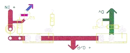

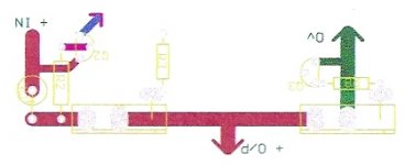

' morning all, or evening to most!
Sorry about the faint outlines for the components and the invisible donuts - I'll fix this today and also correct those transistors Q2, Q3.

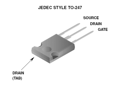

The power fets (IRFPs) seem to be okay (g, d, s - left to right with metal back down, legs towards you, yes?) - I think the offset pad for the Gate is misleading and when the drawing is corrected, it'll be much clearer - the pcb is intended to mount parallel to a vertically heatsink (case, chassis, etc) and has 2 x 10mm standoffs at the bottom - the IRFPs have long 14mm leads that just bend UP to directly solder onto the copper.
You can also mount them on the same side as the other components, but need to bend the IRFPs away from the pcb edge to give better access to the output + terminal - it's quite suitable for the "Neutrik" pins (stripped down power connector pins) but IS a bit limiting and I'll do something about it, too (bit slow these days!)
Okay. The size of the board is 70mm x 30mm - a lot bigger than Peter D. would make it, but this is just a "starter" layout.
The IRFPs are 40mm apart.
... and the components that'll be most often changed need extra room and perhaps also extra donuts for when the first ones suffer soldered lift off!
The socket and plug are for ease of changing the zeners, particularly useful for those of us that require precise voltages. It's that Weidmuller device (same as the Phoenix ones) that has the screw terminals (so the larger size) - it can overhang the R3 and I'll squeeze ithis up later.
The caps are sized to 10mm with 5mm leads - not sure if this is enough, as I tend to go BIG! I remember Jan Didden emphasizing the fact that a very "bog standard" output electro is most useful here but I still sized them to suit the Elna Silmics and this should cater to most types. I have a Siemens Sikorel (axial cap standing on it's end) on the output and I do prefer the sound, and stability hasn't ever been a problem with this reg,

Iko, thanks for the BC transistor error. Don't hesitate to be "really critical" (really) about any errors/faults and especially design flaws.
Also,not entirely happy with the first power reistor R1, either, and I'll thicken up the ground track (to 4mm wide) for C3 to the 0v o/p terminal.
Don't forget, folks. this is Salas' cct design - I'm just the dummy here playing "pcb Sudoko"!

James, as you look at the board from above, G D S in that order. The last pin, S, should be connected to R2; you have D connected to R2. The other mosfet should also have the connections to pins 2 and 3 reversed.

I think it was somebody else that pointed out the bc error. It's ok, these are easy to fix. I think your effort to get the pcb in place is important. We all help how we can.

Ahhhh!!! The IRFP 9 240 penny finally dropped! And it's not even Friday!
This will require some contemplation - as you can see, I'm also rather good in the stupid department!
I'll see what "this ol'magic box" can do to fix it - I'll get back with some corrections. (And I was so pleased with how it all just came together - ah well, not any more, eh!)

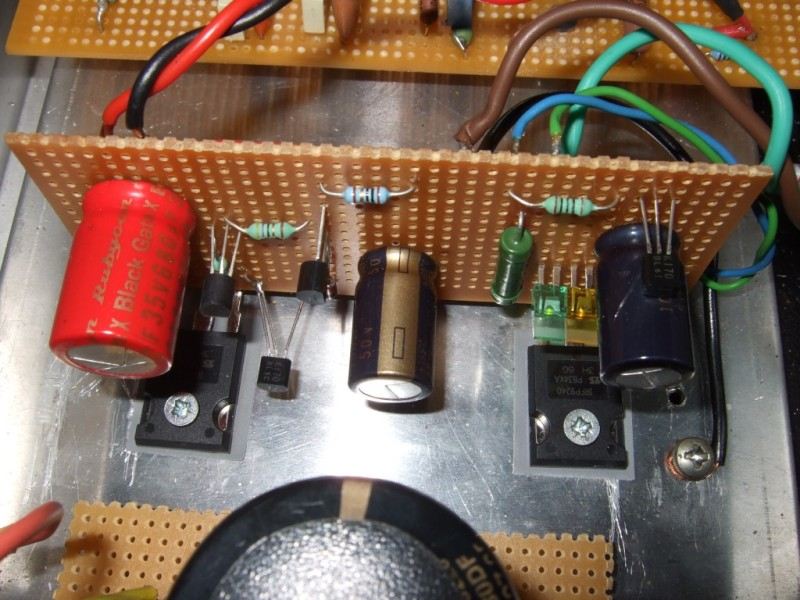

Perhaps this will make you feel better. My first pcb for the original salas regulator, in a different thread, had two pins reversed on the mosfets. 😀 It's easy to happen.

No worries mate.😉 Just flip it at your leisure.😎
pcb adjustment
It seems that turning the Pfets around offers the most promising compromise, although I'm less confortable with the different layout direction. Just added the two BCs for confirmation.
