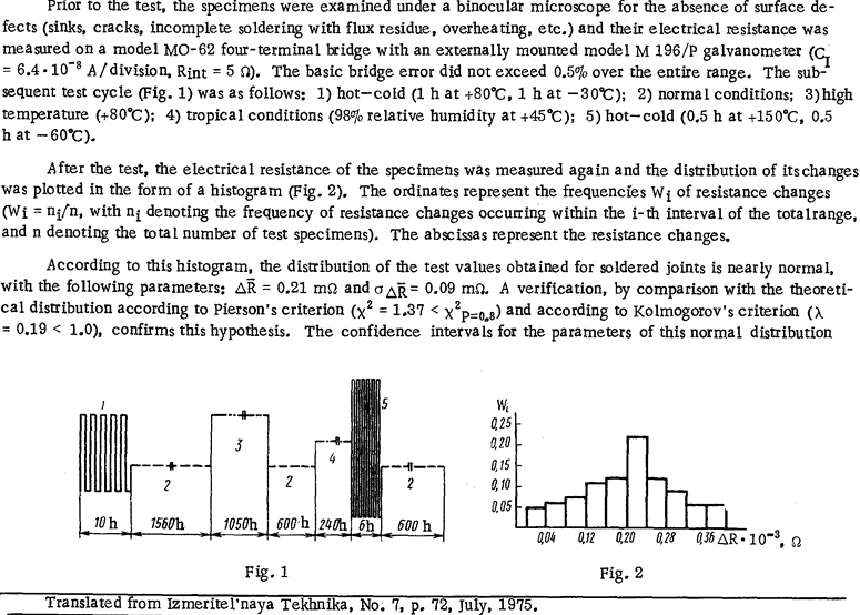

I was just thinking, we are now at a very low output impedance is their any benefit in trying to lower it further (unless it also brings other improvements), as one contact can easily be 3mOhms (Neutrik Power Connector), a soldered joint is also in the milliohms http://findarticles.com/p/articles/mi_qa3776/is_200511/ai_n15845704/pg_2/?tag=content;col1 ?

thanh, I would hope for sub 1 mOhm solder resistance, but maybe I'm just dreaming. The attached excerpt talks about 0.2 mOhm on average.
