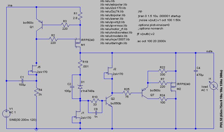

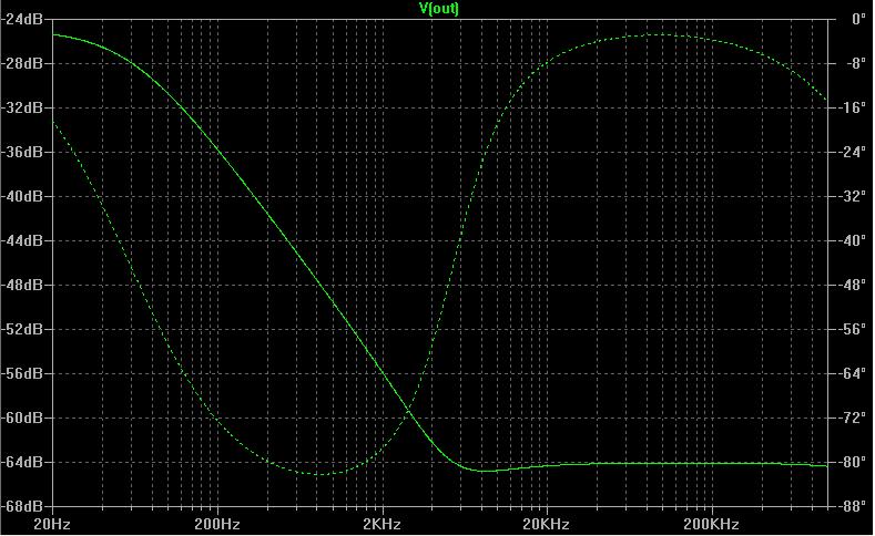

As an ongoing slightly separate thread, I have been trying to widen the output impedance bandwidth with no ill effects on the other desired parameters. This is the topology I am converging to, not yet refined. More tests need to be done, of course.

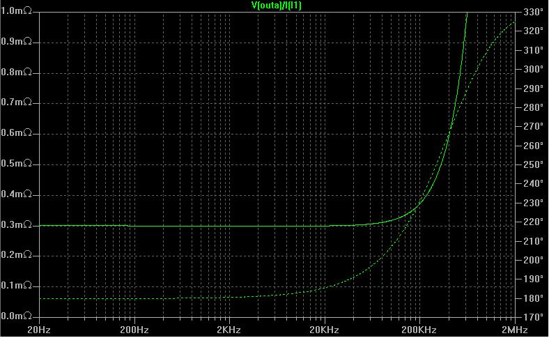

The output impedance.
This version does not need to run a large current through the shunt mosfet to achieve the low output impedance, which is good. It also seems stable.
Comments/suggestions appreciated.

jwb said:Nice result ... but is it stable?
I usually do my best to make it unstable in simulation, before building it for real. Saves time, of course. So, I've been putting this circuit through quite a few tests and it is stable in simulation. Do not pay too much attention to the exact size and configuration of resistors around the mosfet, those are not refined yet and will change. The topology though, seems promising, and this was what I was looking for. We'll see if it lives up to its promises.

Salas, I agree that trace or wire inductance can obviate improvements in output impedance (or induce phase shift leading to instability). That's why I recommend integrating the regulator right on the board with the load, instead of trying to build a regulator on a daughterboard connected with wires and terminals.
A reasonable compromise is to build the regulator on a daughterboard, but attach it directly to the load with soldered pins.
Yes, good points guys, thanks! I've started, as a habit now, for every new variation to run a battery of tests that try to address several issues that may plague a regulator. Regarding trace resistance and inductance, I add small inductors (which have series resistance too) to the circuit at various places in the circuit and then run various simulations and observe the effect. Many of the results I don't write here about because of lack of time. I also think I should spare most people the boring stuff.
Now, a few particular comments. Both the original circuit and the experimental V2 are very sensitive to trace resistance and inductance. Both circuits can be stabilized with and extra one or two capacitors. Both circuits suffer equally (proportionally) as far as output impedance goes from trace parasitics. The moral of the story here is, pcb layout is crucial to get in real life performance that has any semblance to simulation. I've said it before, but allow me to repeat. The traces around the shunt mosfet are paramount to get right. It's probably best to use smd parts as much as possible there. Trace parasitics in that area show large detrimental effects in simulation. I can only imagine how bad it is in real life.
I will start building a prototype v2 when I'm reasonably satisfied with the simulated tests, and will report.

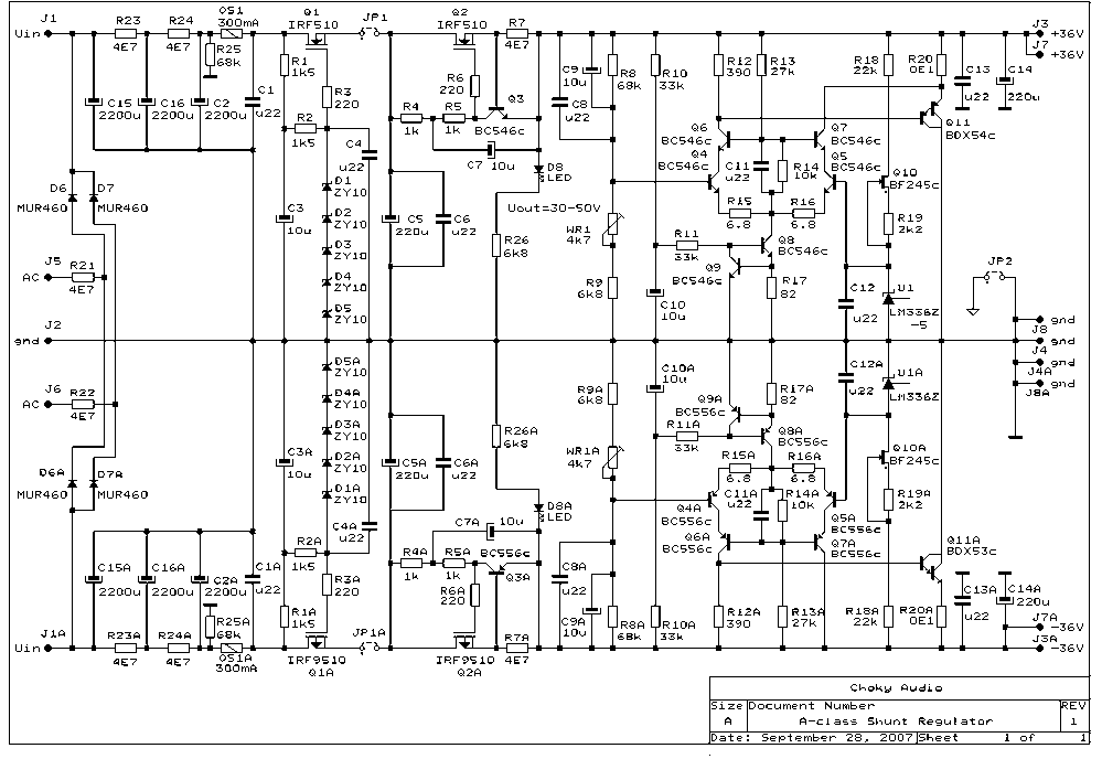

There is a lot to be learned from Salas's design...............but the way it is going this thread will have to be renamed The super complex Salas low voltage regulator.
Let's hope it does not start to resemble the regulator below ............ with all due respect to Chokey.
Jam
Jam

Is this a trick question? BTW, it's very easy to run this sort of thing, you should try it, ltspice is free.
Edit; I realize you're probably running ltspice already. I guess I don't know which test to run on this circuit. What would you like to find out about it?
