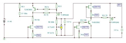

Since you stick with TL431, why not use a trimmer for lower resistor and have a variable Vout? Comes handy I guess.

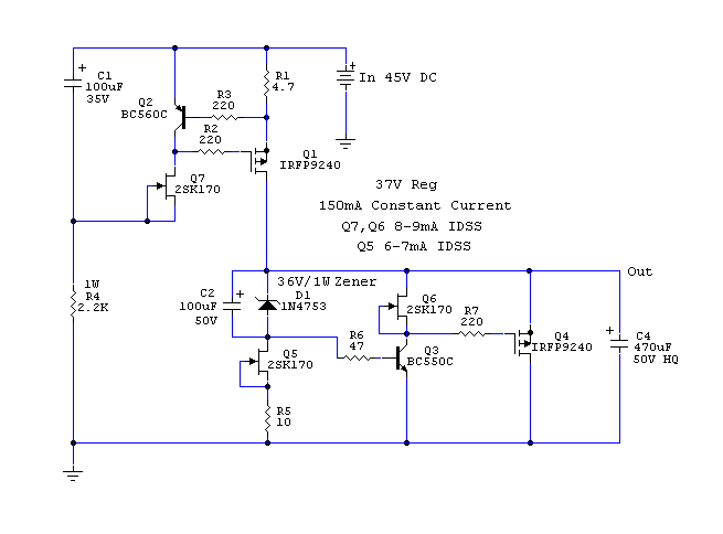

That reg shown is just my regulator but with TL431 Vref. Its obvious. And I just call it ''Simplistic Low Voltage Shunt''. It has been reported good enough by many who made it with a Zener. Both for practical noise with Riaa or other audio, and subjective sound. Now why with just some different values and another Vref can be called ''No Noise'' it just escapes me.

As I wrote above, what is really needed is a nice PCB design. Vref options are easy to include too. I think if using a TL431, Vout variability is a great add on.

Hi Lumba Ogir - could you please explain some more about the virtues of this TL 431 Vref regarding low noise.
Salas says he got it but so far I did not get it
cheers
mike
As a bandgap device it owes to be noisier than LEDs or avalance Zeners people explained in that noise thread I linked. Its good thing is temperature stability. Also low impedance, being a shunt device. That helps PSRR. Plus its variable. My idea was to use a single Zener (above 12V I have only made or seen made, except JWB's 9V one that used a low quiet Zener (away from bad transition zone) plus 3 smt LEDs.). He had to, since he would be bang on worse Zener choice else. To help the low impedance and PSRR thing I used a low pinch off IDSS CCS to be able to work right under Vbe margin, for the rather high voltage/impedance Zeners. In practice it worked fine. And its capacitor bypassed.
