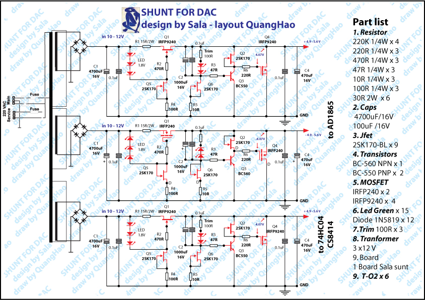

Can you post it 25% bigger, and with CCS IRFP9240 symbols as in the middle one? On the other two they look like Jfets and maybe someone will be questioning. Plus put the word trim in the middle 100R above 2 leds too? What Sala, means in Chinese? There is a tune by Pupils aswell. Make it Salas if you can on the scematic.

Salas,
Thanks for your great work. I like it (v1). It is so simple to implement it, given it is a shunt regulator.
Correct me if I am wrong. The same circuits / parts will work with different voltages and current demands, and only D1, R1 and R5 need to be altered to suit specific requirements, but nothing else.
I am sure the information has been given before, but considering that this is a long thread I have not had the time to read through the entire posts, would you mind giving the formula to calculate the required voltage and current, a formula of just D1, R1 and R5?
Bill

Forget R5 & R3, its a lift that does something transiently.
ICCS=(Vf3Leds-Vgs)/R1 Decide target current, derive needed R1.
Vref=VfD1+0.6V=Vout Can be Zener or Leds. Measure their Vf at about 6mA
add them up in two matched strings for +/- regs
