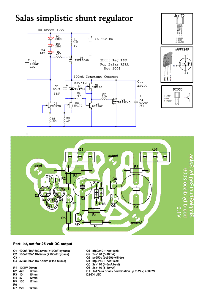

The simplistic Salas low voltage shunt regulator
It will stress the ccs dissipation if in heavy shunt when going low and having Tx for high. In a light current shunt, cool. Gives an adjustable one. Have said to jameshill in an old post again. Maybe with 2 seconadries and a switch for them & resistors?

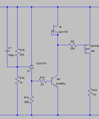

jkeny, if you get to read this, and if you really want to use the tl431, here's how (see attachment). You'll need to change the values of R16 to get the voltage you want on the output.

OK, let's get down to business. Have a look at this, it comes with a nice layout too, due to one very talented member here.
attachment.php
R1 sets the current limit (total current passed). The total current will be roughly made up of the current drawn by the load, plus the current through the shunt mosfet (I'm just ignoring the vref current now). You can set the desired voltage output with an appropriate choice of zener diode. Input voltage should be about 10V above the target voltage. There's a negative version of this circuit too, but I don't have it handy, maybe when salas wakes up 😀 (he never sleeps really).

The zener can be a 1N4744A. I would not remove that cap. V1 has been extensively tested and tweaked by people with good ears, and the consensus is that the cap is needed. My noise measurements confirm this. But best is to make your own mind.

About heat sinks. The inherent workings of the shunt are such that the more current the load draws, the less current will go through the shunt mosfet (the mosfet that passes current to ground). The CCS mosfet, the one after R1, passes a steady total current all the time. The IRFP9240 and IRFP240 are TO-247 devices, they can dissipate quite a lot of heat if properly heat sink-ed.
Have a look at these two.
Edit: this is V1

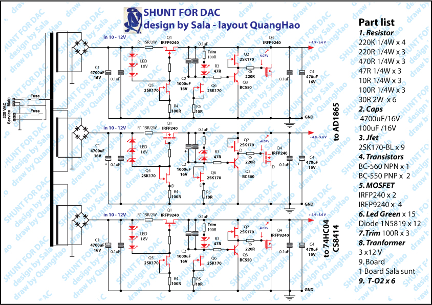

Thank Salas and Ikoflexer !!!
to day I finish the Salas shunt for my DAC!
I think It is very good, and wonderfull, I draw again cricuit, anh I make some
board!
I use tow LEDS and Trim change to zener! That is better!
thank you again!
QuangHao
Great draw quality schematic. Thanks. Seems I got a new nickname in the Far East.😀
All the guys who want a DAC 5V version may refer to this. Endorsed for visual clarity and optimum Vref. The 100R in series with two leds is a trimmer.
The resistor in the CCS IRFP9240 is the 470R.
