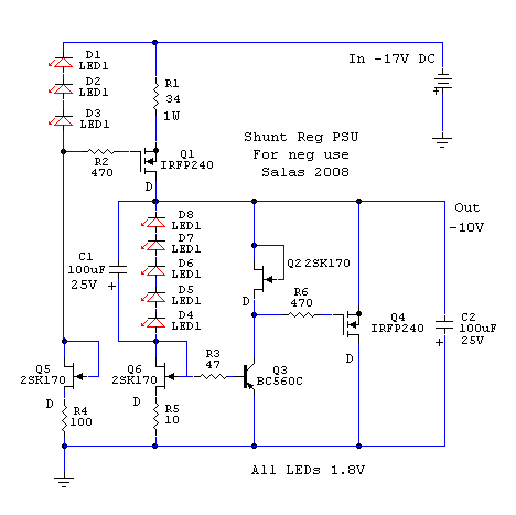

Could you please kindly supply the schematics / parts for both the + and - 15VDC rails for a single OPA627 buffer? Actually the rails can be anything from +/-12VDC to +/-15VDC.

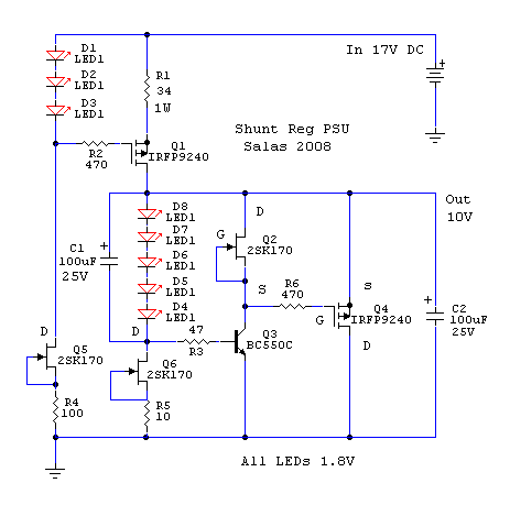

OK, let's get down to business. Have a look at this, it comes with a nice layout too, due to one very talented member here.
R1 sets the current limit (total current passed). The total current will be roughly made up of the current drawn by the load, plus the current through the shunt mosfet (I'm just ignoring the vref current now). You can set the desired voltage output with an appropriate choice of zener diode. Input voltage should be about 10V above the target voltage. There's a negative version of this circuit too, but I don't have it handy, maybe when salas wakes up 😀 (he never sleeps really).

Thanks, Iko. I am totally unfamiliar with parts. Which zener to use to give 15V?

And am anxiously awaiting for the schematic for the negative supply.

The zener can be a 1N4744A. I would not remove that cap. V1 has been extensively tested and tweaked by people with good ears, and the consensus is that the cap is needed. My noise measurements confirm this. But best is to make your own mind.

About heat sinks. The inherent workings of the shunt are such that the more current the load draws, the less current will go through the shunt mosfet (the mosfet that passes current to ground). The CCS mosfet, the one after R1, passes a steady total current all the time. The IRFP9240 and IRFP240 are TO-247 devices, they can dissipate quite a lot of heat if properly heat sink-ed.
Have a look at these two.
Edit: this is V1

I need a schematic of Salas V1 for my DAC which require +15V at 68ma and -15V at 43ma.
I have a two dual 15V transformer already.
I would be gratefull if you have any equivalent schematics for me.

Yes, LEDs in series with the zener shouldn't be a problem. For schematic, see my post before yours (post 1191). That is V1.

Don't use a 9V zener, its one of the bad noise zener region. Use 7 - 8 red leds instead. Match them and see how near 15V they get you. Polarity of leds is the same as the 3 leds go in above schematics in each positive and negative shunt. R1=15R 2W is enough current for your application, +/- 150mA CCS. 6R8 runs it above 200mA with most leds. Not necessary.
