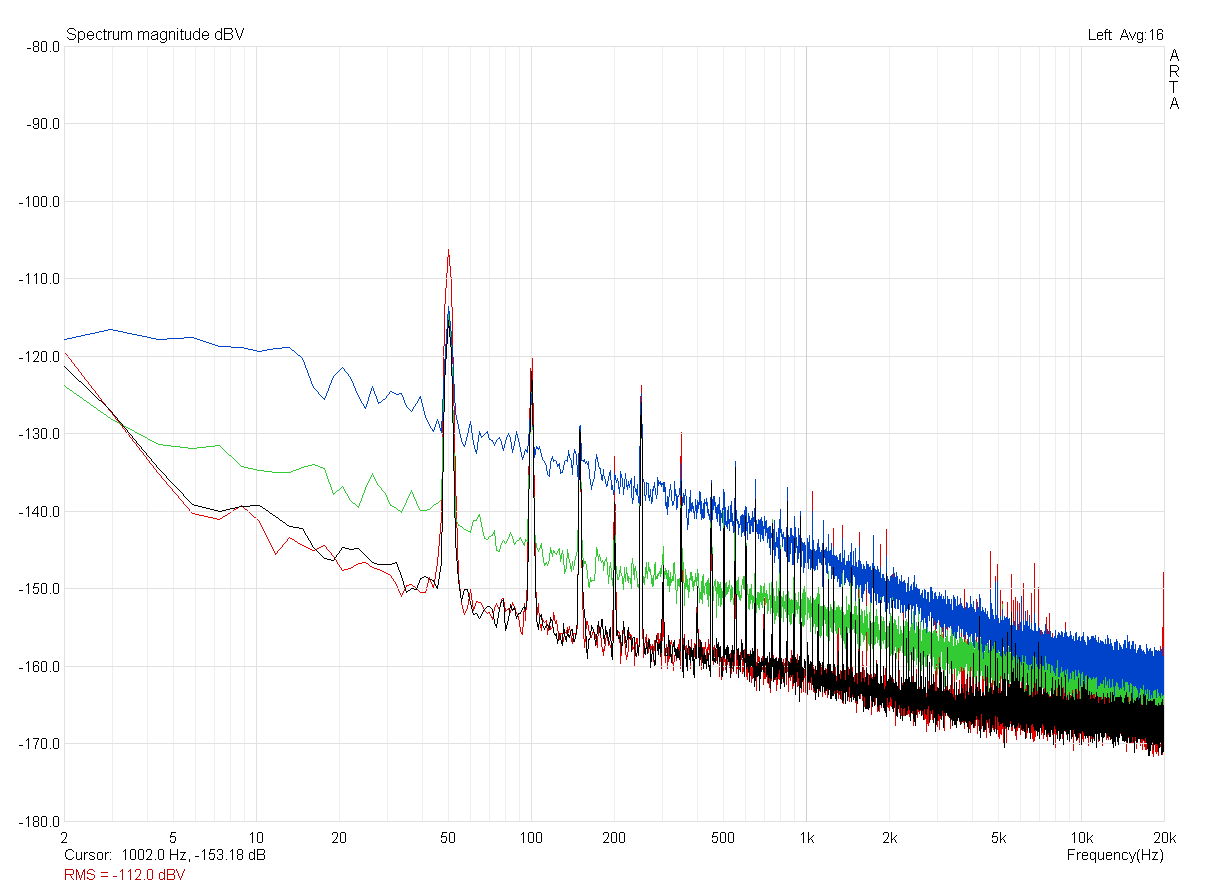

Here're some more measurements:
Black = Positive rail of Dual Salas CCCCS equipped with BF256B and no load
Red = Same, but with my ulti-preamp connected as load (~68mA per rail)
Green = CCCCS equipped with 2SK117GR and no load
Blue = Ground referenced CCS equipped with 2SK117GR and no load
Since I only found two of the 2SK117, I've used them to supply the zener current, while the other CCSes remained BF256B's.
And that's about it. Low frequency noise is about 10dB higher than with Jack's measurements, but his regulator was probably set for a different voltage. Overall performance is distinctly better than any of the LM317 circuits I've tested so far. A round of applause 😀 :cheers:

Zener does better with more mA bias. Are the BFs running higher mA through?
Jack's had resistor instead of a Zener. Was @ 25V I think. Its adjustable.
Try LEDS string as Vref too.
Much better than your LM and TL experiments on first try, so it worked alright. Congrats. :up:
How about white LEDs? Wouldn't need as many as greens then 😉
See recent posts in the Blowtorch thread for some LED noise and tempco measurements and remarks. Blues (same chips as whites which have a phosphor over) are reputedly noisier and have a larger temp coefficient. They do tend to be "incandescent-blind" for photocurrents, which most of the time is a red herring anyway.
They do, actually. It's roughly 5mA vs. 10mA.
Didn't put in a socket for the zener, but if I replaced the FETs with a jumper that'd be 15V zener plus 1k at ~30V, for roughly 16mA (and almost 300mW) zener current...
I think that the noise steps are due to 10mA 5mA and then less when with VBE=VDS
Don't know about more current than 10mA maybe already enough. You could check. You could just parallel two FETS, couldn't you?

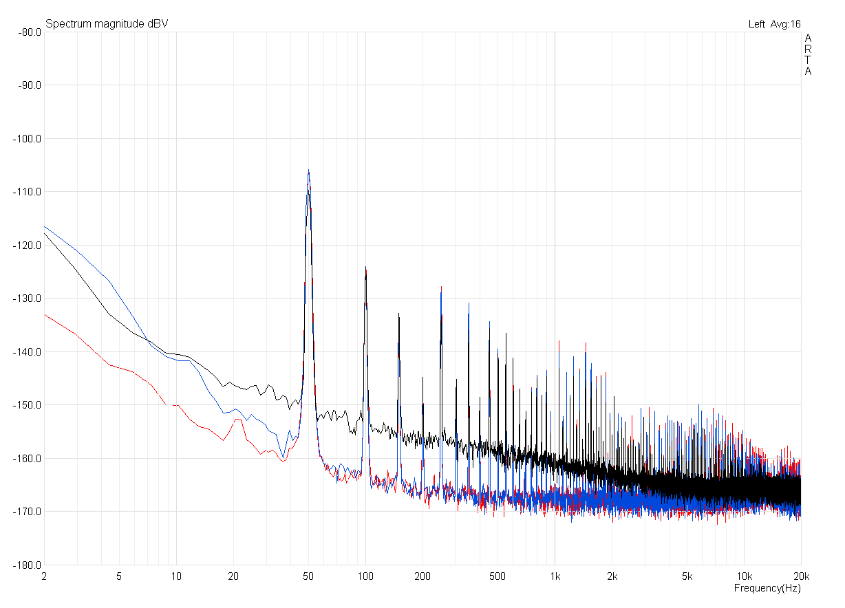

Some testing:
Black: Dual Salas CCCCS with BF256B and 15V zener || 1000uF for reference
Blue: Zener exchanged for 2k2 pot, set for 16V output voltage
Red: Zener exchanged for 7 red LEDs in series

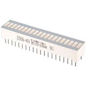

Red LEDs are clearly better than zeners here and look pretty neat when they're packed up as a bargraph 😎. I used one with 20 LEDs, which is enough for both rails 😀

If we ignore the harmonic spray in your test rig, the noise floor is much better by now and seems like following older independent measurements. So your prototype works as it should. Lets find out if you can also hear any better music with it now in your specific line preamp vs your 317-337 experiments. Is it a low, medium, or high PSRR preamp? Don't forget to check on the oscilloscope that the rails will be oscillation free when the PSU is hooked on the preamp before any listening. Use shortest proximity and thickest wires possible. The long stored electrolytics usually come up fully in 48 hours of operation also, so don't expect 100% tone on first track. Hey, where is a picture of your prototype with the bargraph LEDS alight? That one should be a cool looking V1.0 build variation.

So those must be ~2.1V forward drop LEDs in the bargraph packaging.

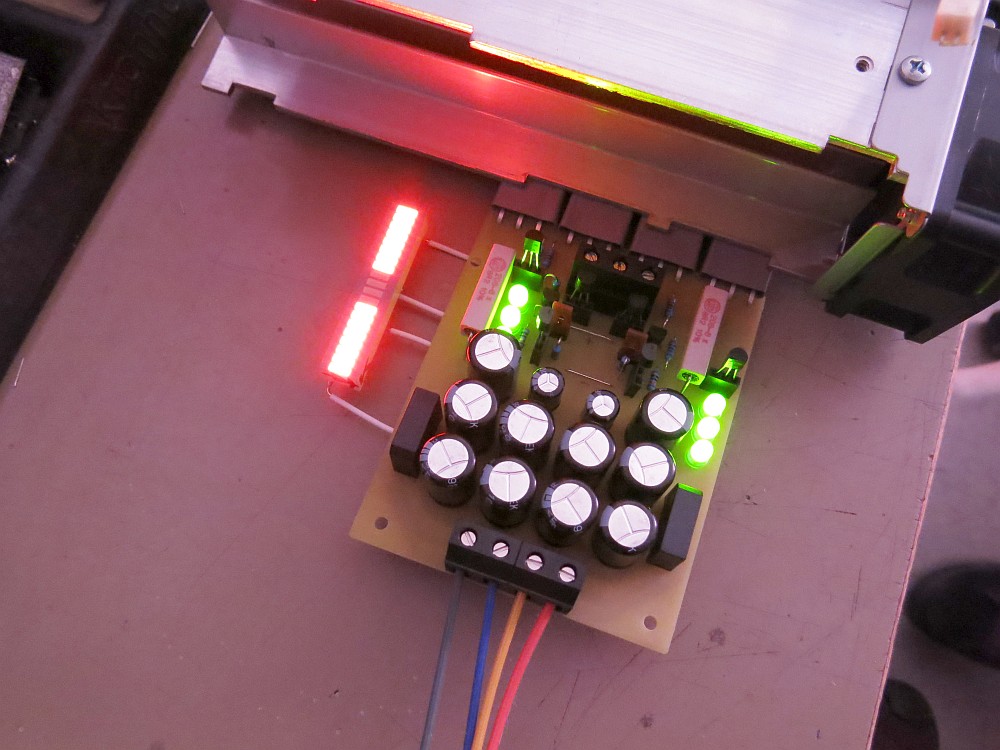

Here it is. Working on a new layout for bargraph use. Adjacent jumpers or DIP switches to short out the not needed LEDs would make the output adjustable in ~2V steps.....
No, it's actually more like 1.9V. 7 LEDs yield only 14V output, so Vref must be 1VBE lower. Changed it to 8 LEDs so I'm back at 16V now. Will have to re-test the noise 🙁.
