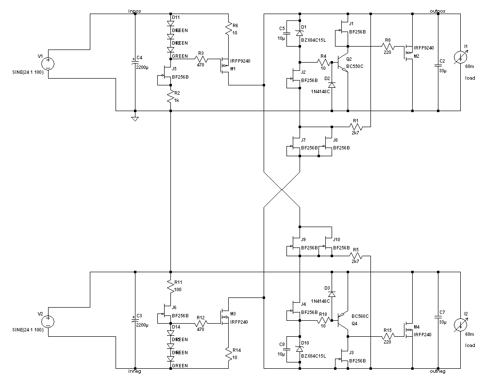

Here's an idea that just struck me while doing the dishes. I was thinking about cascading two JFET current sources, where the first source (with 2x current) keeps a constant voltage over a resistor, which then is the reference for the second CCS. In the attached schematic the first source is comprised of J7 and J8 for the positive half. They're in parallel to double their current, which is then divided between R1 and the second current source J2. This makes the voltage over J2 a lot more immune against variations in output voltage, while having about the same temperature coefficient. Would this make any sense in this case? What's the effect on output noise? At least it would add another 'C' in the name, so now it's "Cross Coupled Cascaded Constant Current Source" 😀
Many are the ways. I don't think it will hurt noise, but I suspect the noise will be dominated by zener noise in any case. Depends a lot on the particular zener samples.
I might have a comparable 15V zener that I could bypass with 10uF and see what it looks like.
For really high impedance I recommend a cascoded structure, which requires a significantly higher pinchoff voltage and Idss JFET as the cascode device. But since you are just supplying current to a zener, which is rather low impedance, the I source impedance is a fairly small effect.

I found a 1N5245B to test, and it is pretty noisy. More current helps, and at 15mA, which was as high as I wanted to consider for a 500mW part, the 10uF bypassed noise in a 22Hz to 22kHz bandwidth was 29uV rms. Bypassing with 2200uF reduced this to 5.5uV. I did not measure the zener impedance but I'm guessing it's around 10 ohms, so 2200uF represents a time constant of 22ms.
We like zeners for low impedance, but reducing noise by direct bypassing requires large C. If instead the filtering is done with an R-C lowpass, it's much easier, and not much is lost used as a reference as long as current noise from the error amp has a small effect.

Received the prototype boards today. Was happy that I got two while having ordered just one, but then noticed that I messed up the gerbers and the bottom layer is on the top side 😱. No problem if the board was plated through, buuuut - no. It's not. :Ohno:
Now this is going to be one hell of a f...king ugly prototype :whacko: :grumpy:
Prototypes need be ugly to work right. (...) No worries.🙂
Thanks 😱. It's actually not as bad as I imagined in the first place. By rotating some of the transistors I was able to populate the board in a normal way and didn't have to solder the caps from the top side :h_ache:.
The good thing: It actually works like it's supposed to. When I set the jumper to the standard (ground referenced) setting it doesn't work with BF256B, kinda like the sim suggested. I'll try some SK117 (which should exist in the workshop) and see what a difference it makes.
