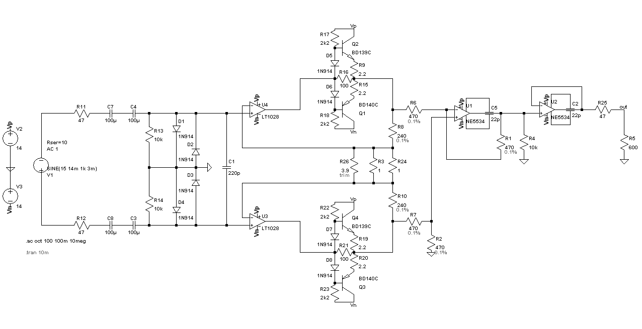

About the op amps: remember that with substantial gain in the first two-amp stage for the standard inamp configuration, the third four-resistor internal diff amp doesn't have to be the same type or nearly so low noise. And of course keep impedances as low as possible in that first two-amp section, limited by the current drive capabilities of those first two amps. Also, since you will be looking at small signals in the main, that first-section voltage swing can be fairly small. You could also use discrete buffers which are more complex but cheap to enhance the ability to drive the low-Z gain-determining resistors.
Something like this? Gain will be 60dB in the first stage. Bandwidth should be sufficient (~60kHz -3dB); else I'd have to go for something like 40dB + 20dB. The gain setting resistor is pretty low with 2x 1R in parallel, so I might already need a file for trimming it 😎. The right halve of the circuit would be comprised of a single 5532, which should be good enough with typical 5nV/sqrt(Hz) and hard to beat on price vs. performance.
That looks good, although you could go lower noise by losing those 47 ohm input resistors.Something like this? Gain will be 60dB in the first stage. Bandwidth should be sufficient (~60kHz -3dB); else I'd have to go for something like 40dB + 20dB. The gain setting resistor is pretty low with 2x 1R in parallel, so I might already need a file for trimming it 😎. The right halve of the circuit would be comprised of a single 5532, which should be good enough with typical 5nV/sqrt(Hz) and hard to beat on price vs. performance.

Isn't there any way to get away from so many 0.1% resistors with maybe a couple trims? Using resistors in the multiple per SIP packages would get you some matched and thermally tracking parts for example. That's if the part to part match is more important than the precise value.

From what I've read, every imbalance of those resistors translates into a much worse CMRR. That's why they get laser trimmed in integrated solutions like the aforementioned AD8428 and easily cost 20 bucks apiece. I don't know what's more important in this case, 1% vs 0.1% for precision or integrated vs single resistors for temperature tracking. And I don't know if those resistors can be trimmed with a file while watching the spectrum on the PC for lowest common mode noise. Things I'll have to find out...
Those 47R at the inputs are there to limit the coupling cap charge current somewhat. I've omitted that for my current preamp, so maybe I can get away without them here, too.

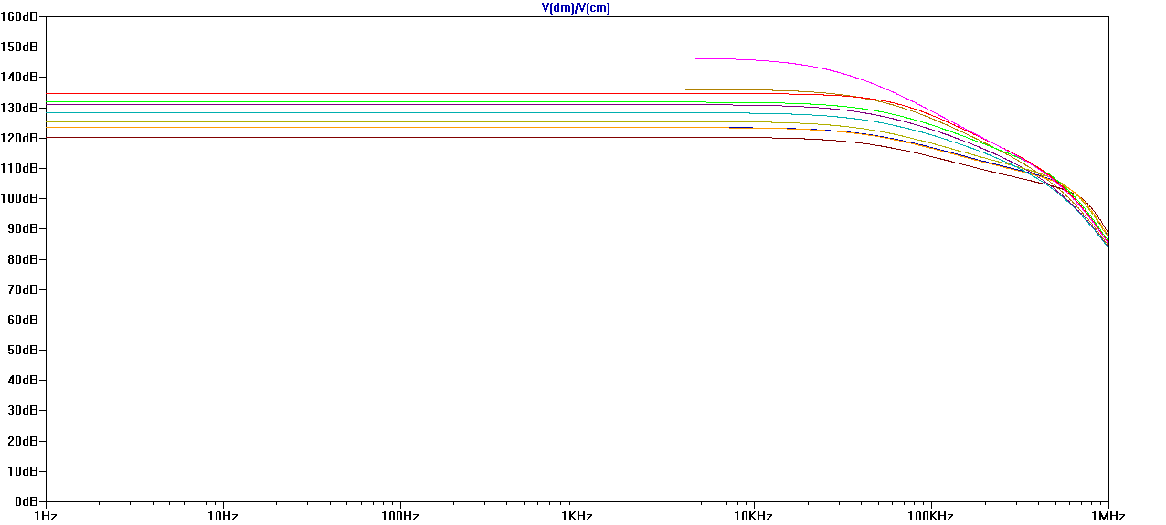

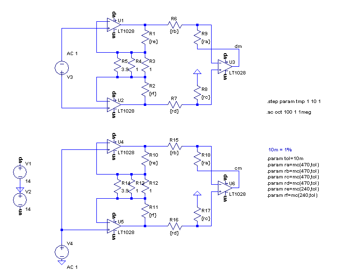

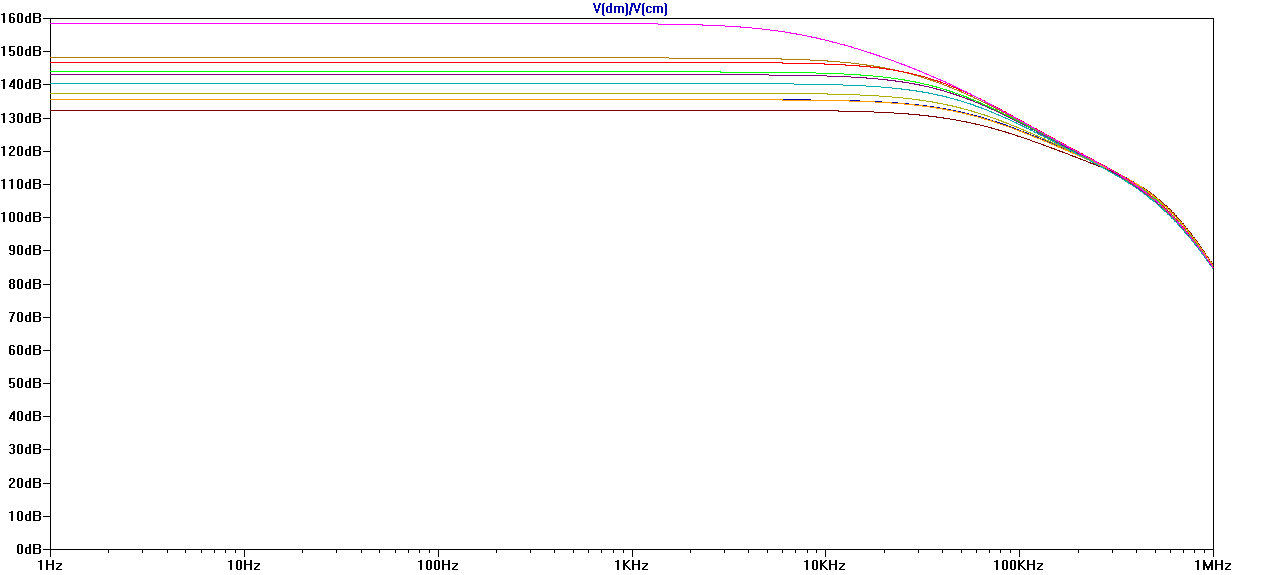

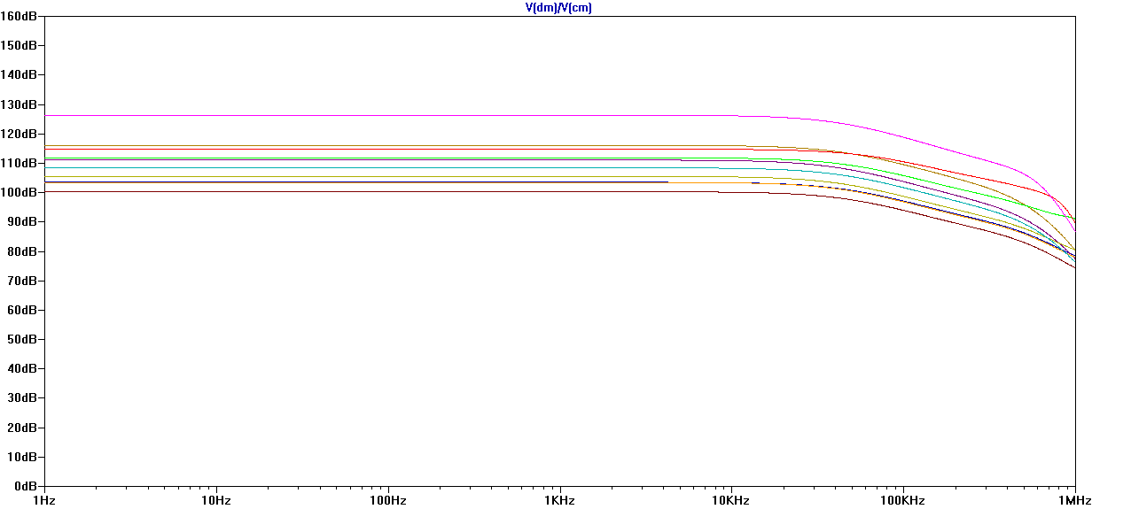

Anybody care to check whether that simulation is correct? 😱
Monte-Carlo'ed six resistors in ten runs for different precisions of 0.025% (LT parts), 0.1% and 1%. This was just for the resistor values, not for temperature. Note that every single resistor has a different random number in its tolerance range, they're not all six of the same value in each run.
Why did you choose R13/14 as 10k?Something like this? Gain will be 60dB in the first stage. Bandwidth should be sufficient (~60kHz -3dB); else I'd have to go for something like 40dB + 20dB. The gain setting resistor is pretty low with 2x 1R in parallel, so I might already need a file for trimming it 😎. The right halve of the circuit would be comprised of a single 5532, which should be good enough with typical 5nV/sqrt(Hz) and hard to beat on price vs. performance.
W.Jung tells us to use very high in trying to approach the >10M of a transformer. I seem to remember he suggested 1M5

the worst case -100dB for the +-1% surprises me. Whitlock talks much lower CMMR in his articles.Anybody care to check whether that simulation is correct? 😱
Is your 1% actually +-0.5%?
I headed for something that gives a reasonably low rolloff with the input caps, assuming that lower resistance means lower noise here.

My 1% sim is in the range of 465.344 to 474.697 for 470R and 469.534 to 470.47 for the 0.1% setting.

After you connect the Source, then the 10k has no effect on noise, it is paralleled with the Source output impedance, ~10r to 1k0I headed for something that gives a reasonably low rolloff with the input caps, assuming that lower resistance means lower noise here.
