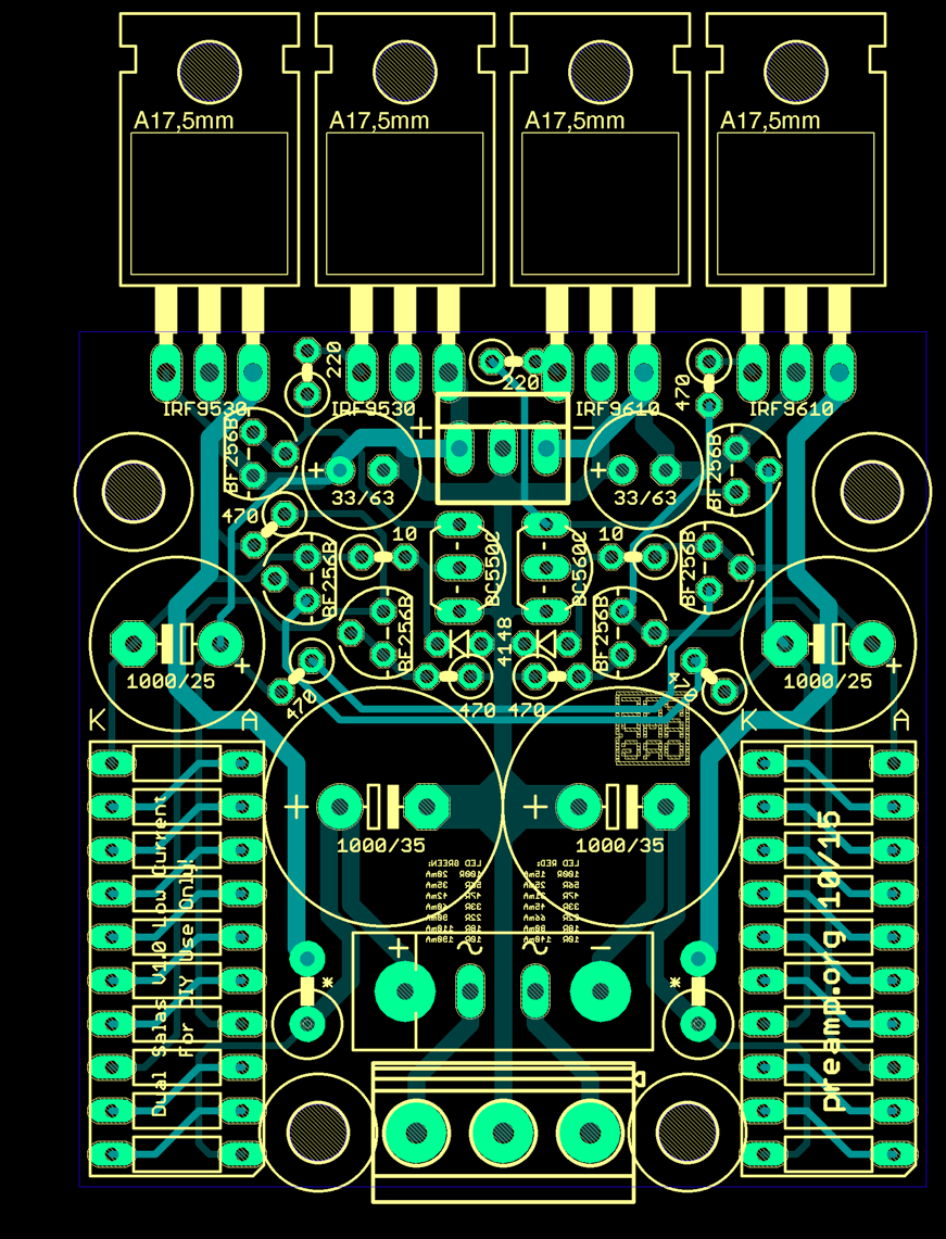

Just finished refining my small 5x5cm layout and ordered a couple of boards from China.
