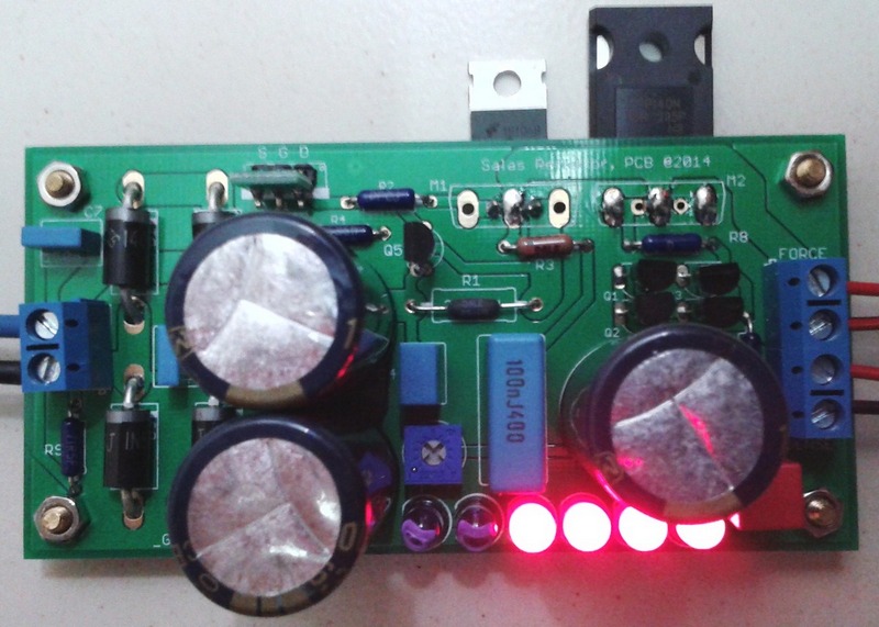

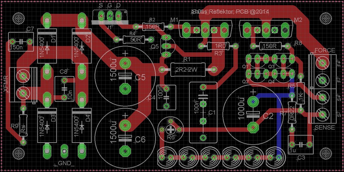

My Second Reflektor
A local DIY friend has happily taken over my first Reflektors (well, for free), after he was impressed by the SQ improvement it brought vs his LM317 supplies, and I made a second PCB which can take more LEDs, TO-247 MOSFETs, and use off-board heatsinks :)

Don't do that with IRF9610 before you will inspect its datasheet carefully and make sure its internal temperature will stay at safe level on that sink along with the output MOSFET. The 9610 is a 20W at 25C max device, its in twilight zone when >1A and every operation parameter you decide or any heat transfer deficiency counts. There are stronger P-MOSFETs but more capacitive. If you will be obliged to choose stronger one, watch the Ciss parameter to be best available in power class.
Thanks Salas, I forgot to mention that M1 is currently FQP7P06 (45W/7A max, ciss 225p) and M2 is IRFP140N, would they be OK?
I want to compare if it will bring improvement over the AMB Sigma11 that is currently supplying my Raspberry Pi, and it takes up to 1A, though I probably won't use it for the long term due to the heat.
