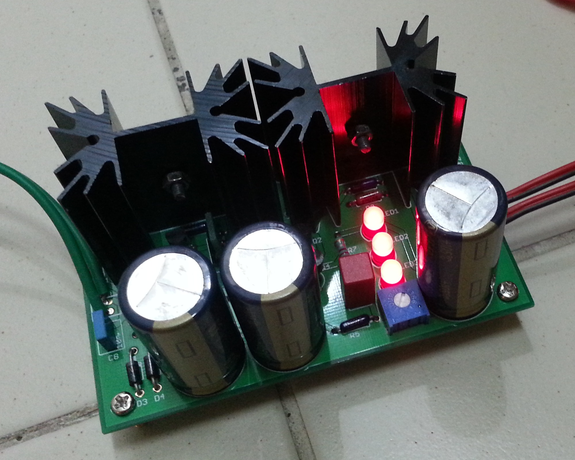

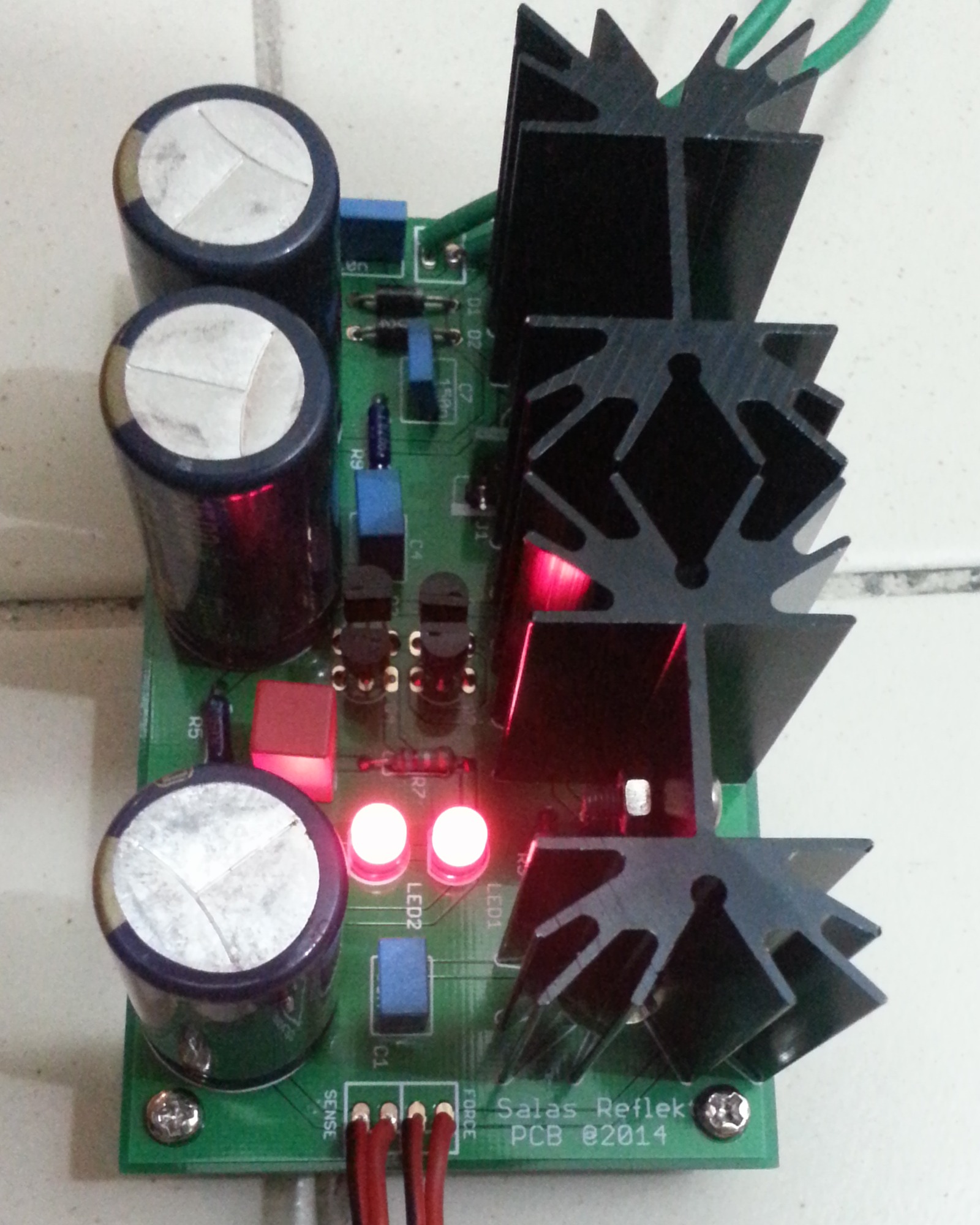

My Reflektor is up

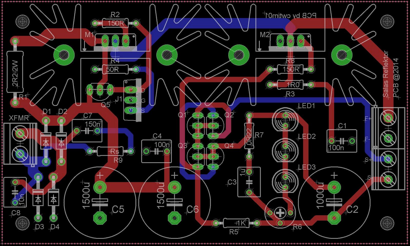

I use the Reflektor as an exercise to learn using PCB software, and draw my first ever PCB.
I should have made the main PCB trace wider, and several other things could be done better - but I'm just glad that it is working the first time round. One issue was that as I use IRLZ24N for M2, where it's Vgs is on the low side, I have to replace the trimmer with a 2K one in order to reach the 10V needed.
Reflektor is friendly enough to get going.
What voltages across R1 & R5 for how many mA average load consumption?
Voltage across R1 is 0.64V, R1 is currently 3R3 so current is less than 200mA, when all testing are done I'll change R1 to 2R2 to give around 290mA. Given the small onboard heatsinks (rated at 3.7C/W), I'll not go above 300mA.
Voltage across R5 is 2.12V when R5 equals 1K. I realize that by changing R5 to 250R, voltage across R5 lowers slightly to 2.08V but Vout can exceed 10V even with a 500R trimmer. So I'm wondering what should be the "right level" of current at the current mirror.
Don't play with R5 downwards because it lessens the gain of the error loop. What you saw is by doing that you also boost the current in one side of the mirror which gives more to the Vref on the other side too. Its not bad you got a bigger trimmer if Vo is stable. Although you could have used more LEDs instead. Is Vo 10V stable in your build?
