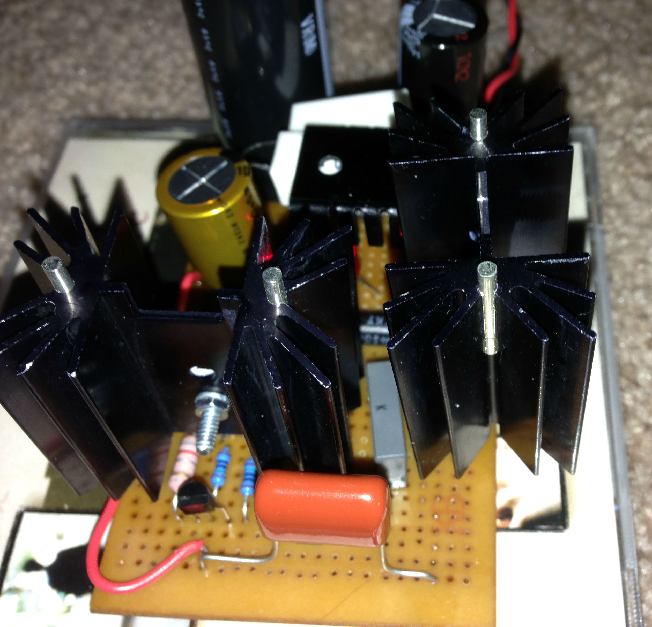

Thank you guys, my salas reflektor is up and running. I will change my tranny to a 9V one soon. Till then have to run with 7.4ohm 5W resistor also working as a CRC filter. It might be all in my head but there is a positive difference when I changed my Smsps wallwart that pwered my active USB hub ,which is needed for my HRT streamer pro to run in asynchronous mode with Squeezebox touch.
Congrats. You put on the larger sinks already?
Yes I used the second one from the one asked before,got from digikey yesterday.
