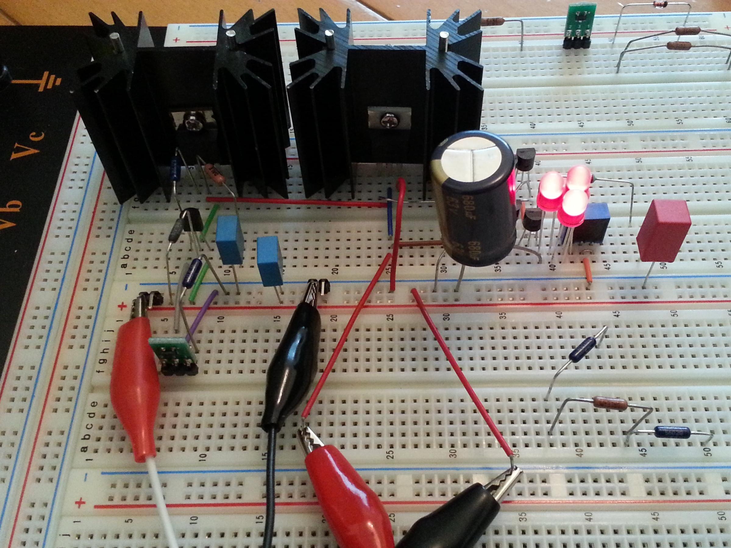

For both cases of R5=1K and 250R, Vo is around 10.1V when power up, drops to around 10.0V in 30 seconds, and then kept stable.
I've done more testing and I take back what I said about output voltage being stable. I realize that the output voltage is actually swinging within a 0.01-0.02V range, I replaced the trimmer with a fixed resistor and the swing remains, and I can only maintain a completely stable output voltage (to the extent my cheap DMM can't detect anything) when using an all LED reference (i.e. shorting R6) or Zeners.
I thought the MOSFET maybe the cause so I replaced it with a MTP3055VL (others in this thread have used this MOSFET successfully before), but the swing persists. I checked the output with a scope meter and I don't find anything oscillation like.
What should I check next ?
If it takes a while to swing its the MOSFET's thermal changing the Iref reflected. And/or some BJTs in the mirror cycling. Larger VGS non TTL MOSFETs create more Iref so the percentage of change is smaller. How long it takes to swing that +/- 0.01V? For absolutely no move is using LEDS. Only very small R6 if any, just for hitting the target so it will not contribute enough. Oscillation, no. Problems would have been much stronger if so. You could use LM329 + 1 RED LED + short + short, the way you got your board made. That should be well near your 10V target in very good noise quality.

It took a bit of time to order the parts and I tried the following:
  • Use IRF640NPBF as M2;
  • Replace all BC560C with 2N4403;
  • Replace J1 (BF861A) with 2SK170;
  • Replace J1 with a CCS diode E202;
  • Put the whole Reflektor on a breadboard;
Under all situations, I always get 10-40mV drift in output voltage as long as R6 is of any significant value. All the transistors and FETs are from RS or Farnell so they should be real (except the 2SK170 tested which is borrowed from a Teabag DCB1 group buy so I believe it's real also).
The time to swing varies, it's between few seconds to over a minute. I thought it's abnormal as the previous series regulator (using a single Zener as reference) I tried do not drift, but I'm starting to wonder whether it's actually normal to have such voltage drift for these shunts, as nokin has mentioned:
IMO I think noise is more important than volt stability of any psu, if it only swings around 0.05V tolerance. Just ignore it and relax with new toy.
