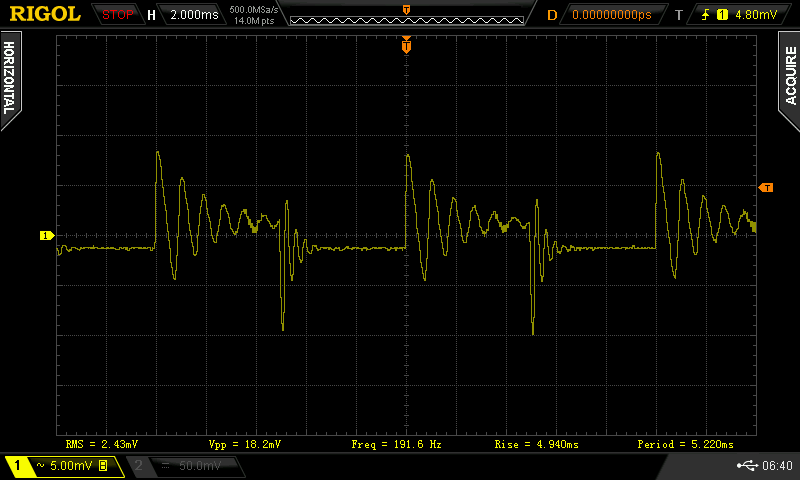

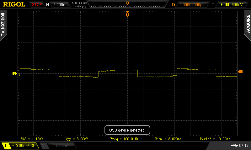

The Tenma result looks horrible.

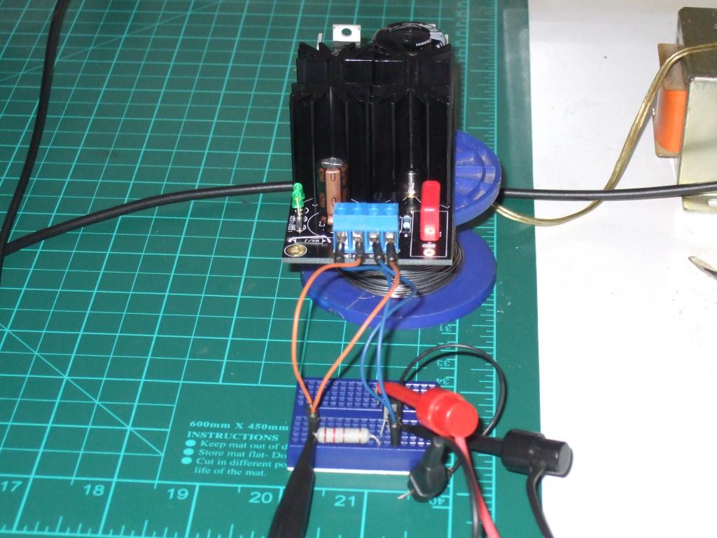

I got a rise of 18C above ambient with 350mA spare current in test. 1.5R R1 and 100R load at 5V. Pretty heavy overhead setting.
That was with 38mm sinks and I "prescribed" 52mm tall ones since I saw them available. Such a reg will need 2U boxes and ventilation anyway.

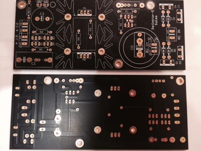

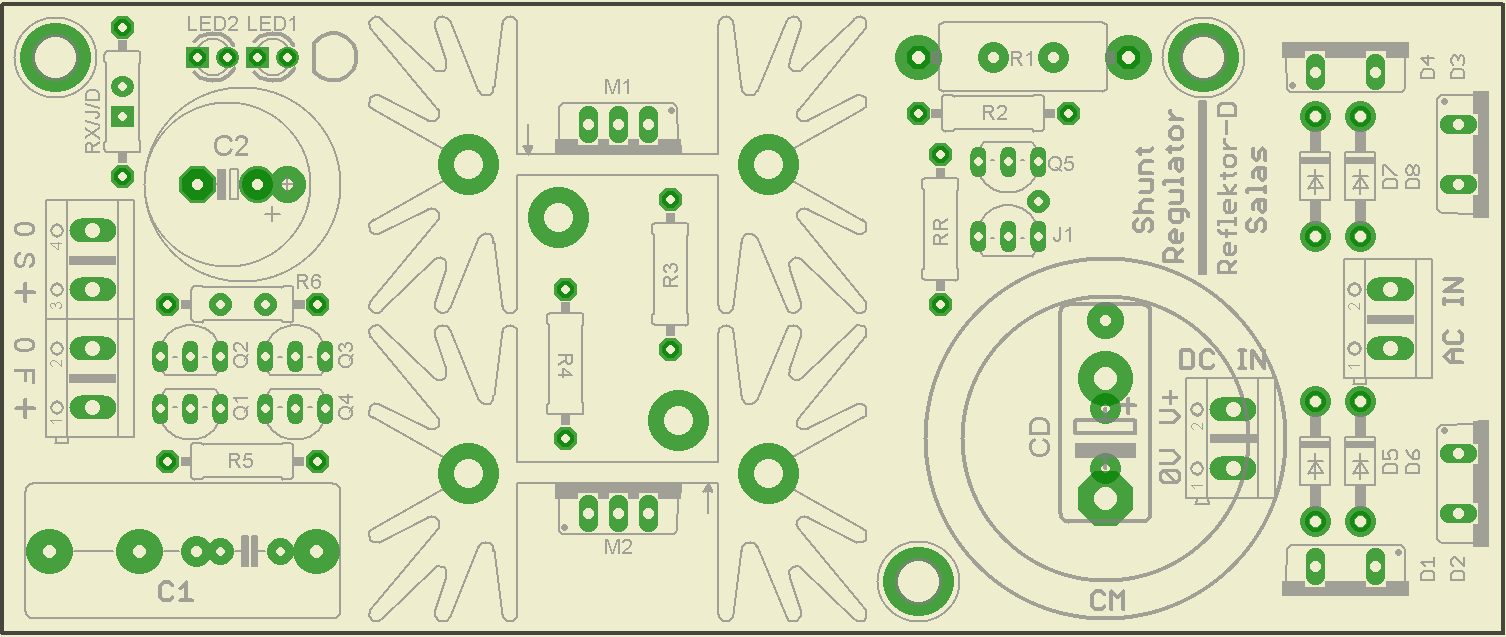

I also added air circulating holes at the bottom of the sinks "chimney" formation. Extra pads for 3rd LED in Rx/J/D for 7V looking good pre-reg uses also.
How to "blindly" set CCS its in the guide on a look up table for fixed R1 values and suggested load ranges. Certain brand LEDS pre-cooked combinations for setting Vout also. The guide is almost proof for release. Few small details to secure and it will be out. The more detailed preparation work we do the best it will serve the people without much confusion. (Hopefully).

That is the one that will be in the guide. (The board details and instructions finishing very soon).
Do you have planned a GB for PCB & parts for Reflektor-D?
Yes it will be in the next general GB very soon. All likely parts are tested.
