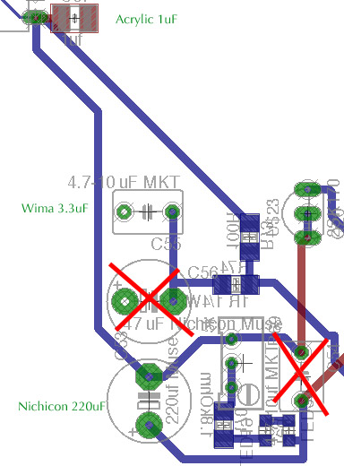

That's it! Removing the acrylic at the load solved the problem...
Can you explain what happened here? I would like to understand also what the possibilities and limitations are on local decoupling...
This is very interesting to me. What are/were the distances involved, through the traces and ground plane, between each of the reg's output points, the top and bottom of the zobel, and the cap's two leads (and the load's pins)? Can you possibly show a diagram of that part of the layout?
Sure... interesting to me as well....
Attached the layout, let me know your thoughts.
Note that the crossed out cap positions are unused, and the 100R at the output is not used either. Actually Salas suggest to put a 1R at the output, so that position is 1R now.

That 1R was to see where we were getting at. No need to keep it if you test its all quiet even without it now.

Sorry if this is mostly just speculation, at this point.
Is it maybe a stability problem involving the remote-sensing feedback loop?
Where were your probe and probe ground, exactly? And what is the fundamental frequency of that oscillation?
What happens if you try a larger (or smaller) value decoupling cap?
Please forgive me for not reading most of this thread, but what is the input voltage and what is the maximum possible current draw, for your circuit?
200 kHz might be high-enough for most audio power amplifiers but the supply rail trace length (inductance) might be too much for that, without decoupling capacitance. If it were tens of watts, I would think that you would need at least 220 uF decoupling, with maybe 3-4 cm max total length for cap connections to device power pin and ground, including cap lead spacing. Is this a low-power application? Or can you try moving the device much closer to the regulator output, so maybe no decoupling would be needed?

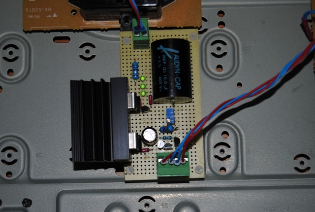

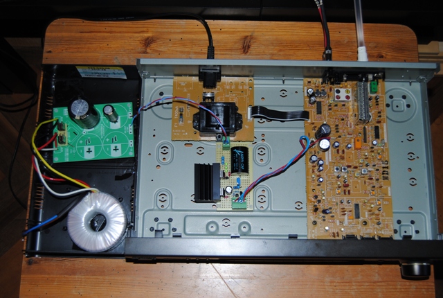

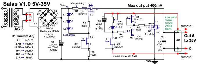

I've built another v1.0 salas reg for +5v. It's working fine, though a bit weird is that I set the voltage to 5.00vdc and after about 10-15min it raises to 5.15vdc...in an hour time to 5.20v...doesn't go higher. Is that normal with v1.0?
I've got about 14vdc after rectification
233mA transformer
elna caps (C7 - 47uf & C6 - 2x100uf)
FC in PS (2x 2200uf)
Q1 & Q6 - IRF9520
The reg is used as analogue supply for two Wolfsons WM8740. According to the manual it should be feeded with 13mA per chip, so 26mA in total + 30mA for the reg itself, that was the goal.

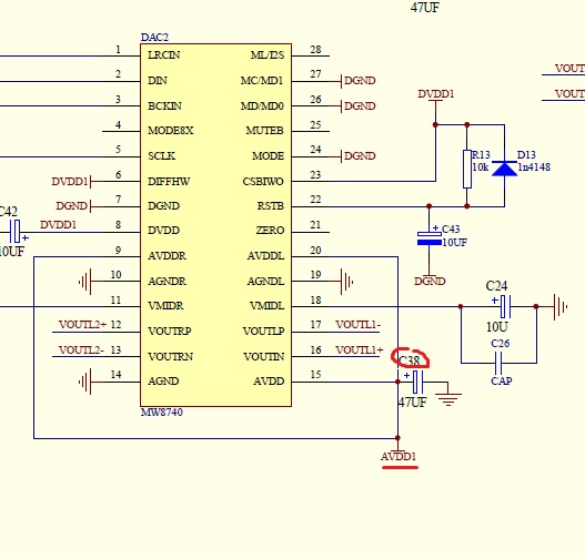

Another question is that do I need to keep 47uf caps near WM8740's pins (AVDD1) as it was designed originally in the DAC (att.) or just stay with 47uf Tonerex that I used in the reg's output? Previously Wolfsons were feeded with one LM7808 -> two smd LM 5v regs. All three regs have been swapped to a single salas v1.0.
would very appreciate any advice!

To avoid drift measures resistance in the trimmer & change for a low ppm fixed resistor. Do you have a scope? if yes see if with the 47uF near the DAC you have ripple or oscillates, if I remember well all shunt regs designed by Salas don't like a cap between the reg & the load.
