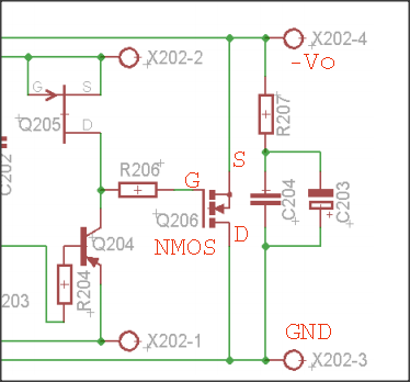

In the meantime i have fixed the prereg, and replaced the bc557 with a branded bc560. The intermittent flickering stopped (for the moment, i havent done an endurance test). The bc560, like the bc550 yesterday gets verrrry hot... I burnt my finger on it!
Does the bc560 usually require a heatsink, o r do you think there is an error? Didnt see anything funny on the scope now....
All they can have across is the Vo-shunt Mosfet's VGS. All they can have through is the U$23 IDSS. Thus I would expect ~10mW in your (-)15V one if normal. They still cope without mini-sinks near 50V in some of my phono builds but with 2-3mA IDSS cascoding Jfets (V1.2R). What are your shunt Mosfets there?

Mine is V1.0, BC560 in my circuit is not hot. Vin is -21V, Vout -11.4V, Iout about 30 - 40 mA.
I don't know if this situatioin apply to your circuit as yours is BiB.
After the cicuit is on, Vout is -12.04, after about 5 minutes, it settle to -11.4V and never drifts again even after used more than 2 hours.
MOSFET = IRF620
But... I am using 2SK170 as U$23! That's then probably where the problem is, isn't it? (is K170 typically higher IDSS than K117?)
If I replace the U$23, I would probably have to replace the K170 on the other side as well, no? (sorry I don't fully understand the function of that one).

VGS MOSFET should have been in the Volts region. It seems to me that the current follower is not open and the small BJT provides all the current it can to the load, that is why it gets hot. Can you confirm MOSFET orientation and PCB connections to original schematic please?
You got it. The poor BC was doing everything alone, I had wired up another JFET wrongly! The heat/stability problem is fixed now!
When measuring aroung, I noticed that both the negative regs have much more noise than they should have though (0.4mVpp).... strange !
