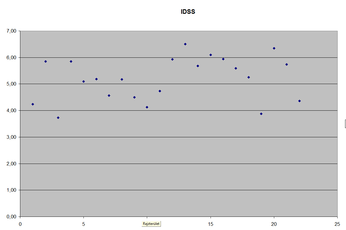

Some drift more (temperature coefficient) especially the low noise ones with strong gain. Since you got a hot box inside you may try compromise a bit with the one I suggested. Its less affected although not that strong but adequate.
Plot of few 2SK170GR Idss.

tried to match 3 sk170GRs and came out with 4.86, 4.88 and 4.94mA. Soldered them back, turned the reg on, adjusted trimmer to 5vdc output and closed the lid of the case. After about 15min I still got 5.20vdc...weird.
then I put BF245A as Q3, adjusted the legs as it's not pin to pin replacement, same with vdc output and closed the lid...after some 10min I got 4.89vdc 😀 it'seems that it's affected vice versa by the heat. Anyway I was unlucky again.
Is there any other suggestions? Perhaps if I use two decent BLs with 7-8mA IDSS as was adviced in some other thread + BF245A as Q3 that would stabilize the output vdc?

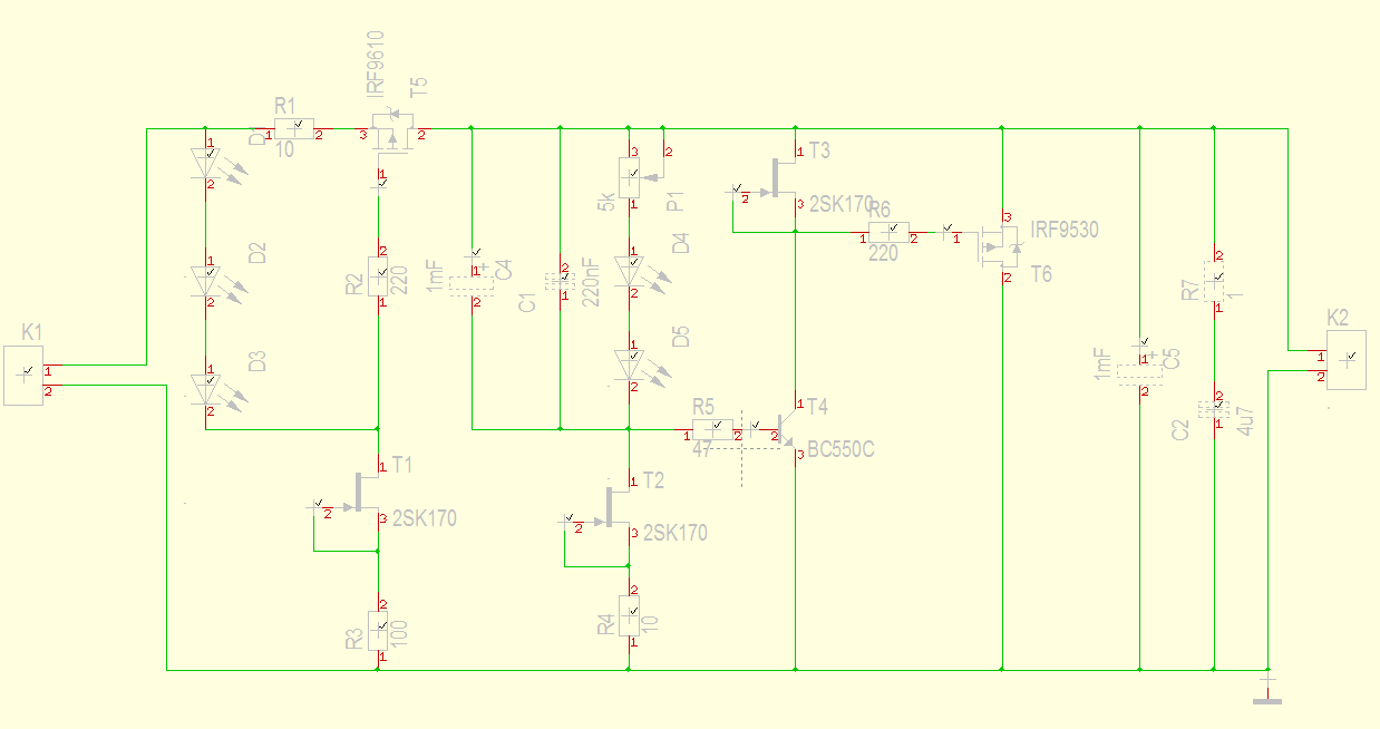

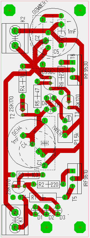

is this a correct interpretation of Salas 1.0 sslv
I want to use this schematic and this pcb for salas V 1.0 with IRF9610,9530 instead of IRF9240 for low current loads like DAC,Clock,Buffer,Phonopre. is this schematic correct for this applications and the pcb design ok? the pcb is from myself and i tryed to get it small as possible for my small chassis. the salas sslv bib is to big for my application. for dirct use i dont need the sensing feature.
thanks for your attention and help
