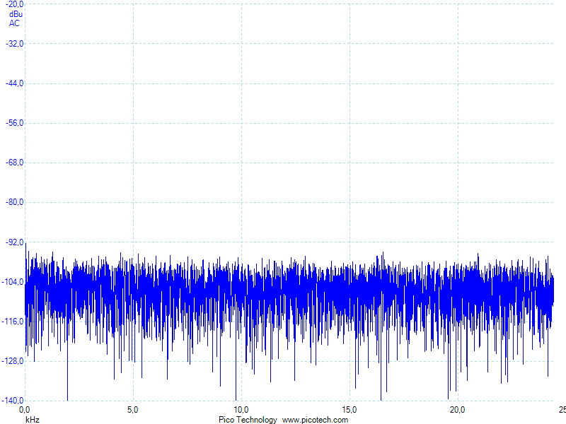

Then where's your hum needle at 50Hz on second pic? Maybe you had the probe at a better angle to the toroid?
Probably "drowned" in noise b/c we are at the limits of the equipment. It is visible on my "audio range" picture.
