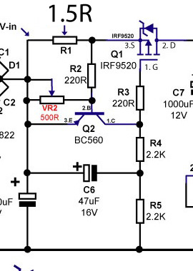

you can try to do this circuit, Get current it is easy, only use trimer 500R
Please ignore the Quanghao drawing, unless you want to change to a much lower power supply, and use this totally different circuit!
If you have a 17-18V supply, 9,2V across the LEDs, you should be OK. Just check for 5V across R1, then change the value of R1 until you get 0,29 to 0,30A
What is Ok, Quang Hao schematic?
Quanhao schematic is NOT OK. There is likely to be stability problems, if you build the circuit like that.
