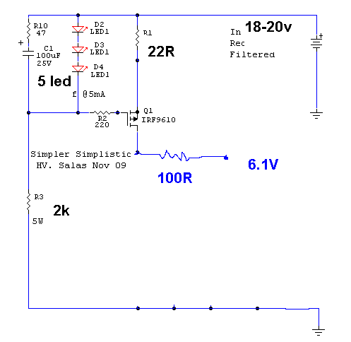

I'm trying to set the filament current for SRPP 6922 to 0.3A & 6.1V, I'm using GH Salas Low Voltage Shunt Regulator, looking for dummy load I calculated by ohms law:
R = V / I
R = 6.1V / 0.3A = 20.33 ohms
About power needed for dummy load:
W = V x I
W = 6.1V x 0.3A = 1.83 watts
So I used a 20 ohms 5 watts resistor for dummy load, I used a 12v 5A Tx because shunt needs a Vin-Vout 6-10V difference, I used R1 (adjust current 4R33 & get 1,368 across R1 to have 315mA, that's the theory but when connect to the filament tube the maximum voltage I can reach is 2.19-2.24V with the 5K trimmer....Led 4 lit only a bit....& tubes don't lit...

Andrew is correct, you don't need a shunt regulator for indirect heated tubes like 6922.
If you have already made a SSHV, just use the IRF9620 current source, Q1.
Use Green LEDs x 5, and make R1=22R, to give 0,29A.
Power on, check voltage across heater. Add 100R resistors until you get 6,1 to 6,25V; for 6922

Thanks Rod, like this schematic with R1 22R for 0.29A & five Leds instead 3 Leds, (Tx 12V 5A?):
This will be OK. The supply voltage should be 18 to 20V for this circuit.
For a dummy load to test 6922 heater, use 2x 33R 5W wirewound - in parallel [shunt]. Connect the dummy load, and measure the voltage. this dummy load will give about 4.7 to 4.9V when the current is 0.29 to 0.30A. When you see this voltage, you can safely connect to the 6922 heater, and check for 6.1 to 6.2V.
BTW, If you use a bipolar PNP [eg TIP42], and 2x green LED, you can run from 10 to 12V - but that is a different circuit!
Its very near to what Rod told you to use. Why not? Only expect a bit less voltage developed over it than the targets he gave you, since its 0.5R less than 33R/2.
