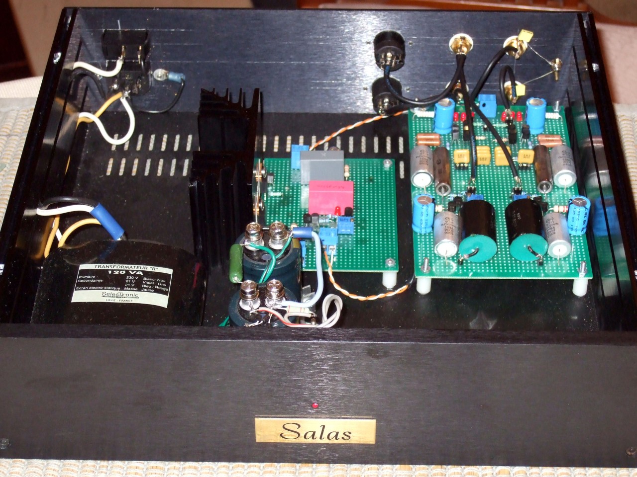

Well, I'm back... turns out I spoke to soon. With the fixed value resistors in place (setting Vout), the voltage is still rising. Slower than before, but, still rising. I've also reduced the current to about 70mA with by using 10 ohm at R1 instead of 3.3 ohm. My chip need about 15mA. All the diodes are in place an shining brightly, no oscillation on the scope. The voltage setting resistors are 1watt 10k for negative and 11k for positive.
Thoughts?
Ken

It does not stop rising after there is top temperature reached on everything? How much it backed off with one LED, maybe two could harness it a bit better? Also if you try connect an electrolytic cap across the reference resistor, say 100uF, what happens?

It doesn't stop rising... ran it for 30 plus minutes and it just keeps going up, slow, but steady. I'll give both of these ideas a try. To be clear, LED should be in series, yes?

what currents and voltages are changing to cause the drift in output voltage?
check the currents and voltages on both sides of the sensing/measuring bridge.
I just checked a 3LED string with a bf244a in Quanghao PCB.
from 20V down to 12V the current fell linearly @~0.2mA / volt.
below 12V down to 5V the current fell faster and faster the lower the voltage.
However when measuring the voltage across the LED string. It held steady to 3 sig fig from 20V down to 9V and then fell very slightly down to about 6V. The LED string could not hold a constant ref voltage when supply fell below 6V. This shows that Quanghao circuit for 5V and above does not allow bf244a to be used as the CCS at the low voltage end. sk170 would perform better at the 5V to 8V range. A cascoded jFET would perform even better.
