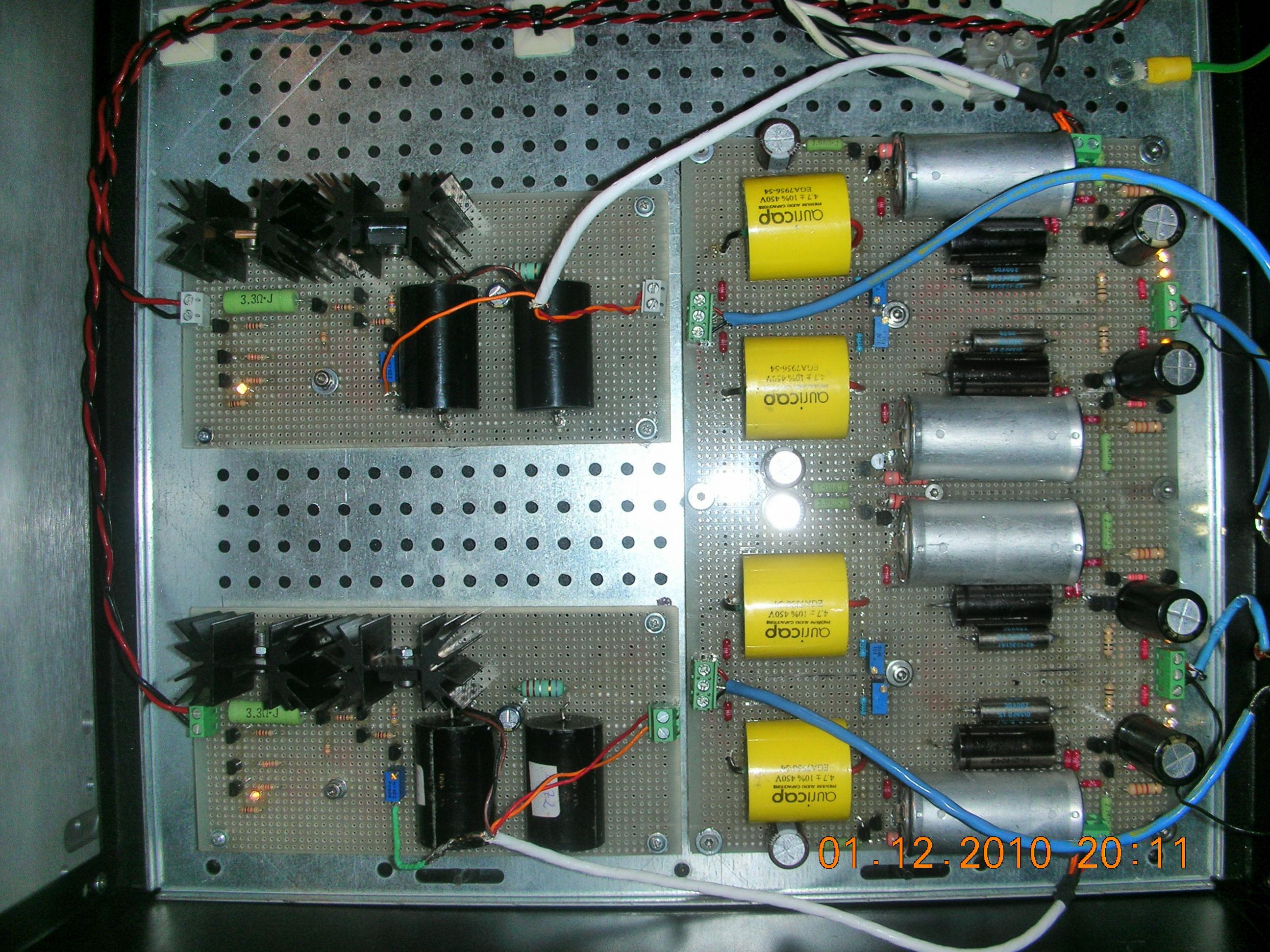

A couple of V1.2R feeding the balanced phono RIAA🙂
Sweet!
Thank you klewis, your work is very neat & looks professional I never will arrive to this quality.
I guess that's my architectural training showing through.
Nice combo. Looks good together.

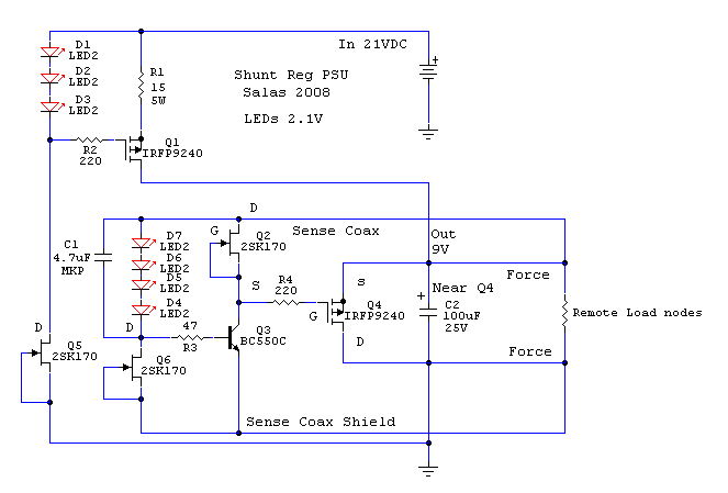

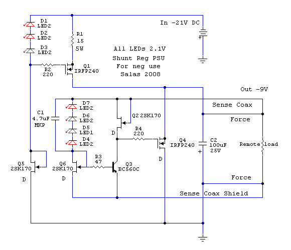

I will try to make a 12R positive 21Vin/12V out, also 12R minus -21Vin/-12Vout.
Can I use BF245A for Q8(2N5457) and 2SK170 for Q3(2N5459)?
For Q8 you can use BF245A, for Q3 you can't use 2SK170. But you can try BF245B if you can find instead of 5459.

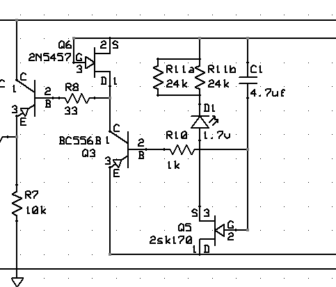

V1.2R has another error amp's base resistor than V1.2. Much larger. Its all about the tempco of the Jfet and the Bjt to find some balance. Try one Led in series with the ref resistor at its root over the fet. Sometimes it counteracts a bit.
Like this?
Yep, and looking the other way in the positive. Will contribute a couple of Volt also but you can trim those out from the resistor if it will be helping the drift.

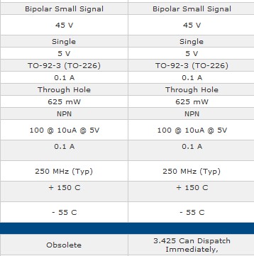

Is the BC550CG a direct replacement to BC550C ?
Comparing specs on Mouser yields no obvious differences.
See attached pic (left BC550C, right BC550CG).
it is one!
