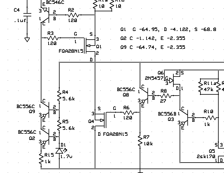

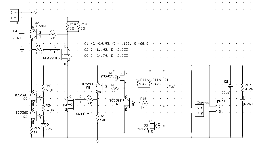

Salas,
Built the V1.2R, but can't seem to get the negative side up and running. The diode is quite dim. 69v in 4.1 vout. I've attached my schematic with measured voltages. I've already replaced the diode and Q9, double checked solder joints and resistor values. Your thoughts?

I suspect the Shunt is shunting too much current and pulling down the output voltage.
Remember I warned about considering the R4:R5 ratio.
You now have >60Vce on the cascode.
Disconnect everything on the shunt side and see if the CCS side works properly.

The LED is dim since there is little Vo that is fed from. Make that BC546 a BC550C. 4.1Vout means just Vgs. There is no Vref functioning. See about Q3, Q6 correct practical orientation or being busted. Check correct JFET connections. Check its alive. I don't see that circuit part in your pic clip.

I will follow your suggestions. I've reposted the schematic with the actual resistor values shown, the prior one hadn't been updated. I forgot to mention that the positive version is running with vout at approx. 60v with R11 set at 12k.

You miss a connecting line between S & G of Q5. If you miss it for real, you got no Vref.
Thanks you Salas!

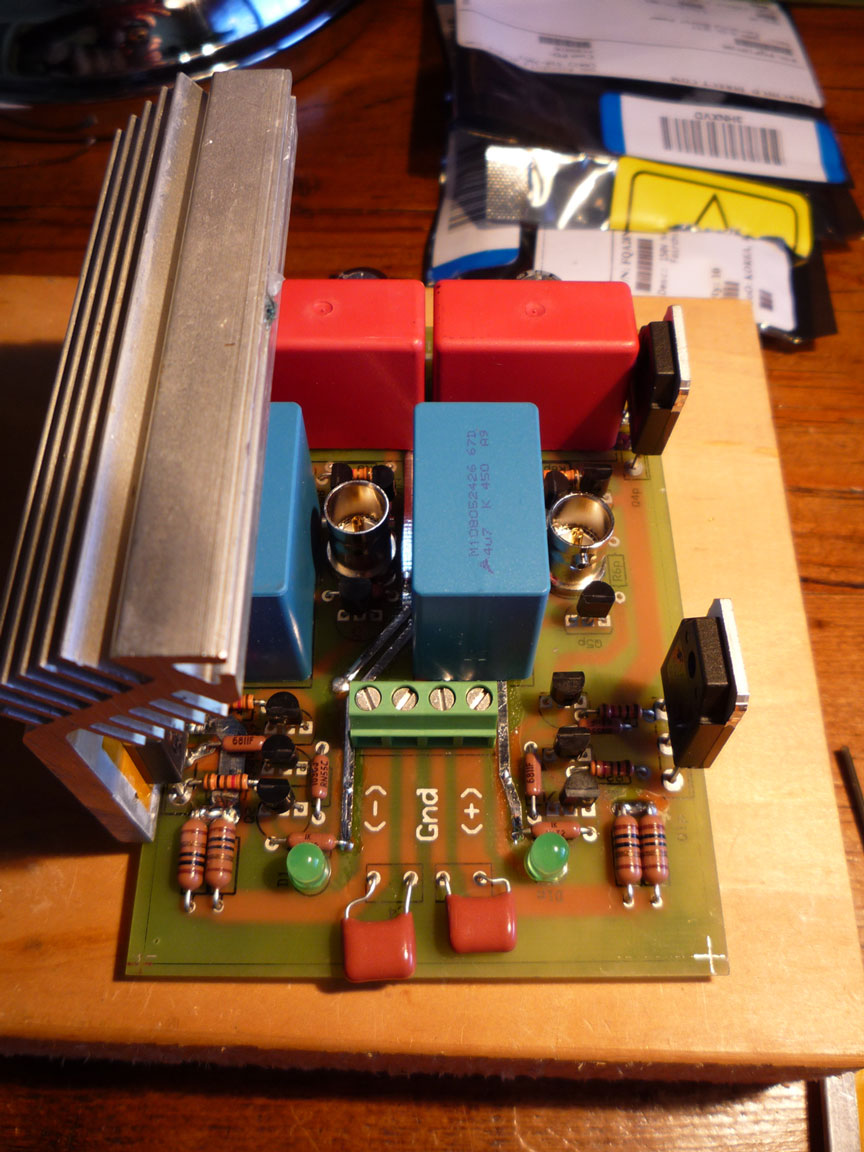

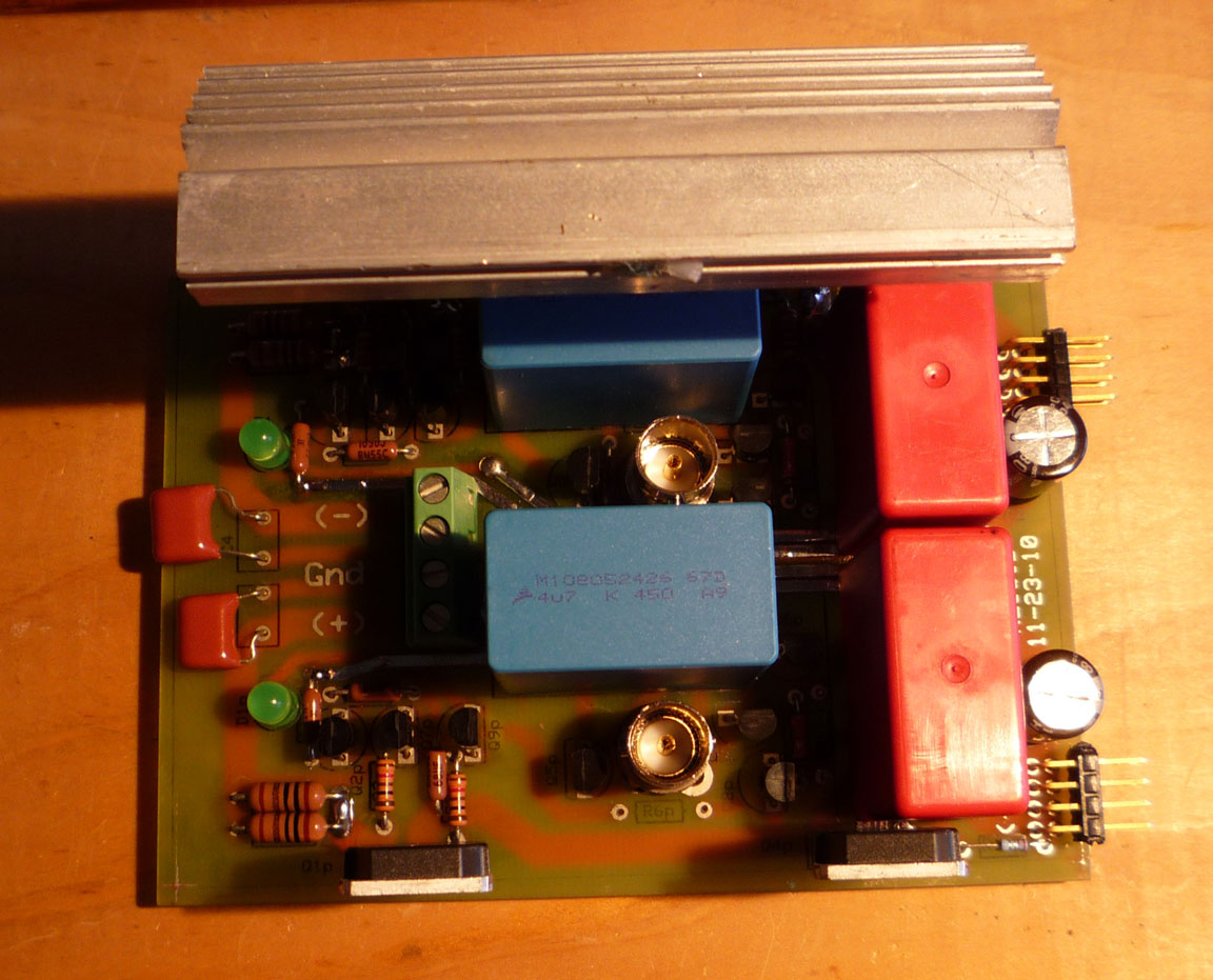

Did you make new R PCBs or modded the 1.2? Also is the positive side steady and oscillation free? Any pic to see the layout?
Yes, I made new R PCBs, the positive side is steady though haven't checked for oscillations yet. Photos coming soon.
Nice. Check it all works steady and giving straight scope lines. Will be happy to know it all went OK since you use strong voltages and non used before Mosfets and layouts. Enough differences right from the start. If it will be success without many changes for both +/- regs, it will mean 1.2R is very elastic.
A few pics, not the best lighting...
